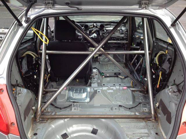

 Old 06-03-2013, 07:22 AM   #56
Cage is finally starting to resemble cage... No idea why it is attaching upside down.
Edit: Fixed the upside down pictures. The driver's seat bracket has three holes so the seat will be "adjustable" -- that is, you unbolt it, move a notch, bolt it down.... The passenger's seat bracket has only one hole so the seating position will be fixed.

 Old 06-03-2013, 07:42 AM   #57
Sturdy cage didn't even dent the roof when you flipped t over to button up!

When your done please weigh the car so those that are going to do some of these weight reductions can see where they might end up.. Good job and keep up the good work..
Will definitely do. I am still waiting for my custom coilovers and I will need the new weight for accurate and optimal spring rate calculation.
Originally Posted by chuckms6 View Post
If you are adding a cage you could go the extra mile and weld in a single cross brace in the trunk and remove those braces and maybe some material if you haven't already
Yeah, I was thinking about something like this, my welder said it was possible.
Sent from my SAMSUNG-SGH-I727
When I was over there checking out @Code Monkey;'s setup, I spoke with the cage builder about this specific matter. One solutions we discussed was a dual purpose rear bulkhead that would function as the braces. I think this would be an ideal solution as it would provide bracing in essentially all directions (in-plane).
Something kinda like this:

 Old 06-04-2013, 11:11 AM   #66
Todd98SE's Avatar
Location: El Cajon, CA.
Posts: 1,077   (View Stats)
Thanks: 1,323
That plate would block his down tubes from the top of the main hoop to the rear strut towers.
Like this:
Like this:
BTW that cage is WAY more intricate than what he is getting. His down tubes don't cross (I don't believe they do at least). And he doesn't have the 6 way cross behind his seat either.

The down tubes can be either crossed or parallel, we chose parallel. We are still undecided on whether we will run diagonal bars there.
The main hoop will have a crossbar and at least one diagonal bar going from the driver's side down to the passenger's side, but I will probably have both diagonal bars making it a 6-way cross.
Like this:
What car is that cage in?

 Old 06-04-2013, 01:11 PM   #73
Todd98SE's Avatar
Thanks: 1,323
-Derrick
I don't want to derail Code Monkey's thread but it is my old Sentra SE-R.
SE-R Photos by todd98se | Photobucket
It was a fairly overbuilt NASA/SCCA spec cage, maybe Code can get some ideas from the pics.
@Code Monkey; what city are you in? Near Austin?
-Derrick
Demolition Derby Car? :LOL:
Yeah, but I think that is still very different from the photo, right? In the picture, they braced the harness bar (not sure if that is the right term) with an additional X to the main hoop. Essentially making a six point star within the hoop. It looks like serious overkill to me.
Not a problem, always eager to learn! I am in Bryan/College Station, about 90 minutes away from Austin.
Just got a response from Sam:
"Definitely single diagonal brace and harness bar within the main hoop (to make it NASA legal). The X in the main hoop makes the harness bar more complex, but it can be done. You don't need any more bracing to be legal but I was going to do an X on the same plane as the ground from the main hoop to the rear supports. The door bar will hit the hoop at the same point which adds strength to both. If you want a diagonal or X in the rear supports, I can do that in place if the horizontal support. It will cut down on rear visibility and add a little weight, those are the only downsides. I will also be adding 1.5" tubing gussets in 4 spots."
Todd98SE (06-04-2013)

I think the single bar should be sturdy if done right. We ran the bar for the harnesses in to make the X.
Yes, I think this is much more similar to @Code Monkey;s setup
