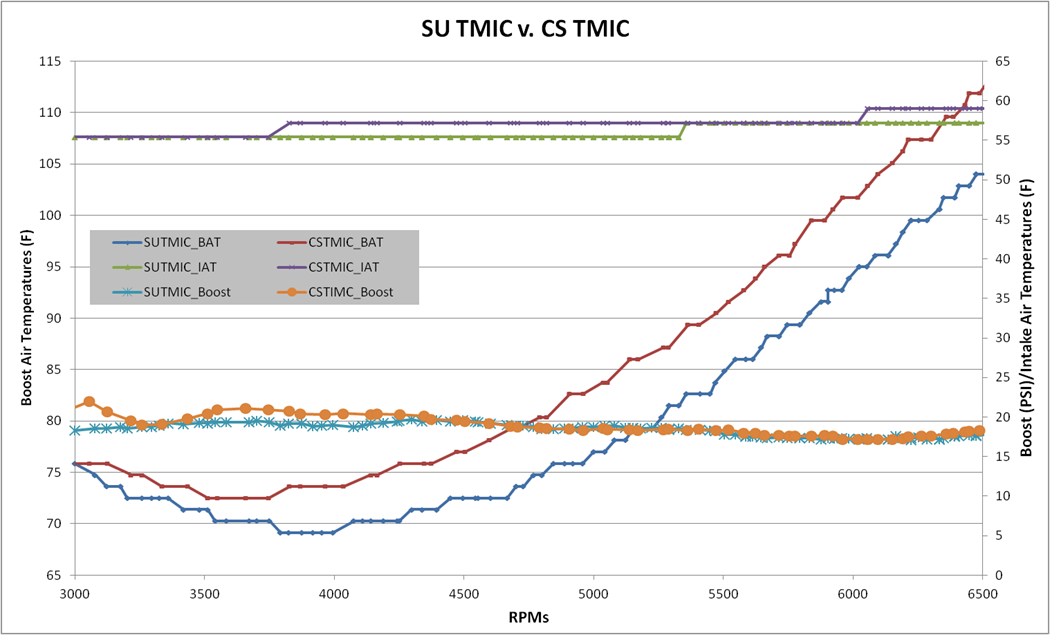

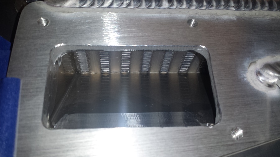

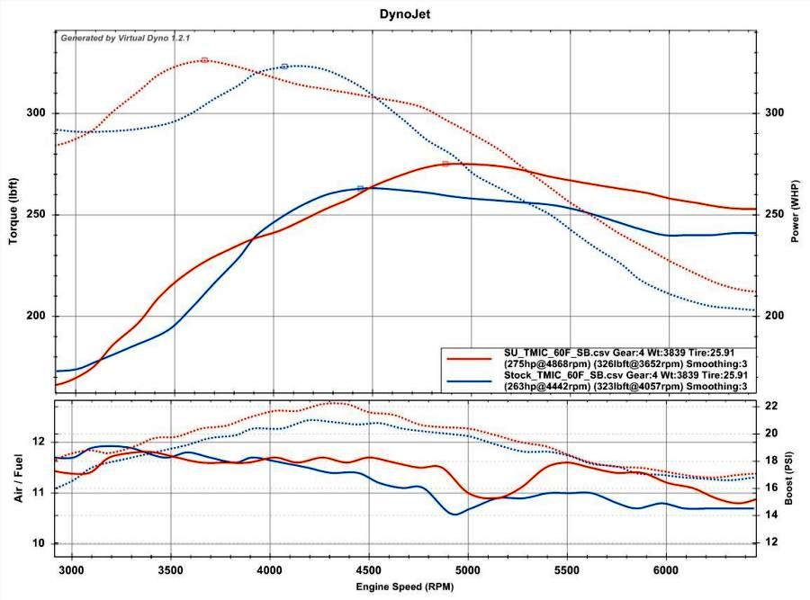

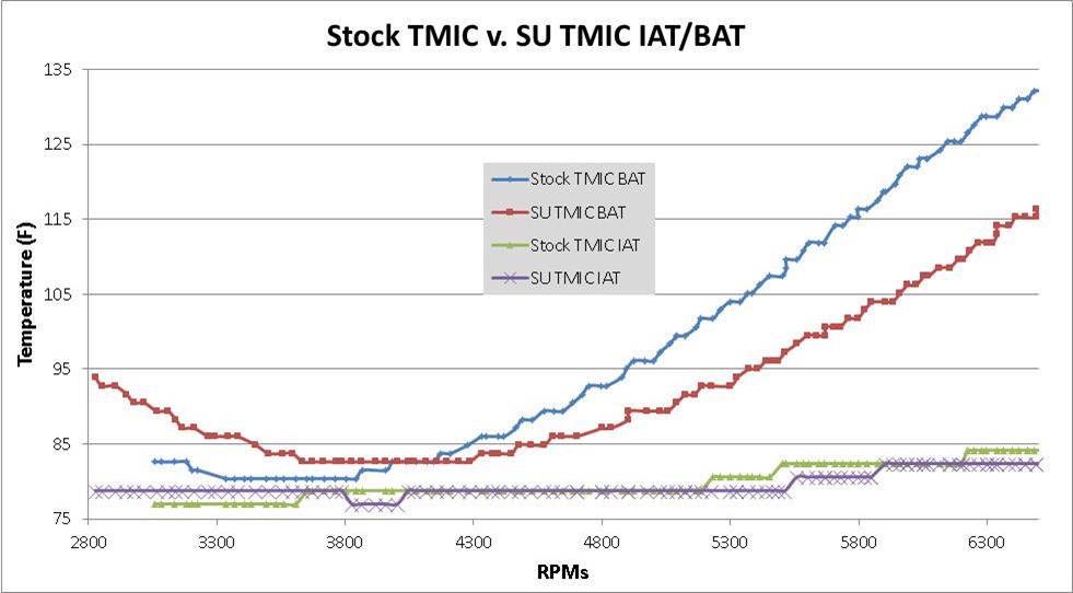

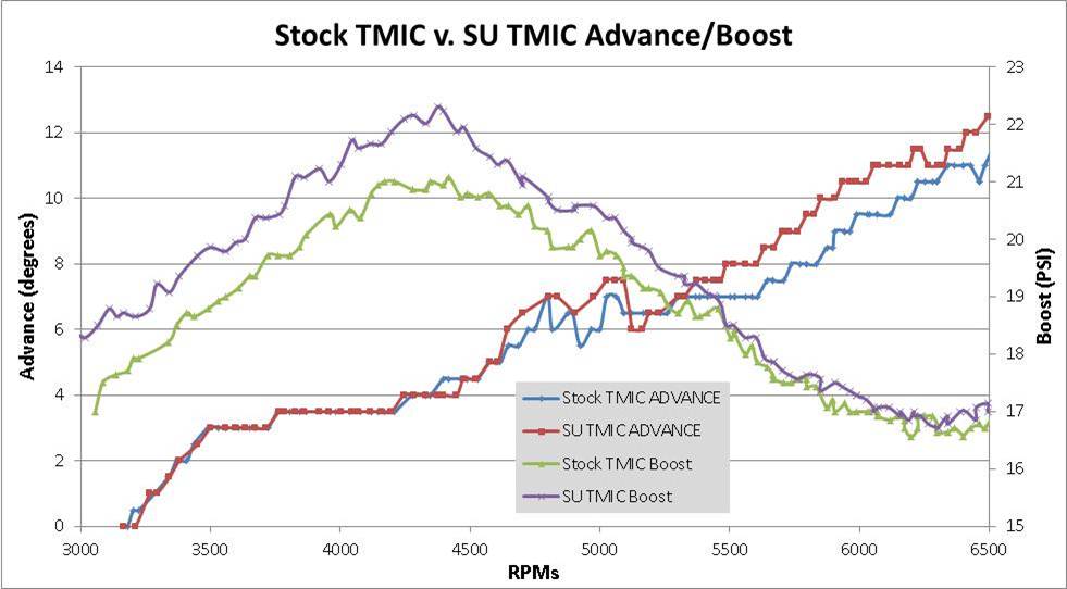

Ok, here is my official Street Unit TMIC v. STOCK TMIC results. The Street Unit TMIC did provide solid gains for my car. The gains are pretty clear and quantified.
For similar intake air temps (shown in the table below), the SU TMIC keeps BATs at bay down much better to redline, by 10-15 degrees from 4500RPMs on. These cooler temps are a little more dense and allow the car to hold a little more timing which gives a nice performance boost from 4500RPMs on. I observed +12 HP from 4700RPM to redline with the Street Unit TMIC over the stock TMIC.
This also provides a good understanding of what an aftermarket TMIC does and what it doesn't. As you can see, the SU TMIC doesn't impact low end torque really at all and it shouldn't be expected to. Nor does the SU TMIC necessarily reduce BATs when cruising on the highway or partially hitting the throttle to pass a car. The SU TMIC (like all other aftermarket TMICs) is meant to better cool the air when a large volume of air is passing through the unit. Otherwise, at lower air volumes, the TMIC doesn't cool any better then stock. As a matter of fact, you can see that the Stock TMIC ran cooler BATs up to about 4k RPMs. The stock TMIC is more efficient at a lower air volume. Interesting, right?
So, to summarize, what an aftermarket, and in this case SU TMIC does:
Reduces BATs under WOT from 4k to redline
Holds higher boost
Looks cool
Cooler air gives power gains and allows for more timing above ~4500
What an aftermarket, i.e. SU TMIC does NOT do:
Cooler BATs at idle
Cooler BATs at partial throttle
Cooler BATs below 4k RPMs
Prevent heat soak at idle
These are things that I learned screwing with intercoolers over the last 8 months or so. I hope this information is helpful. I will soon be posting a SU TMIC v. my CX Racing FMIC comparo soon too. That one is kind of a mind fuck. Hint: they work the same.

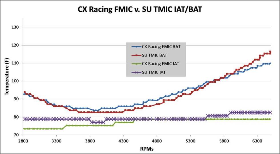

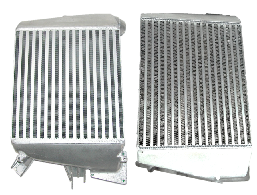

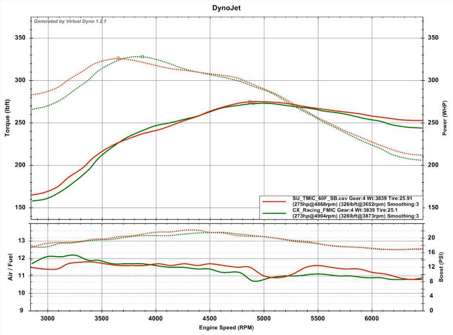

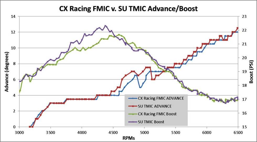

Here is the CX Racing FMIC v. my SU TMIC results. For their part, they pretty much performed the same. The CX Racing FMIC showed slightly lower BATs at redline by 5 degrees or so, but the IATs were also about 5 degrees lower, so I think that is about a wash.
The SU TMIC held a little higher boost and timing was equivalent. VD logs showed similar power between the two intercoolers. If you consider that amount of work and hacking that it takes to install a FMIC and some of the headaches, which in my case is difficulty accessing the headlight door, loss of a little throttle response, higher coolant temps, constantly checking like 10 hose clamps and other small nits, the TMIC is a hands down win for me.
The only thing the FMIC did much better than my TMIC which is indisputable to me, is do a much better job at minimizing heat soak.

I'm with you, for my needs, a quality TMIC is hands down a winner for me over a FMIC. Constantly checking clamps, having to relocate the washer reservoir, and all the excess clutter all killed it for me and I haven't missed my FMIC for a second since I replaced it with my ETS.

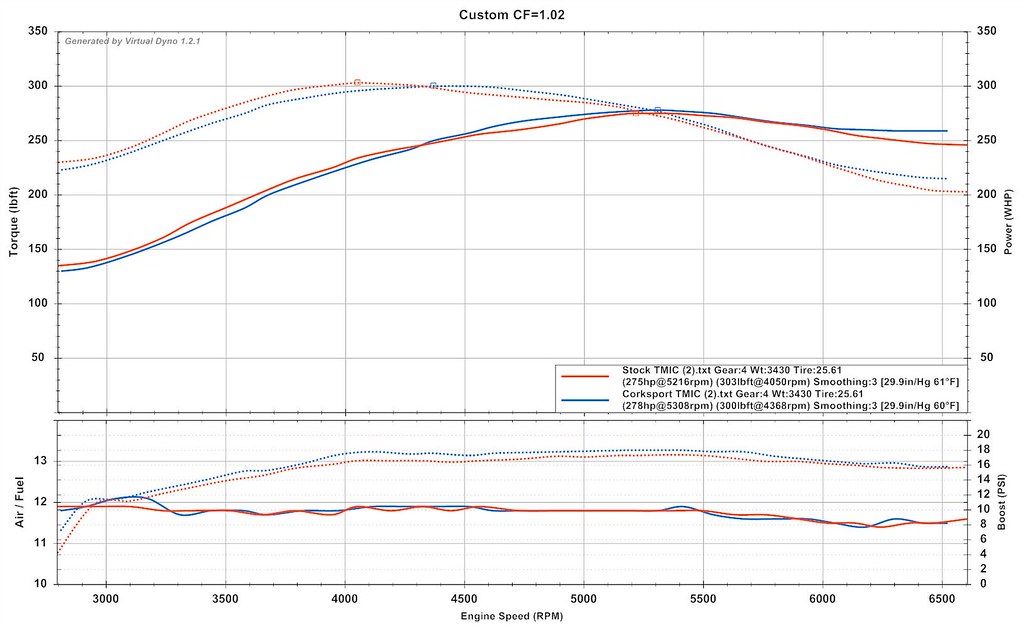

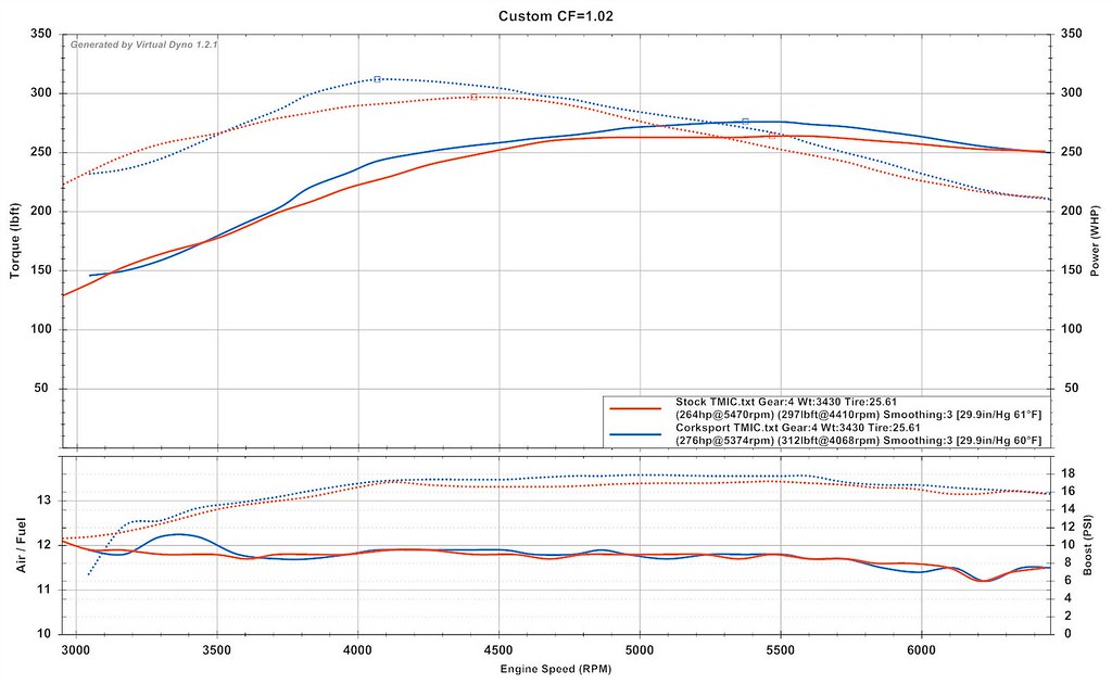

So here are two different Virtual Dynos showing the Stock TMIC vs Corksport TMIC. I attached the logs at the bottom. I can't say how much of a difference it really made in HP/TQ, due to them being virtual dynos, but you can see I picked up about 1-2PSI of boost.

One thing missing from your logs is intake air temps. Do you log those? Those come in handy when baselining datalogs from different runs.

I stacked up some data from your logs. There is one thing I am seeing here; Either you ran logs in higher outside temperatures when the Corksport TMIC was on vs. the stock TMIC or the Corksport doesn't cool BATs any better then stock... No reduction in BATs = no cooler air = no increase in timing = basically no power gains. Were your logs run in the same conditions, same outside temps?

One night was 60 degrees and the other was 61. It was on the same stretch of road as well. I noticed that too though. I'm not sure why they didn't drop. It may have been more heat soaked to begin with or something, unfortunately I didn't log IATs.

Here's an interesting data piece.
I ran the SU TMIC for a few months (pre SU drama) and due to some fitment issues of that TMIC on my car, I sent the SU TMIC back to SU for analysis/repair. I decided to go ahead and pick up a CS TMIC in the meantime. I figured I would get test data, and depending on which TMIC performed better, I would sell the other when the repaired SU TMIC comes back. Aftermarket TMICs are not hard to sell and don't devalue much (of course that was pre-SU/SURE drama).
I will say that the CS TMIC is aesthetically much more pleasing when the stock shroud is on. The fit is also very good; I didn't have any of the mechanical fitment issues I had with the SU TMIC. The SU TMIC is a little uglier and in my case, the fitment wasn't very good which I am expecting to get remedied by SU. In the end, it comes down to how does the TMIC perform, and I was in a rare position to do an apples to apples performance comparison that I wanted to share.
Both TMICs flowed the same as measured by airflow readings and equally held boost. Both TMICs are superior to the stock TMIC in this capacity. Both TMICs did a pretty equal job of shedding heat soak although I think the SU TMIC shed heat soak a little faster.
The key takeaway here is in the IAT v. BAT between intercoolers. I had a suspicion that the SU TMIC ran cooler and was better at shedding temps in around town driving. I finally got a chance to stack logs and my suspicion was confirmed. The SU TMIC pulled BATs lower and held them lower by 5-7 degrees F through the entire pull, when IATs were the same (within 2 degrees).
I can say with some level of confidence, that based on this quantified data point and my empirical experience that the SU TMIC does a better job at cooling than the CS TMIC.
What does the lower BATs mean exactly for performance? I don't exactly know what 5-7F in lower BATs mean for our cars. It could be in the noise as far as I know. I'll let the experts discuss that.

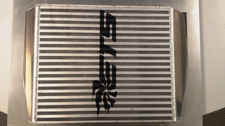

Good news bitches. Just got an ETS TMIC. I'm going to say, the thing is visually impressive. What I noticed first is how dense this thing is, both in terms of bars and fin density. It's much more dense than the SU or CS. For example, on a SU, I can see my hand through the cooling fins. On this guy, the fins are so dense and staggered that I can't see the other side. This has 19 flow channels and 19 rows of fins. The Corksport has 15 flow channels and 17 rows of fins, the SU 16/18.
Here's the CS and SU TMICs (CS left, SU right).
Here's the ETS. You can see how instead of the fins bent in a z pattern, the fins are squared and much tighter.
Now it's tough to say how it translates; but the fin/bar density is a very notable difference compared to the other 2. It's also a .25" taller core. My gut says it will cool better than the other two under boost and probably have a little more trouble shedding heat soak. Flow will probably be about the same, maybe a bit better, who knows.
Expect SU vs. ETS data in the next couple of days.

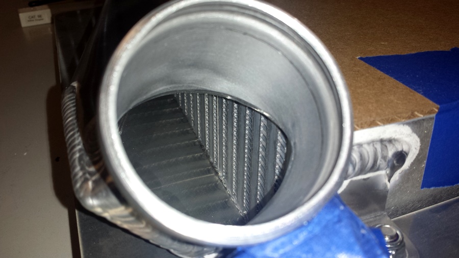

Here's the ETS inlet and outlet; small details like chamferred and stuff. This thing shows a great attention to detail from an assembly perspective.

I don't know that a more dense fin arrangement is better. Seems like that would restrict air flow through the core, especially on a thicker core. This would result in not as effecient cooling on the bootom side of the core, which is the side more prone to heat soak. There needs to be a balance between density and thikness for propper air flow and cooling.
I am an engineer with exposure to heat exchangers and thermal transfer and I still don't know what is going to happen; not even enough to hypothesize. There are too many variables - boost air temperature, outside air temperature, ambient temperature, core density, airflow, airflow evenness through the core, core pressure drop, radiant heat from turbo, hot spots, conductive heat transfer, airflow through the fins, heat distribution, internal core friction, turbulence, intercooler hood seal, etc.
