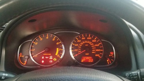

Hi guys I finished my build last week but my car won't start. Car cranks but won't catch all the way and start. Only codes I'm getting are P2138 for accelerator position voltage and the EGR code (It's deleted). When I hold the gas and start it the car catches more but it dies and smells like fuel out the back like the cylinders are getting flooded with fuel. Car has a newly built block and I received a tune from Will at PD. I've checked all grounds, swapped the engine harness, inspected and cleaned all electrical connections, checked under dash by PCM and no problems were found. I've already swapped the pedal and no change. HPFP is a CPE unit that was cleaned and resealed before swap and injectors were sent out to Deatschworks for cleaning/flow testing and no problems were found. Throttle body is a brand new corksport throttle body. Any ideas on what else to check? (Click on link for vid)
20190815_194632
