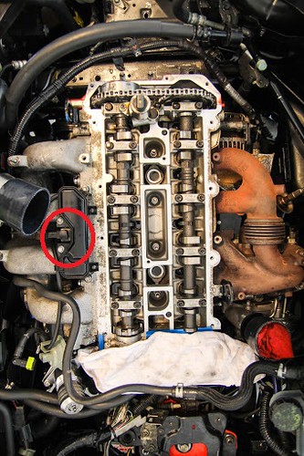

Default I have searched and cannot figure out what this is or
why it isn't hooked up on my 2008 CX-7? The object in the red ring?

According to Jim Ellis mazda it's a solenoid valve number LF1518741. I still cannot find the wiring on my car.

Small black plug. Should be in with your coil harness if I'm not mistaken

Doesn't that system control your VTCS? And wouldn't you be throwing a code with it not actuating?
And as stated...small black plug coming out of the coil pack harness.
yes indeedily doodily

That's really strange you're not throwing a code. But the valve cover is also off so it's not running to throw a code lol.
It's not my engine. I just searched for a picture online. It could be throwing a code. The PO busted out the LED on the board for the CEL. I have to find another dash cluster. I bought it with the VCTS unplugged. I removed the TMIC and noticed it, looked for plug and didn't see one and reinstalled the intercooler. I will look wants all the VVT parts arrive and I start removing parts.
Thanks everyone, i appreciate you help.
