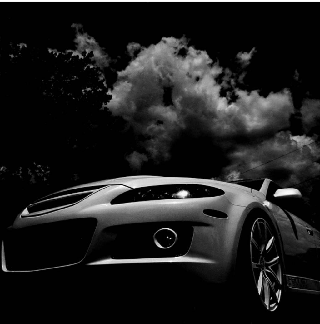

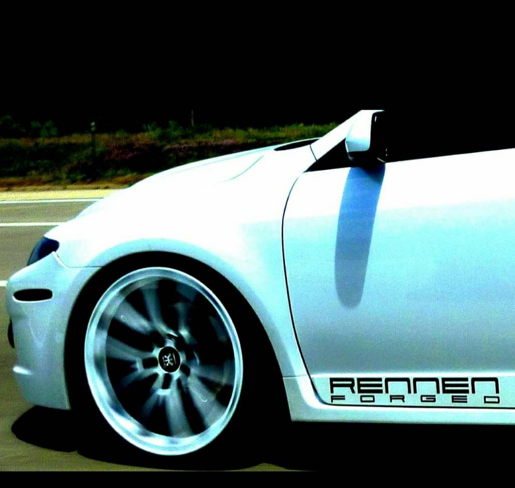

I'm running 20x9s with a +42 offset. Dead nuts flush with the fenders.
I did roll the rears for a nice and safe fitment.

Or you could save a S (*T ton of money and just buy my car turnkey haha!
The cleanest MS6 on the planet...
Fully built, Full-Race EFR 7163, and it makes over 400 AWHP on a 93/E85 blend... Over 500 if you went with AUX fueling.
No expenses spared.

You want to sell it now?!?! lol My bad 20's not 19's -- even better lol
