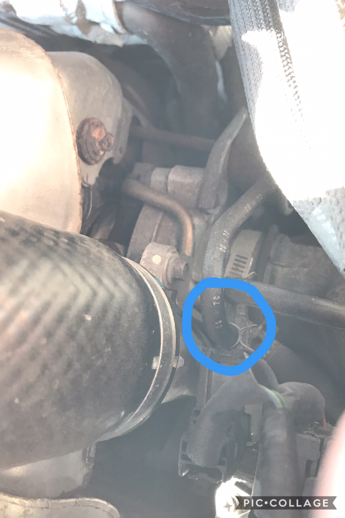

Was driving into work today and my CEL came on. Popped my Hood when I got to work and noticed my intake filter box had popped open, all 4 latches were undone. I'm assuming that's what caused the CEL. I don't have a scanner or accessport yet to read the code.
Also, when I get on the throttle hard it's kind rough when accelerating. It feels like it's almost sputtering, lots of small but major torque dips. I assume that the fuel pump is the reason, it feels like it can't keep up and it's leaning out. I live very close to sea level, Hudson Valley area of upstate NY. That and the previous owner only ran 87, I filled it for the first time today and put 93 in it. I filled it about 1/4 mile from work so I didn't have a chance to actually get on it and see what difference it made. Anyone with any input on the troubles I'm having? Tomorrow morning I'll actually get to test my CEL theory, which I'm 99.9% sure was the intake box throwing what most likely was a vacuum leak code.

I would bet Intake Box is your issue.

Intake box was the issue that's all good now.

Update- so got home from work and decided to clean my MAF, and I'm glad I did. It was coated in a thick layer of black sludge.
Also, decided to check vacuum lines. Glad I did too. A line connected to the turbo inlet pipe had popped off. Wondering if that was the cause of my CEL. When I drive to work tonight I guess I'll find out...
The blue circle is the line that was disconnected

That's the EBCS recirc line.
You had a vacuum leak all the time & boost leak when the EBCS is activated.

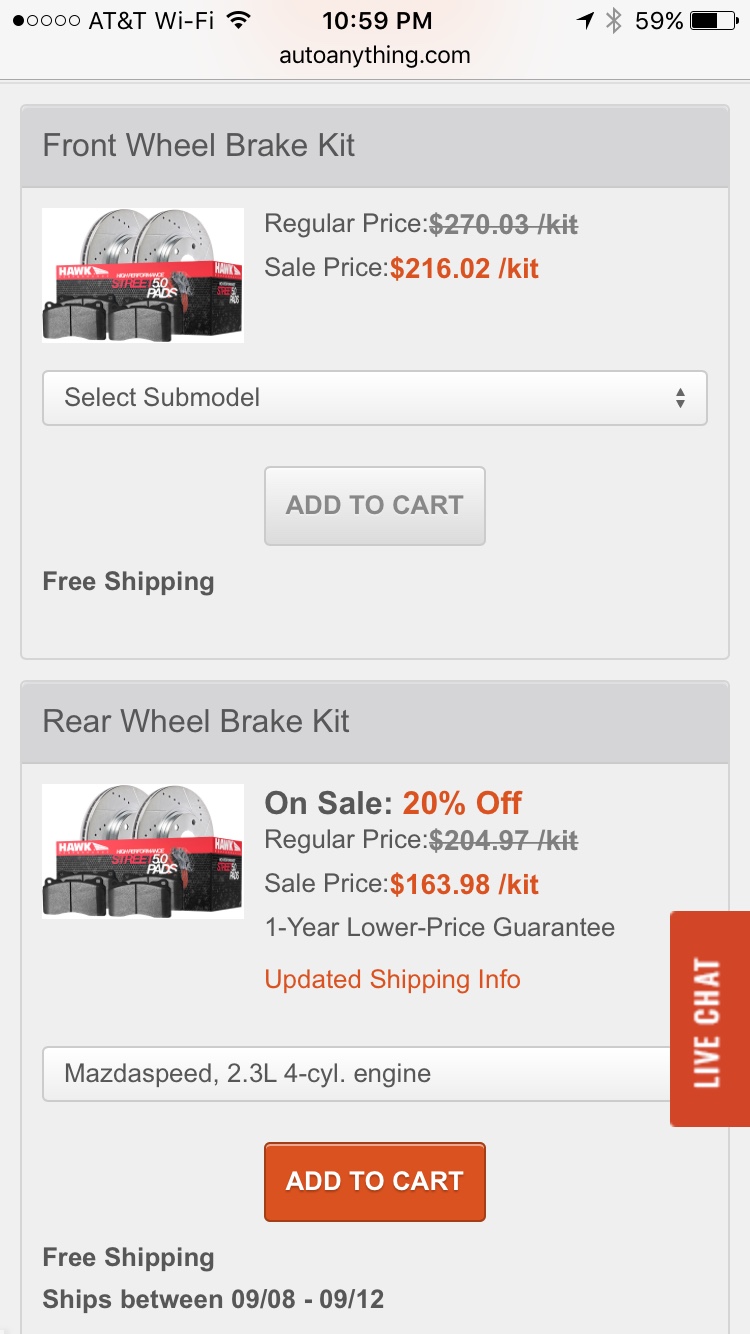

Check fluids daily to bi-daily as a habit, they are all good, oil change was done 500 miles ago with Mobil1 synthetic.
Will need rear rotors and pads soon calipers are all good, what do you recommend for a pad/rotor upgrade?
Interior is in very very very good shape, gonna give the leather a good washing and treatment this weekend as well, and give the whole exterior a good wash as well.

I've only had to replace the rear pads once since I got my 6. I put in Power Stop Z23 Evolution Sport from Rock Auto. The only down side was after bedding, I would get brake squeal like they were race brakes or something, but that has since gone away. I intend to install the Z23's in the front when it's time. Since the rears don't typically do much work, I can't speak to their performance or effectiveness.
As far as rotors, stick to the basics. No slots, no crossdrilled.
I'm certain there is a thread that covers nearly every available pad/rotor for 3's and 6's.

Yeah I found one. Everyone seems to swear by the Hawk kit, rear pads and rotors for $163 on anything auto seems like a decent deal to me. They let off a lot less dust then stock too. Slotted and cross drilled rotors though.
