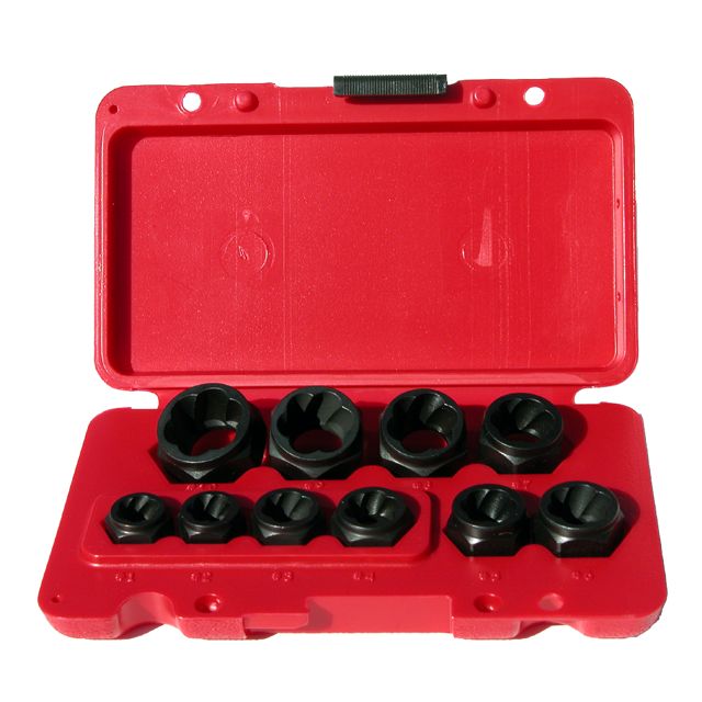

Any ideas? vice grip didnt work , i thought about cutting the head off with a dremel but you really cant fit much in that space. i have a feeling if i could get that off things would go a bit smoother.

if its for sure rounded you could try to jam one size smaller sockey onto it... bolt will need replaced after its out tho

same thing happened to me. head to sears...
^^^THIS^^^

thats what i figured. my first thought was cut the beast off with tin snips, then realized it wont cut through that. bolt out sets will fit back there? i really hate the insane amount of heat shields and bolts in there haha.
well, off to sears to get me a set and go to town on it. thanks for the advice everyone.

^^^^ughh srry for my lack of tool know-how but what are those
That, a hacksaw or sawzall

they are magic sockets. they are used to remove rounded or otherwise destroyed heads that sockets wont get on. also a good way to save a smaller socket if your route is to hammer one on there

tis true i wasnt even thinking about a bolt out set. im use to just using what i have

my destructive ways turned to the hacksaw. tight area meant a no-go ! oh well. all the frustration building up will be gone instantly when i finally get the dp and cbe in there
