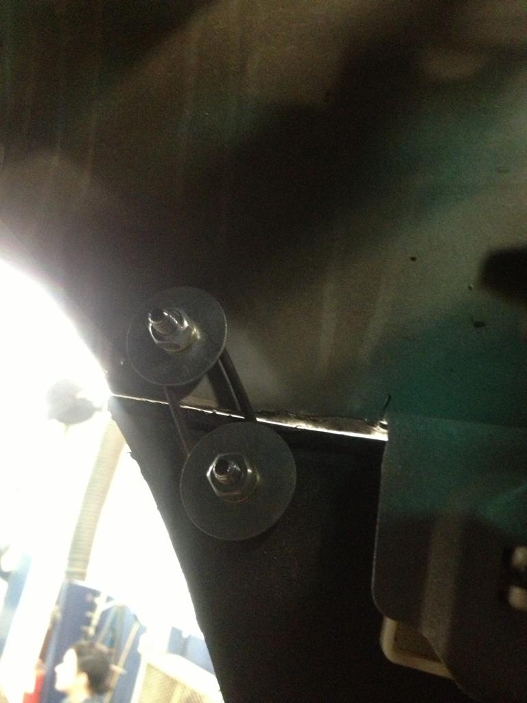

My bumper is too far gone for zip ties and cables, so I cannot do it. I am not gonna use the big Dzus, but the mini quick latches, then vinyl wrap them or plasti-dip. Not sure yet.

yeah if the slots are ripped out then you do have a choice to drill more holes in that lip where there is still bumper material but then you will need to alter the OE bracket to allow room for the rivet/sleeve and wire combo to clear.
The smaller the external fastener the better and it would be a quick off/on but I can't get past the ascetics. because racecar
interested to see your final product.

I'm going to try your fix this weekend, my bumper is still salvageable. I'll probably shoot you a PM or two at some point if I have any questions.

I did a zip-tie thing before, and drilled holes for it. This go-around. I want to be able to take the bumper off if I need/want to. The Dzus option was the first thought, until I saw the mini-latches.
I will update post#1 to show I am not using them.
yeah the mini latches look nicer...now body color would be the bomb but it would likely be hard to get the paint to stay on.

Yeah, would probaby need to be vinyl covered in a color close to body. I am honstly thinking I might just do a flat black plasti-dip, will see how they look when on.

If you remove the stock bracket you may be able to thread ball studs into the existing holes and use the quick latch without fabbing a bracket. The ms6 only has one bolt for the bracket though, but the bracket might be able to be left in place as well.

If you plan on taking off the bumper without jacking it up or turning the wheels, how do you intend on attaching the fender liners and undertrays?

My fender liners are messed up from rubbing with the wheels. I zip tied the remaining peice of the fender liner and undertray to the bumper.

All I am using is the factory clips and screws. I do have 2 sided 3M tape up front for the sides, as the little torpedo clips are not wide enough for hellafunctional. The finished piece will be out of plexi, aluminum, or humpback whale flesh.

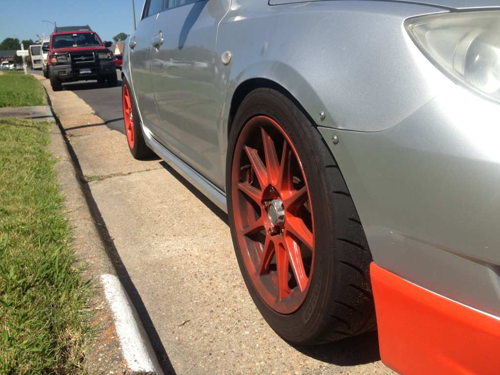

damn totally forgot to post pics of mine... one minute.
Excuse my dirty ass car, busted looking fender/bumper, and ugly fucking orange lip.

Mine are fucked up top too. As long as I dont pull the Zip Ties to tight the bumper doesnt pop out at all (used to have o-rings but they broke)
