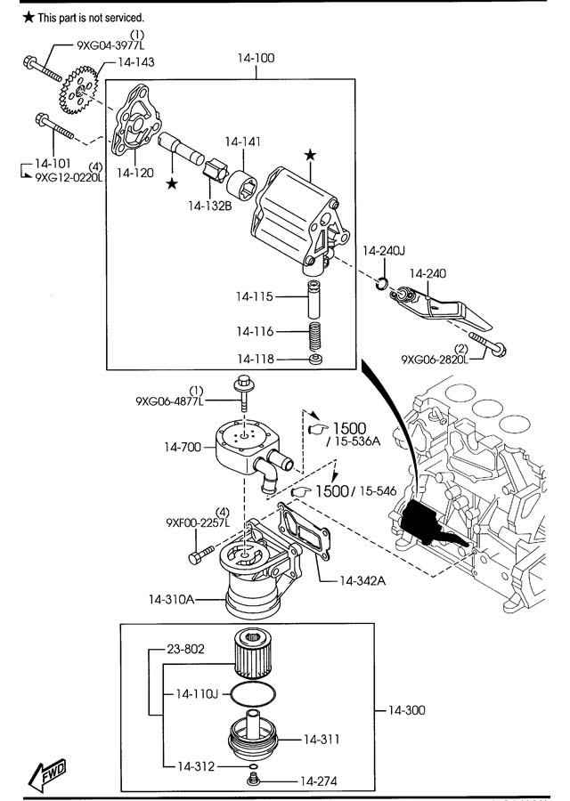

So, I am a dumb and last oil change I stripped the bolt for the plastic oil filter cap. (Image relevant to bolt)
I'm pretty sure I can get it back off, but I need a replacement and can't find it online anywhere. I'd prefer not to order directly through a dealership if I can save some money online. I found them once right after it happened, but didn't have the cash to order it.
If anyone knows where I can get the bolt or the whole assembly I'd appreciate it.

https://onlinemazdaparts.com/parts/2...gramCallOut=18
#18 ?

N/A from them. You may have to order the whole thing listed as 14-300 here to get it, because it's not listed separately on JimEllis Mazda's website:
ASSEMBLY, COVER OIL FILTER. 2006 Mazda MazdaSpeed6 # L32114300A9U

Just do the spin on filter conversion and start using traditional oil filters before that plastic piece of shit cracks and your engine goes bye bye.
Probably be cheaper than buying stock parts to fix it.
Mazda OEM Spin-On Conversion Kit MS3 MS6

U dont have to unscrew that screw just unscrew the whole black housing to change the filter

I have 106k miles on my car and am still using the cartridge type. I've never unscrewed that piece.

Yea, just unscrew main filter housing and tip it to a side to spill extra oil out. That screw is just to make it easier to drain and not make a mess!

The bolt on mine is striped too just unscrew the filter cap like usual, just gonna be extra messy is all.

I just had the problem of the stripped out drainage bolt. The above comments are correct. It does not attache the filter housing, it merely acts as a drain for the filter housing.
Try channel lock/slip joint/tongue and groove pliers to spin off the plastic filter housing. Be gentle and it works fine.
