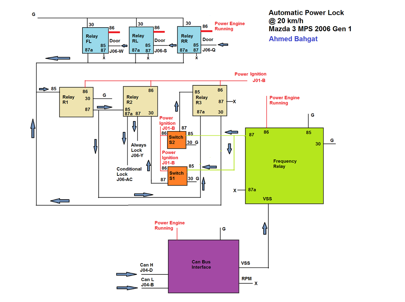

Hello all
Sorry for the delay, been flat out and still, this is the final design I came up with and it works exactly as German cars, I have a Golf R 2018 and an Audi 1.8T 2015, both have the auto power lock system @ 20 km/h, so I studied how they work and came up with a design for my Mazda that works exactly like them, I will explain every part of the harness in the video when I record it pretty soon
Cheers
