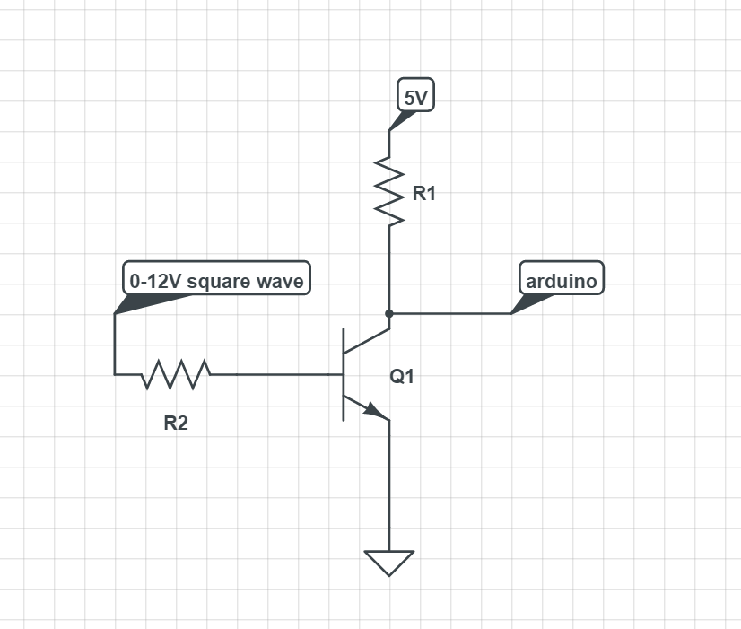

i would not tap into any sensor without an isolator. i installed a high feature w/m controller on my 2007 that was looking for RPM signal pulses. I taped into #1 coil trigger signal. IT worked 10sec and then the coil smoked with a blown fuse...Fortunately ECM wasn't hurt...
I bet the controller was adding a capacitive load into the circuit that overloaded the coil or something like that.....
I just installed an isolator that i made myself with a transistor in between and hourra!
https://i.stack.imgur.com/INUEl.png
ABS sensors are just a proximity sensor giving a similar signal but taping into it may affect the abs controler the same way (or may not but i wouldn't take the risk...)
The other option may be to fit a second abs sensor into the hub by drilling a second hole etc and keep that one only for the added device......but i didn't look at it to confirm it is something possible. i just say it as a feed for tough....

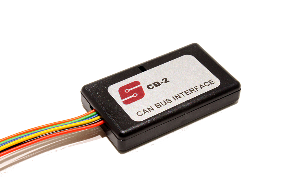

you can use this maybe
CAN Bus Speed Pulse Interface | CANNECT PULSE

That is more expensive than the one the bought and it only exposes the vss, the one i bought made in the uk and exposes vss and rpm
Cheers

You are right mate, that is why I wll not tap into anyting other than the can bus

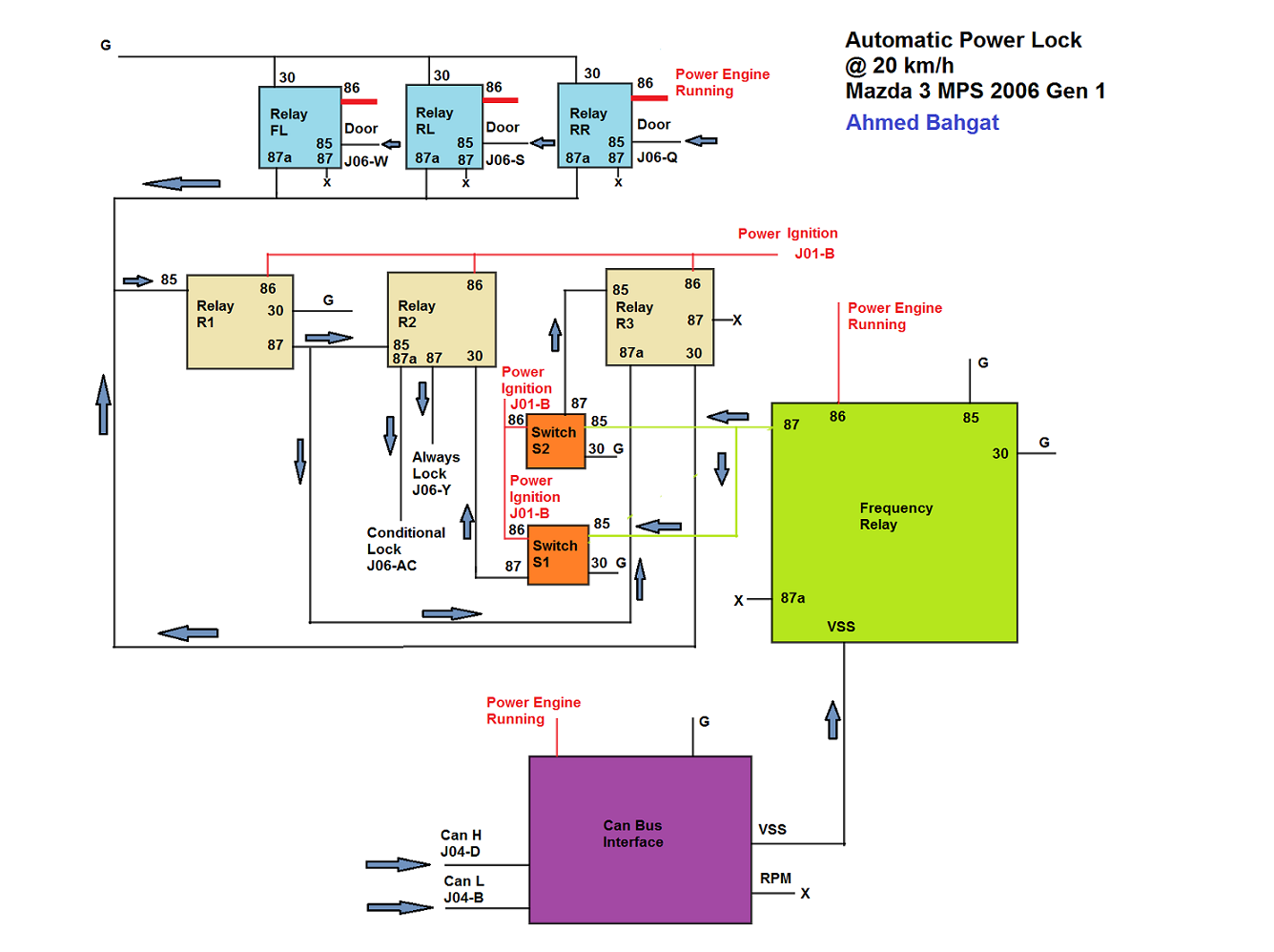

What I am trying to do guys is simply, not that simple, to lock the doors when the car reaches 20 km/h, and if i drop a passenger and frive again the passenger door should lock again when the car reaches 20 km/h

They have models that give 2-3-6- or even 15 signals including some about door latches too...For the price i didn't compared to value of the 2 different money type...
Yes mate, the price goes up by the number of data you want it exposed from the can bus, it can be up to 400 bucks

Hello all
Sorry for the delay, been flat out and still, this is the final design I came up with and it works exactly as German cars, I have a Golf R 2018 and an Audi 1.8T 2015, both have the auto power lock system @ 20 km/h, so I studied how they work and came up with a design for my Mazda that works exactly like them, I will explain every part of the harness in the video when I record it pretty soon
Cheers
