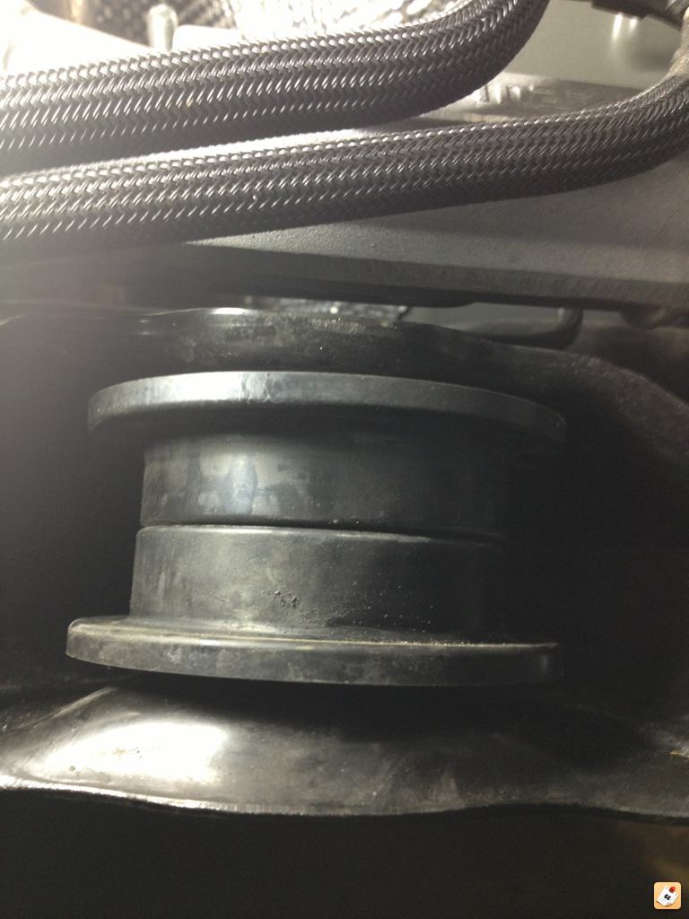

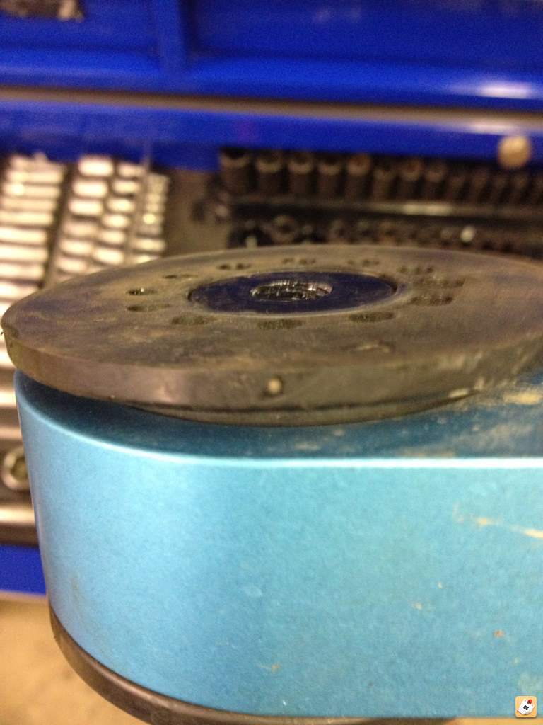

He had a problem with the outer bushing of the Cobb RMM pushing upwards, out of the mount. He posted more detailed pictures than I have, and probably a better description. He also has been in touch with @Evan@COBB, I will let him explain his experience.
After reading his post on a whim, I decided to inspect the RMM while doing an oil change today. The pictures attached show what I saw. Seemingly the same issue. It looks like the outer bushing is pushing upwards. I have noticed an increased vibration at low RPM, similar to what it felt like for the first 50 miles or so. Shifts are also a bit jerkier, but all of that is just by feel.
I drive my car hard. All the time. If I'm not, it's because I'm in bumper to bumper traffic. It also has gotten colder here recently. 30-20's daily now. The mount is only a few months old. It's seen alot of daily abuse, and I'd bet close to 100 full on pulls, as @rfinkle2 can attest to. But I don't think this is regular wear, or ideal.
According to @darkstar5440, @Evan@COBB said that this was the first he heard of it out of 850+ units sold. Apparently Evan also made it sound like this was not a failure or a problem.
Just today I sent a pm to Evan, so I do not expect to have gotten a response yet, or expect him to address it until Monday.
Here is the question to MSF. Looking at pictures from both myself and @darkstar5440, does this look like a problem or failure? Am I imagining a difference in vibrations and shift feel? And most importantly, is anyone else running this RMM seeing the same performance? Does anyone have any input or thoughts?

Just to be clear, you guys are experiencing the inner bushing (circled red) dislodging or shifting out of place correct?

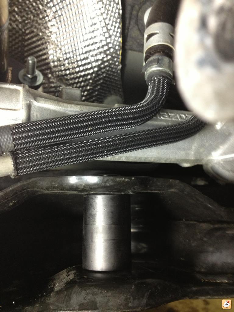

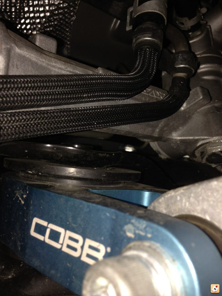

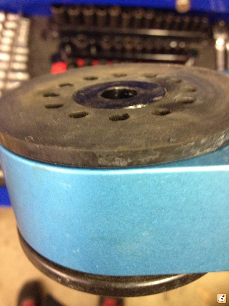

No, the center pin which is some sort of metal fits tight in the subframe. The center pin is actually longer and sticks out past the bushings. I am experiencing the top bushing sliding out of the mount and pinning itself against the top of the subframe housing.
Center pin by itself snug in the housing
Center pin installed in the bushing without mount inside the housing
What the mount looked like last time I took it out

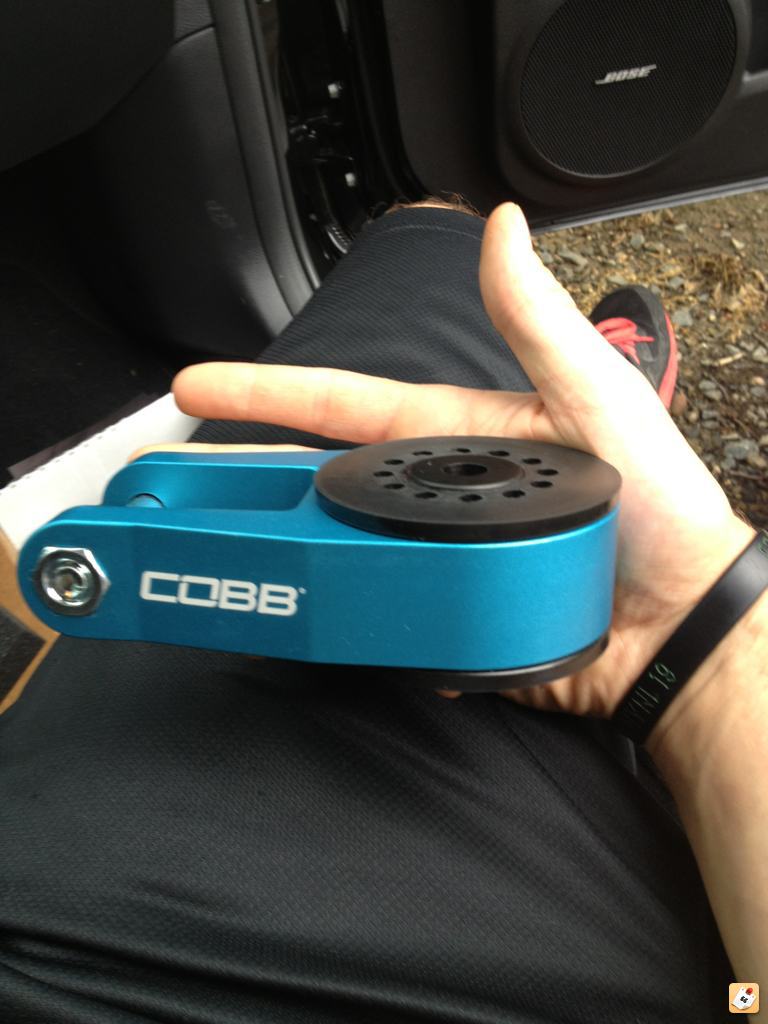

What she looked like fresh out the box, as you can see the pin sits a cunt hair higher than the bushing
Also this is what the bottom of the mount looked like when I took it out

Thanks for clarifying. So there is actually two separate bushings? A top and a bottom halve? Just trying to understand this design.
Correct
That's your issue it seems. That pin is creating just enough of a void as to allow the (possibly shrunken by cold) bushings to not sandwich snugly in the subframe and it eventually works itself out. IMO

Welp....
Went to change out my oil with some fresh T6 today....And took your advice.
While i was under there, i took a quick look at my COBB RMM today, and sure as shit... The top of the mount is lifted off the surface and sitting pretty high. I didnt snap any photo's, but to give you an idea, i could probably put 2 quarters stacked on top of each other into the gap between the mount itself, and the top bushing. Maybe even 3.
Now what to do
*Edit ... I would say ive got about close to 7,000 miles on this mount.

 Old 04-01-2014, 11:45 AM   #27
@x09MS3GT, contact @Evan@COBB.
That is about the size gap that I saw. Here a few pictures from the day I swapped the mounts.
As for the new mount, I checked this weekend during an oil change and the bushing was still in place. The vibrations have gotten slightly harsher than the first couple miles, but still better than the failed mount.

 Old 04-01-2014, 03:04 PM   #29
Originally Posted by x09MS3GT View Post
Roger that man, i just PM'd him and well see where it goes from there.
*Edit .. BTW , those pics of yours, looks exactly like mine.
Let us know what plays out man. I was told only 3-4 people, including @darkstar5440 and myself had experienced this issue. I'm curious if other failures are going unnoticed or if this is an anomaly and we just happened to be the unlucky ones.

@Evan@COBB; @WetzMS3;
Here are the pics as requested...
Quite dirty in there.....
4 years of Alaska will do that.
