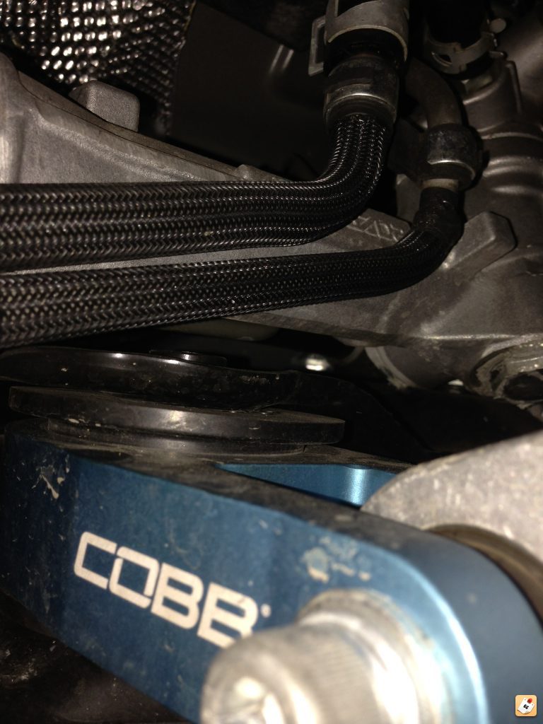

Originally Posted by moonrider_99 View Post
@COBB: I got my COBB RMM in the mail today and I wonder if it's not damaged (or I'm retarded, or both). I can't screw in the large bolt into the recessed nut all the way. I can maybe get it 25% in. Is this normal? It seems like something is not aligned properly. Threads look ok.
Thats as tight as i could get with my hands but its all the way through
Hey there @moonrider_99;
Could you screw the bolt in with the mount out of the car? I suppose there is a possibility that the nut was pressed in a bit crooked. Usually you can straighten it out by torquing the bolt down to draw the nut in straight.
If it wont' do that, let me know via PM and I'll get a new mount out to you ASAP.
So sorry for the issue!
Edit: Sorry! I thought I was logged in with my Evan@COBB account. Please send a PM to Evan@COBB if you can't get the nut drawn in straight. If it won't, I'll throw the bad mount at the warehouse clerk's head for screwing it up!
Thank you for the follow up. I did not try to torque it because I did not want to ruin the threads. Here are the pics. The strange thing is that from the "opposite/wrong" side it goes through the nut no problem so it looks like either the nut or the other hole is not aligned when bolt is inserted the correct way.
Won't go more than this, barely catching the nut on the other side.
Can't see very well but the bolt is barely in
Uploaded with ImageShack.us
Screw it directly into the bolt from the opposite side, no problemo.

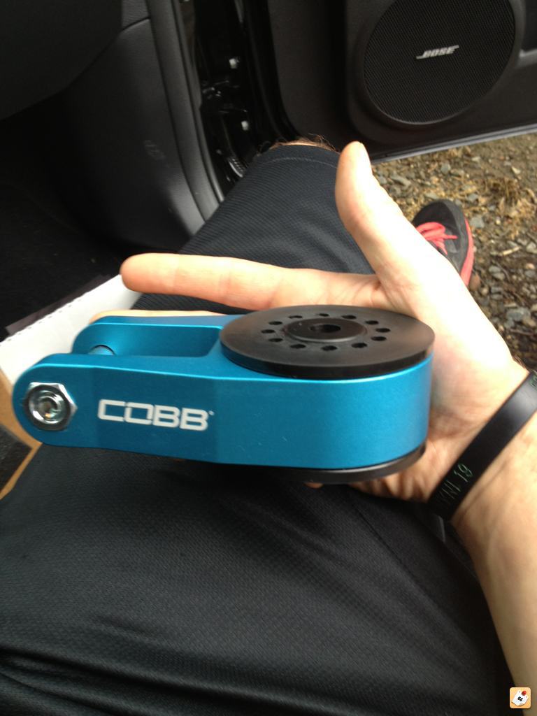

Sorry to revive a somewhat old thread. But has anyone had problems with the top bushing seperating from the mount? It happened to me about a month ago after a few hard launches at the drag strip. I took it out smacked the bushing back into the mount flush and reinstalled. I was under my car last night and noticed it seperated again. I got about 8,500 miles on the mount and I got a heavy foot. Ive torqued the mount to 75ftlbs and used blue loctite.
Can you snap me a picture? How far is it separated? The mount should be sandwiched in the subframe so I'm thinking the amount is very small? Thanks!

I just took it out and smacked it flush again, it seems like the center piece is raised a tad higher than the outer bushing and it works its way out

So is this normal @Evan@COBB; ?

This is the first I've seen a vehicle that has that kind of room for it to dislodge like that. Let me see it tomorrow when I'm back at a computer.

The center bushing is taller than the outer bushing. The center bushing fits snug when I slide the mount into the subframe, after I drive the car the outer bushing seems to work it's way out to the height of the center bushing. I would think both bushings should be the same height? @Evan@COBB;
I'm going to take it out again tomorrow and take a look at it, something is def wrong...this shouldnt be happening. Hopefully its a faulty part and not my subframe fucked up.

Although this is what it looked like when I first got it and the center bushing is taller than the outer one so something went wrong...like I said I'm gonna take it out again tomorrow and investigate

I did an oil change amoung other things today and decided to take a look at my Cobb RMM. I have the same issue it looks like. I didn't remove it, so the pictures are kinda shitty.
It has also been fairly cold here lately. I have also notice more vibrations than a month or two ago.
Is there any word on a resolution or the cause of this?
@Evan@COBB?

Well that's comforting knowing I'm not the only one this has happened to. I'm debating wether or not I should make the switch to jbr. Cobbs customer service has always been outstanding, I have to say that.
@Evan@COBB; what are your thoughts on the bushing wearing out prematurely?
You're not the only one @darkstar5440. And thanks for addressing it here. I may not have paid much attention to it without your heads up. I really liked the mount until a few weeks ago when it got rougher in some conditions, and this likely happened. I am hoping we got bad apples, and this will not be a common issue. But I'm not sure where my confidence in that is yet.
I know John, @Chuthor, runs the same mount, in similar weather to me. I'd be curious if he has taken a look at his recently and seen any issues. I do drive it really aggressively, and it's seen a lot of pulls in the few months its been in.
Any word from Cobb about a resolution? I'm not sure if it's better to run this mount like this, or the stock until I replace it, and I would rather not have to buy a new one.

Me and @Evan@COBB; have exchanged several private messages. I had supplied him with detailed pictures of the mount installed, disassembled, just the pin in the subframe housing, and the pin with the bushings in the housing. My pin fits nice and snug there def is no excessive room like he thought there was.
He told me out of the 850+ mounts they have sold I am the only person to have this problem and he has never seen anything like it. He told me he thinks it doesn't interfere with the way the mount was designed to work, even though the top bushing has become dislodged significantly. He asked for my thoughts and I am curious if the mount will fail later on down the road. He also offered me a full refund and no exchange he seems to think mine is not defective.....I have yet to hear back from him

Interesting. I sent him a pm before that last post.
I have noticed a difference in feel. So it is not working the way it was intended to, or did for a few months prior in the very least.
I'm glad to hear that so many have been sold with so few issues. I would prefer to run this mount over a rougher similar preforming mount.
Maybe others with the mount can check theirs and chime in. If the separation is as rare as it sounds, seems like our mounts are failing, or will fail.

I would imagine we can't be the only ones, I'm always checking over everything on my car. I first noticed it in October after like 20 pulls at the drag strip. On one of the pulls I had a rough launch and popped the hood, assuming my intercooler hit the hood and popped it.
That prompted me to jack the car up the next day and check everything out. That's when I noticed the mount dislodged. I smacked it back flushed and thought nothing of it. I got back underneath the car about a month later and it was dislodged again. That's when I brought this issue to cobbs attention. I once again pulled it out and smacked it flush, drove it for a day and got underneath the car again to find out it dislodged yet again within a very short period of time. I also drive my shit wreckless on a daily basis
Although its very hard for me to say I've noticed a difference in drive ability since I really have no clue when the mount initially dislodged itself.
