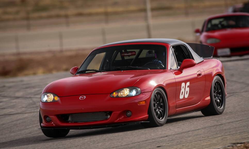

Ive been doing more HPDE events lately. How mine sits as of now

How do you like the Blackbird spoiler?
I absolutely love it. Definitely a great mod to add when you get your mechanical grip sorted out. I knocked two seconds off my personal best at the local track and a second off at Streets of Willow. I'm sure I would have dropped more time at SoW if I wasn't running that super high angle of attack on the spoiler. Was around 48°. Should have been at 30°. But for low speed stuff like autox, it still helps out.
