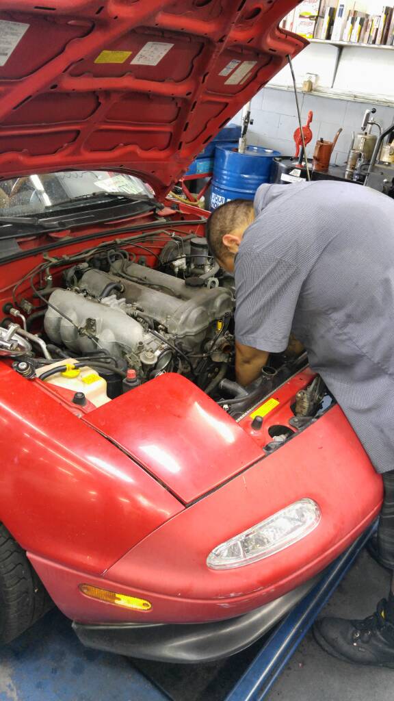

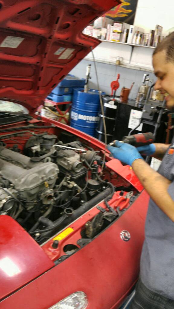

The next issue that i noticed was on the drive home from the purchase was the brakes needed to be replaced. Ended up getting some rotors and pads for all 4 corners and installed them with the help of @SpankyCuervo; on a warm saturday morning. Lol
Edit: thank you spanky. Fyi he was quick ro spot the previous owner has used RED locktite on the caliper bolts. Thankfully he had some solutions for that.
Sent from my LGLS991 using Tapatalk

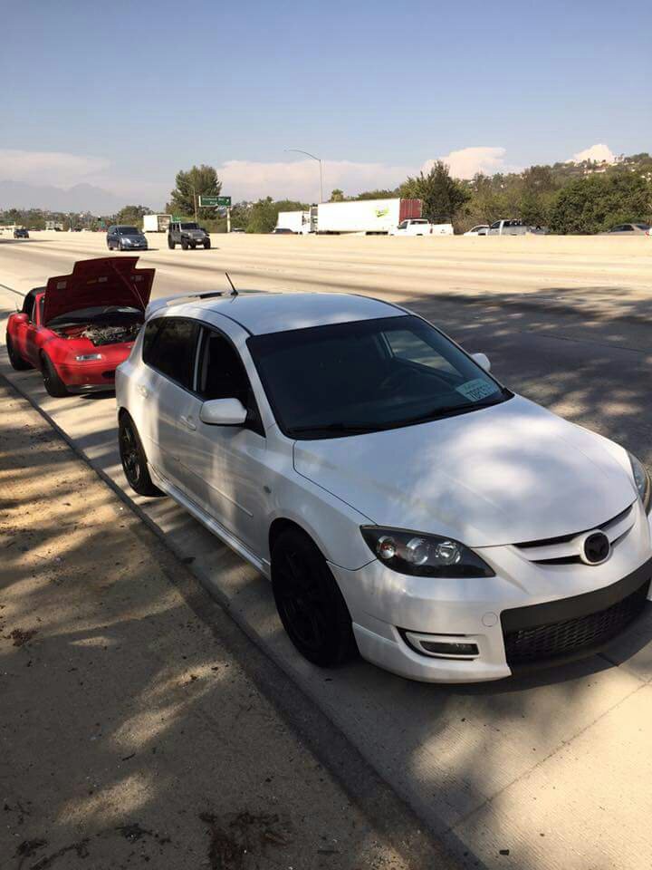

The horrors continued a week later with the car overheating on the way home from work. Lucky for me @organic_714; was driving next to me on our way home (we work together) and he helped me with getting the car off the road and home safely. Before that we removed the thermostat housing to find that the previous owner had removed the thermostat. We drove to the closest part store and purchased a new thermostat, gasket and temp sensor since the one on there was broken off when removing the housing.

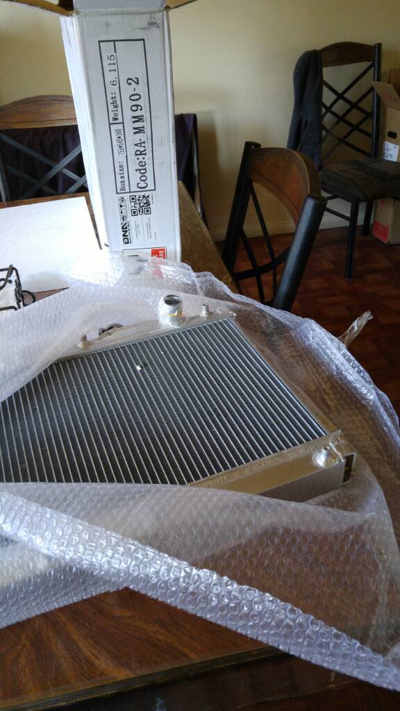

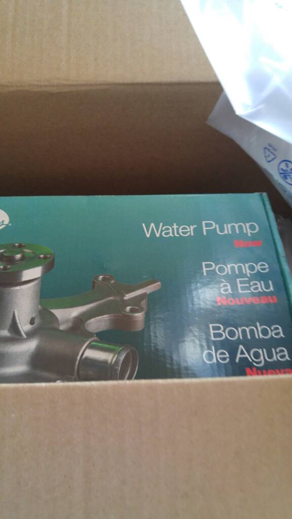

Temps ended up staying at bay for a couple of minutes after the install so we had to keep pulling over. The car would overheat when driving on the highway but streets were fine.
Once home i checked all hoses and the radiator and noticed that coolant was not circulating. Idk if you remember @SpankyCuervo; but we had heard a whine coming from the drivers side when the brakes were done so my guess was water pump took a shit or the pulley.
Ordered a new water pump and gaskets from Gates on Amazon. Also ordered a new aluminum radiator from speed daddy just cuz.
