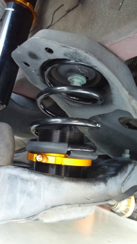

Is this how the rear springs should sit? Or does the adjustable part go on top?

Yes. I didn't think it's possible to mount it different.

Gotcha. Just wanted to double check. Also, any guidance on how much to adjust the height via the shock? I haven't put the car back together yet but halfway seems to be far too low.

Run the rear gold ring twice the hight on the rear from what you got in the pic. This will be closer to the height your looking for.
If the rear gold ring is run to the top but to where the last coil is flush to the top of the last of the black thereads on the spring purch this would be closest to stock height.
That will be center hub to fender well at 14".
After 1-2K miles on the springs it will settle dowwn 1/2-1". Thats front and back springs on setteling down.
I set the shock at stock length in reference to the stock shock and the spring and perch to the top as described above to get the same 14" I started with before ISC install.
UTube has videos on other brands coilover on this set up worth looking in to.

Appreciate the help, I'll do that. I have koni yellows, so I'll just match my shocks to those for reference.
