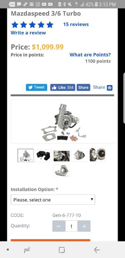

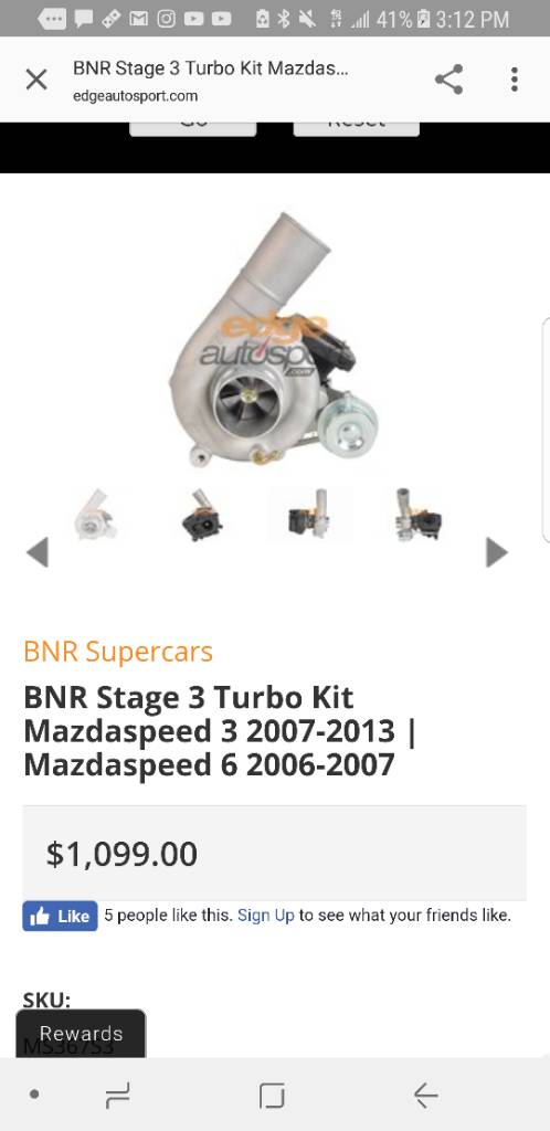

Which one do you guys think is better ?

They are both good but if you're looking to get to 400 go with the s4 or other larger turbo. Either way will take a bunch of supporting mods
