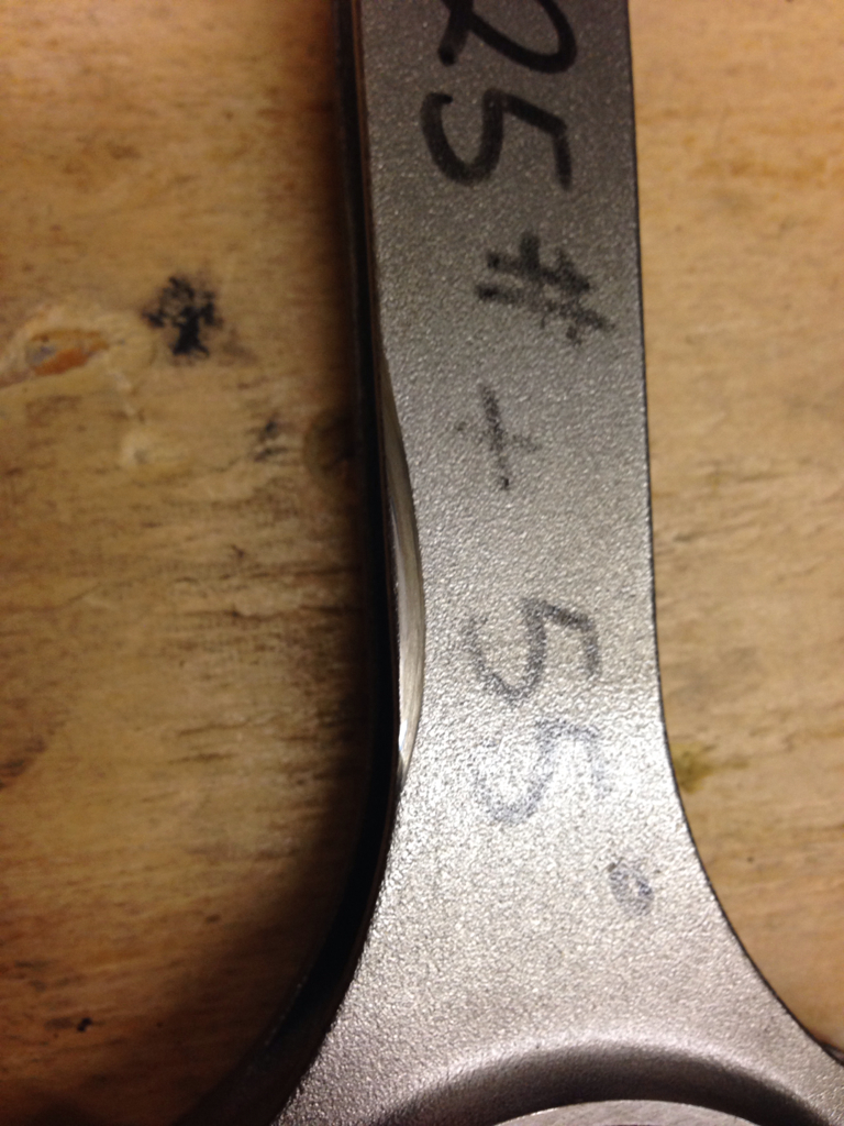

Did you check the rods for circular marks from the squirters?
Yes, can't find anything noticeable.
I lied

Wow. That's not even subtle.
Actually hard to see, took me a couple look overs. I got the light just right on the picture so it seems like it is unnoticeable. Hardly any martial gone.
You can barely feel it when you run your finger on it.
It was cylinder 1 rod btw.

All the squirters were shaved though right?
Yes but cylinder 1 more then any other, I can't find any other marks like the one shown and I'm sure they would all be in or around the same spot on each rod.

Weird, I would think there would be something more noticeable on each one since they were all hitting.

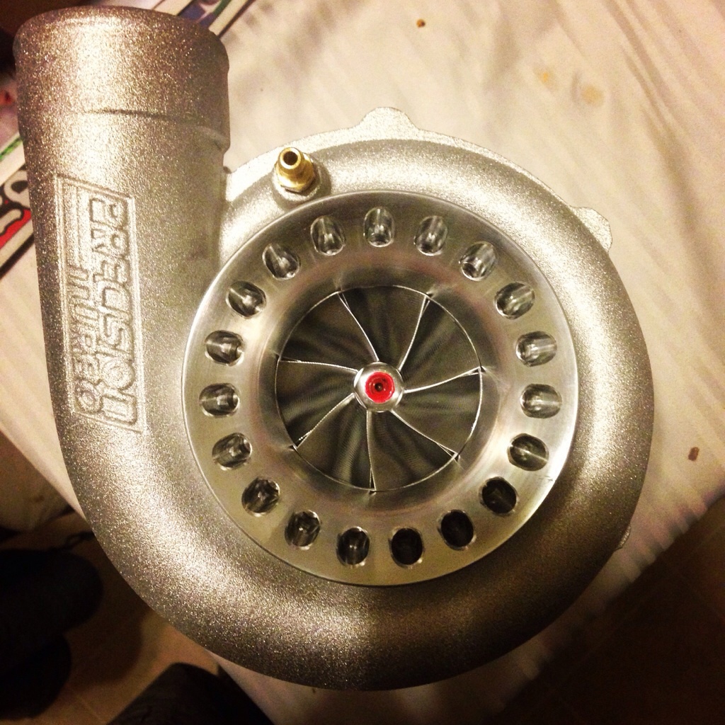

One of the most beautiful compressor wheels in the world, that's for sure. Man I'm so pumped that somebody else is finally gonna be running this turbo.

Which precision is that? 6466 or 6266?
 Old 12-18-2013, 09:28 AM   #115
Realgib3's Avatar
Location: Cleveland, OH
Posts: 2,443   (View Stats)
Rep Power: 3292
Thanks: 5,280
6466, the 62 compressor wheel is much different looking.

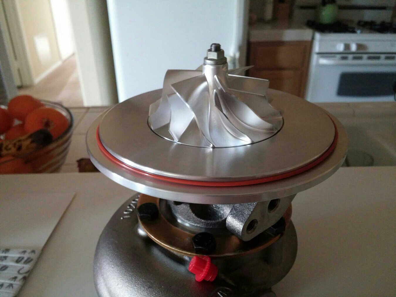

 Old 12-18-2013, 09:31 AM   #116
LumberJack's Avatar
Posts: 2,580
Rep Power: 2724
Thanks: 3,896
Groans: 57
What looks so different? This is my 6266.

Default Papasmurf Round #2
The one I posted and he posted are 6466's, isn't the 6466 have the 7 blades on the intake side instead of 6? Or is that just the CEA's?
Wellll aside from different shaped blades than the 64... and having 6 blades instead of 7 on the 64...
