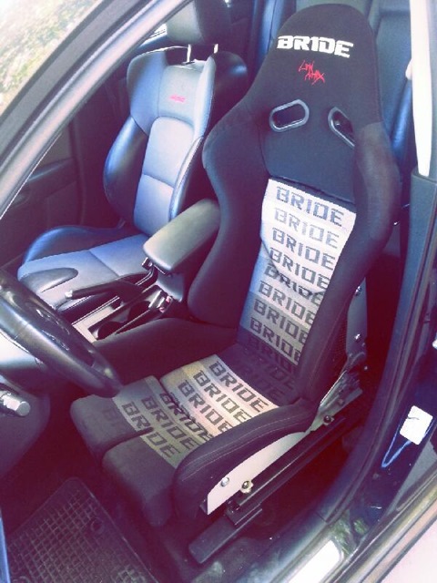

in love with my bride low max

Nice seat! Ever get those internals?
