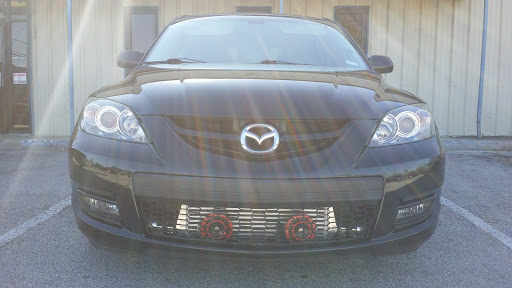

Hello all,
I just wanted to make a thread for keeping track of what all has and is going to be done to my car.
I just bought my car last month and so far I love it. I picked it up for $3,100 with 172,000 miles on it, driving all the way from Texas to Florida to pick it up. Fun road trip by the way!

2017-08-07 - rear motor mount $116.80
2017-08-13 - Turbo Inlet Hose $48.19
2017-08-15 - Black Shift knob $9.79
2017-08-19 - Cold Air intake + filter $37.99
2017-08-21 - "Carbon fiber" short antenna $9.99
2017-08-21 - Greddy type s Flange & blocking Plug $30.00
2017-08-21 - Rockauto EGR valve $166.78
2017-08-23 - Keyless remote FOB $19.49
2017-08-27 - 10pcs Mazda emblem 4 key $3.55
2017-08-27 - domed 6 speed shift decal $8.99
2017-08-27 - Front Mount Intercooler $307.80
2017-08-27 - Keyless Remote FOB $11.99
2017-08-27 - Knock off Hella Horns $11.75
2017-08-27 - Replacement key $1.14
2017-08-27 - Turbo Timer Silver $19.99
2017-09-12 - Star Tron Fuel Treatment $27.90
2017-09-12 Mazdaspeed Forums VIP $25.00
2017-09-13 - Edge Autosport Fuel pump internals $349.96
2017-09-13 - Freaktune Accessport +2 tunes $825.00
2017-09-14 - CorkSport downpipe withCAT $632.75
2017-09-14 - Greddy type RS recirculation adapter $12.99
2017-09-14 - 4x NGK Iridium IX Plug Spark Plugs $27.37
Total Spent? --- $2,705.21

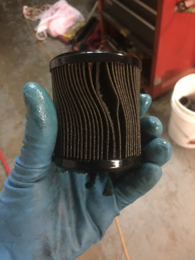

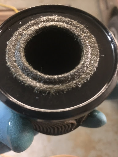

First oil change looks like this... :/

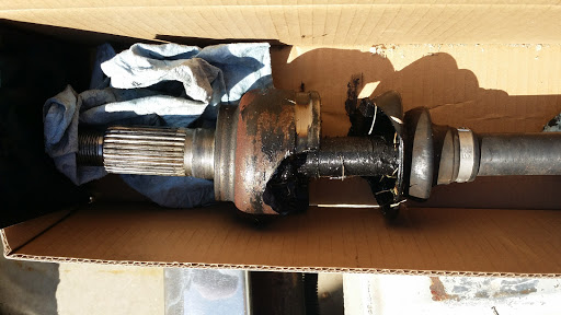

Great.
I called up the previous owner and he told me he always took it to Firestone. The plastic cap was hard to take off so they probably were afraid to break it and just changed the oil and left the filter because the oil looked ok.

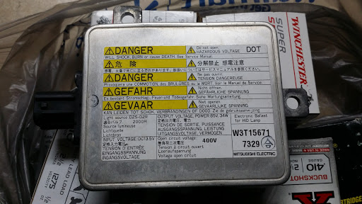

My passenger side headlight was leaking and looks like it fried the ballast. I have the new one in from ebay and I'm out $30. Which is much better than $400 from the dealer. I haven't installed it yet so who knows it might not even work. lol I got a good feeling that it will though.

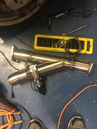

The parts I needed for my 3" exhaust cutout are in so it is time to start welding stuff!

I was showing a friend the car and Busted an axle when I was doing donuts. wow.
My cousin and I already replaced it. But It has been a crazy adventure....

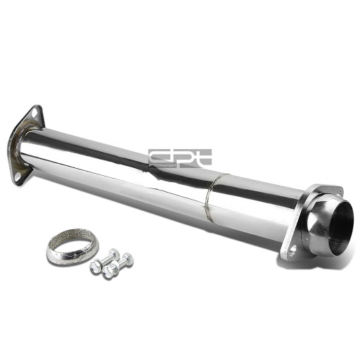

Ebay parts FTL!!
It made my stock pipe fail right on the weld. I guess that second flex joint was important LOL
FOR 07-13 MAZDASPEED3 MPS STAINLESS STEEL TURBO EXHAUST TEST CAT PIPE DOWNPIPE
Sold by dptmotorsport
https://www.ebay.com/itm/401429885508
I had to go back and forth with them a bit but they decided to refund my money. I used that to buy a flex pipe and got a local shop to install it.
I don't have the boost response I had with the open DP, but my car no longer gives me head aches lol
Can't wait to install the exhaust cut out and only be loud while racing or when messing with people
Edit:

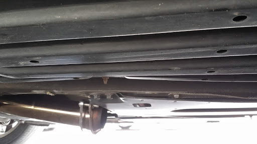

So I was looking around at other stuff and noticed that the Ebay test pipes look almost exactly like the name brand ones, So it's a design flaw in most of them or my exhaust just wasn't welded well from the factory? Either way it has a flex pipe in there now.
I may take some pictures next time I'm under the car.

For those of you who are curious I updated an older post with a picture of the axle I broke a while a go.
I mentioned that this part burned out on me because my headlight was leaking and a heavy rainstorm came and got water inside of it.
I replaced it with this one by searching by the part # in the bottle right. That helped me find one so much cheaper and on top of that it was new.

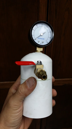

This is the boost leak tester I used to check for leaks on in my intercooler piping. cost me about $20-30 and worked great!
It would hold 25 psi for only about a 30sec to a min before leaking down. Not sure if that is normal or not.

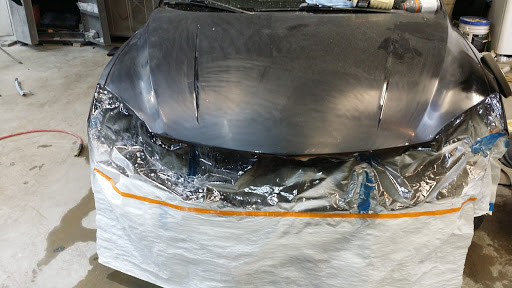

Just got my car back from the body shop yesterday, man does it look good!
No I didn't have a wreck. The car just had a lot of oxidation and rock chips so I wanted to clean that up. I had the front end and spoiler resprayed. I think it looks beautiful. If you have a car in the DFW area I would totally suggest going to them. They also paint and do body work the police cars and city vehicles here for the City of Forest Hill, and the paint job never peels or cracks.
random pictures from the body shop.

That resued oil filter looks like a spun rod bearing waiting to happen.
Actually I found out that the oil filter really does look like that after it is used. I think it was a cheap oil filter that looks so different from the wix oil filter.

Just updated my tune with one sent from Freektune. Boosts to 20psi now. I think it may be spiking. I need to look at what he set it to.
I still need to install the Corksport downpipe and exhaust cut out. That will for sure make a difference when I do some data logs.
Yes I did update Freektune with my changes so they would give me a correct tune.
on a different note I wanted to buy this.
Corksport Downpipe that replaced both CATs
but it was on back order back in september. No problem I told them. They said it would be ready in late October.
Late October came.
got an email that said something along the lines of "sorry but the downpipe is still on back order. it will be ready late november..."
REALLY??
So I told them to forget it, and send me what they have instock. So Now I have the short DP that comes off the turbo.
I haven't been able to install it yet, but I'm actually happy this happened because it works better with the plan I have.
Here is my idea that just might work.
I want to be able to pass inspection. and since the o2 housing (downpipe) is so hard to get on and of, It would be hard to put the CAT back in.
So I figured I would use the 2nd CAT instead and just extend the Wires from the 2nd o2 sensor so that it will see the exhaust after the CAT
That may have been confusing so let me say it differently. My car will have the corksport short DP and race pipe installed most of the time. Then when I need to pass inspection, I'll install the 2nd stock cat in place of the race pipe with the o2 sensor behind it so it will detect it.
Makes sense? I think it will work.

Seems like a lot of work for oil that wasn't that bad. it's not like it had sludge in it. Oil looked normal.
Remove baffles or just clean it with Baffles removed? If your suggesting removing the baffles altogether, Why?
I did, it is in the thread. I wouldn't suggest Injector RX though. I think the guy in Canada does a better job. But there are threads about this topic already.

Edited my post about my ebay test pipe adding something I've noticed.

I got with my brother on Wednesday to help him with his exhaust cut out. Basically the same job I'll be doing on the Speed3.
We will probably try to tackle it this next Thursday.
here is a picture of his, terrible welds and all but it looks like it will hold and not leak.
It's our first time welding stainless. We used stainless filler rods, but we didn't clean up the metal with Rubbing alcohol before starting.
Any welders on here want to give some advice before I do mine?
I'll try to get a better picture of the welds tonight.

I am of the believe that the MS3 exhaust flows very well after the catalytic converters.
So my advice is to leave it as it is. Suffice to say I am old and intolerant of loud noises.
If an occasional run with an open dump pipe makes you happy, go for it. It's a far better plan than permanent straight pipe.
In regards to the crack you observed on the test pipe, it is likely a welding defect. You'll notice that the stock pipe has spring loaded donut joints at each end rather than a flex joint.

I noticed a huge difference in the butt dyno. But what do I know. May be I'll get it on a dyno one day and actually test this.
I agree, I don't like it loud most of the time. It got on my nerves for the few days I drove it around with the busted dumped exhaust. I was so happy when it was fixed. It did make people more interested in racing me though so that was fun!
There was no crack on the test pipe. It caused my stock exhaust to fail. I fixed it by adding a flex pipe so it should be ok now.
darkmx-6 is offline   Reply With Quote
