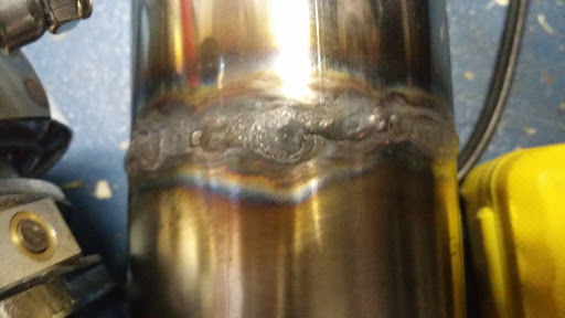

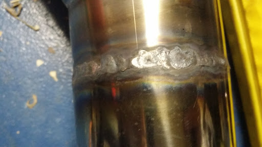

Here are some up close pictures of the ugly weld job
Any welders on here that can give some advice?
We used stainless filler and the tungsten we used was meant for stainless according to the welding shop.
