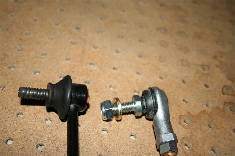

Took last weekend and installed a few parts I had laying around. First, the endlinks. Ever since I dropped the car on H&R coils the steering had become a bit numb. I was also getting a bit of noise as I would turn the wheel left or right. After talking with a few suspension gurus it was identified that the stock endlinks were causing the front sway bar to bind slightly.
As it was explained to me, the lower you drop the car the lower the front bar sits towards the ground. To compensate, you either need lower endlink brackets on the strut or longer endlinks. I opted for longer endlinks since H&R uses endlink brackets comparable to OEM. Here's a pic of the struts for comparison; OEM is on the bottom:
http://carphotos.cardomain.com/ride_...0249_large.jpg
I specifically chose Powergrid for a couple of reasons. First, the endlinks are sealed like OEM, making them less susceptible to the elements (and associated noise). Second, Saitek - a member on M3F - was running a group buy for custom length endlinks. After a few measurements I opted for a 1" longer version. Few pics below:
http://carphotos.cardomain.com/ride_...4001_large.jpg
http://carphotos.cardomain.com/ride_...4002_large.jpg
http://carphotos.cardomain.com/ride_...4004_large.jpg
http://carphotos.cardomain.com/ride_...4005_large.jpg
The verdict? WOW. The car is once again nimble and reacts crisply to every input from the wheel. Turn-in is much more responsive. And all noises associated with the sway bar are now gone. Highly recommended.

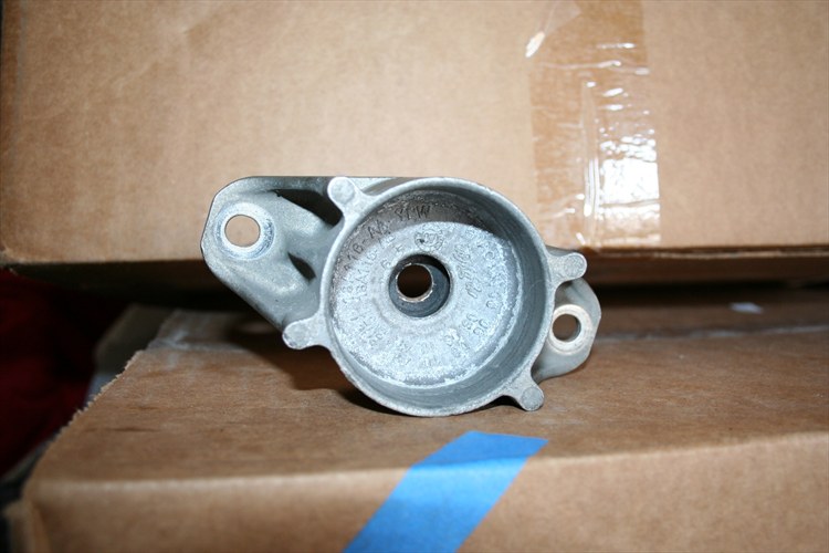

Now onto the motor mount. I had my choices narrowed down to Corksport and CPE. I elected to go with CPE because of the single piece design and testimonies from other users. IIRC, CPE makes three versions of the mount with varying levels of stiffness. There's a 60, 75, and 90 durometer. I went with the OTS version which is 75 duro. Quality and design are first rate. Beautiful piece of equipment:
http://carphotos.cardomain.com/ride_...4003_large.jpg
So how is it after 450 miles? STIFF. That's both a good thing and a bad thing. I love the performance. Love the crisp 1-2 & 2-3 shifts @ WOT. Love the wheels being planted to the ground. But I hate, HATE the vibes. Being a solid mount, you're going to hear and feel the buzzing of the motor at all RPM's. And at lower revs it resonates throughout the cabin - especially at around 900 RPM's with the AC on. Taking off from a stop occasionally feels like the flywheel is chattering. Someone else said it best; at idle it feels like a vibrating Lazy Boy on the lowest setting.
So why is my own assessment at odds with almost every other review? Well, when you do a majority of your driving with a wife and daughter blasting the AC in stop & go traffic, the vibes can get annoying quick. I've heard a few members complain about various RMM's in these types of driving conditions, so I know it's more a matter of circumstance than personal preference.
Overall I'd recommend this mount to anyone who's focused strictly on performance. It does exactly what it advertises. But if your MS3 is a DD, you might want to take a ride with someone who's already running this or a similar RMM. I know there's some additional break-in that will occur, but I unless it's drastic I expect to pawn off this mount to someone who'll use it to its full potential.

KW also requires you to use a 10mm drill bit to widen the rear OEM top mount. Few photos of the completed effort:
http://carphotos.cardomain.com/ride_...4089_large.jpg
http://carphotos.cardomain.com/ride_...4090_large.jpg

You mentioned you swapped the endlinks when you had H&Rs, but did you stick with stock on KWs or get shorter ones?
Never mind, found your thread about installing .25" shorter end links.

That is the beauty of adjustable endlinks. I'm considering raising the height just a tad and will shorten them accordingly.
