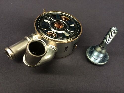

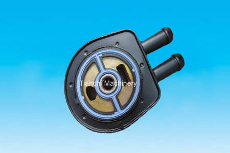

Oil Cooler Issue
I noticed a very slow leak coming from the oil cooler a few weeks ago. Turned out to be the gasket that seals the cooler and oil filter assembly together. Unfortunately, Mazda only offers this part with the oil cooler assembly. And buying a new one costs around $400 wholesale.
Somewhere along the way, Mazda recognized their mistake and redesigned the oil cooler in '08. But unfortunately for Gen 1 MS3 and MS6 owners, the original cooler "should" be replaced once the gasket fails. And that didn't sit well with me.
Fortunately, there are a couple options to service the Gen 1 Oil Cooler gasket:
- 1. Remove the rubber liner along the gasket and replace with high temp gasket sealant (i.e. Permatex Ultra Black 82180).
- 2. Purchase an aftermarket gasket from Dorman for around $30.
I chose to go with option 2, using the vendor below:
Mazda 3 5 6 CX 7 Oil Cooler Seal Gasket 14700 New Replacement Clean | eBay
There are several ways to access the oil cooler without draining anything but the oil from the filter assembly. You will need a box wrench to access the 15 mm bolt that sandwiches the cooler to the filter assembly. I chose to drain both the oil and coolant while I was there; here are the instructions I used:
- Removal: https://www.youtube.com/watch?v=s3Yx3rFnMuc
- Dis-assembly and inspection: https://www.youtube.com/watch?v=glhk_RQTH8k
- Service, reseal and re-install: https://www.youtube.com/watch?v=YO9mgpotcik
The inner ring of the aftermarket gasket is a TIGHT fit on the oil cooler. I had to sand the inner ring approximately 1/4 mm in order to fit. Otherwise the gasket seems to be holding up well. I'll report back after my next oil change.
One installation note; this method ONLY applies to Gen 1 coolers that are painted black, as per the photos below.
Gen 1:
Gen 2 with serviceable gasket:

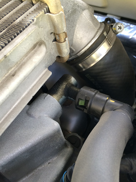

Quick update at 139K.
I am currently tracking down an oil consumption issue which has become more noticeable the last month. I cleaned up the engine bay due to residue from November's oil cooler leak. Engine area continues to be mostly bone dry, which tells me I'm burning it through the turbo, the rings, or the intake/PCV.
I will say this now. This type of issue is exactly why a typical owner will blow right through the motor or turbo. This issue resulted in a sudden oil loss with 0 evidence of leaking, smoking or smell. And if the average owner isn't checking the level regularly (which many don't), it's a guaranteed rebuild shortly thereafter.
I'm fairly confident this is a PCV issue as I am noticing some mild oil seepage behind the alternator. I suspect the valve is stuck open causing crank case pressure to build; thereby forcing oil out the seals (and sucking out/burning the rest). If left unchecked, I imagine this can become a significant issue to the seals and downpipe/02 sensor. I'll have to pull the intercooler, intake and plugs to see where oil is pooling. I will also probably inspect the turbo for shaft play. From there I will likely swap the PCV valve, clean the entire intake and cold/hot pipes, then evaluate any further oil consumption. If that doesn't fix it, I will take it in for compression and leakdown.
More to come.

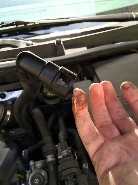

Quick update on the oil issue. I pulled the breather tube on the intake and noticed a good buildup of oil inside. It is not dripping down the intake but I suspect it's enough to explain the oil consumption I have now. I also noticed the outlet has oil buildup around the seals. I can't confirm if this is a normal condition since our PCV already generates higher than normal crank case pressures. But combined with the oil seeping near the alternator, this would explain a lot. See pictures below.
I've been researching the replacement procedure and can't believe Mazda chose to hide the valve behind the IM. The battery, intake, IC, throttle body and manifold will all likely be removed. For first-timers, this is easily a weekend job - especially if your tool selection is limited. So it looks like I'll be cleaning the intake valves along with replacing the PCV valve in the upcoming weeks. Thanks to members dougefresh_, superskaterkes, and Jimmer307 for the detailed write-ups.
How To: Change your stock PCV Valve and Venturi Set Up

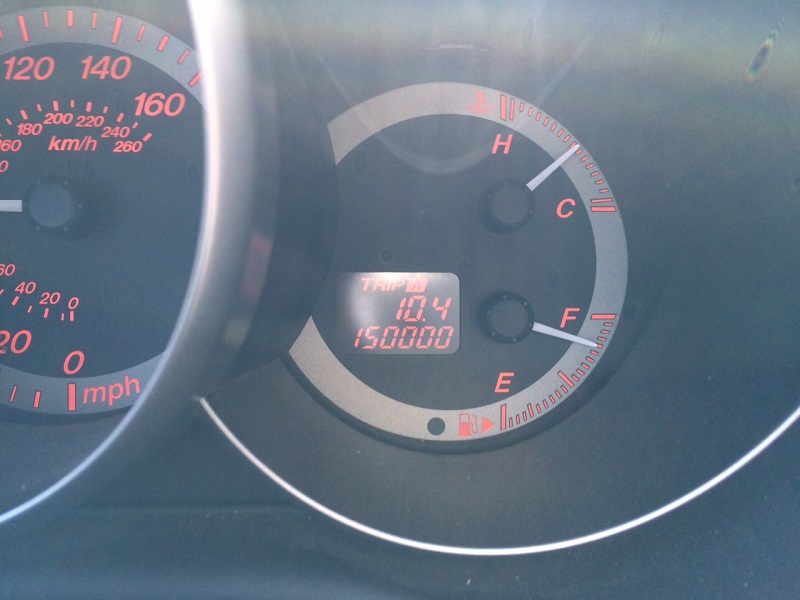

Update 150K:
Oil Consumption Issue:
After months of researching and collecting parts, I finally got the turbo replaced. I was fortunate to find a used 2nd Gen turbo with sub-50K. And the owner ran it with nothing more than an intake. Also, since I had been dumping oil the last 10K, I decided to swap out the DP while I was there. This was an odd issue as there was no smoke at idle and very little at WOT; just very aggressive oil consumption.
A lot of folks have asked what caused the failure. We suspect it was a bad turbo exhaust seal due to over-oiling. As most of us know, the factory PCV builds higher than normal crankcase pressure at idle, causing a partial blockage in the return line. That in turn can put excessive pressure on the seals as there is relatively little restriction in the oil feed line. It can also cause coking in the turbo as the oil literally "cooks" in one spot over time. I suspect this is also related to my oil cooler gasket failure, along with oil seepage near the alternator.
This is really only a problem with the Gen 1 PCV, as the Gen 2's have revised turbo oil inlet passages and a revised valve cover. In my case, had I caught early enough, a simple $30 restrictor bolt would have prevented this problem from occurring so early. Long term, Mazda has supplied a ventilation kit with a revised valve cover and TIP (Part ID L3Y1-13-S80B).
The final smoke at idle fix from Mazda TSB 01-002/11 dated 2/23/11
It's only been about 30 miles but as far as I can tell, the smoke is gone. I've also noticed better throttle response under boost, with PSI peaking @ 17.5 vs. 16 on the old turbo. Time will tell if this fix is permanent. But for only a few hundred in parts, I feel this approach was well worth it. Worst case, I now have a spare turbo I can rebuild should the issue resurface.

Quick update after 400 miles. Oil consumption has slowed but not to a rate I had hoped. With strong compression and leakdown numbers, all evidence is pointing towards worn oil control rings. This is not an isolated issue with our cars, as evident in the thread below:
Mandinca's Oil Consumption Problem
So with a spare DP/MP on tap, I will likely ride things out for the next year or two. Then hand off to someone local wanting a cheap project car. Until then I'll keep updating this thread with any other things that come up.

Ran into your thread because my car started to consume some oil. I am starting with PCV valve, and see where I go from there. If it's due to turbo seals, BNR S3 or S4 will be next.

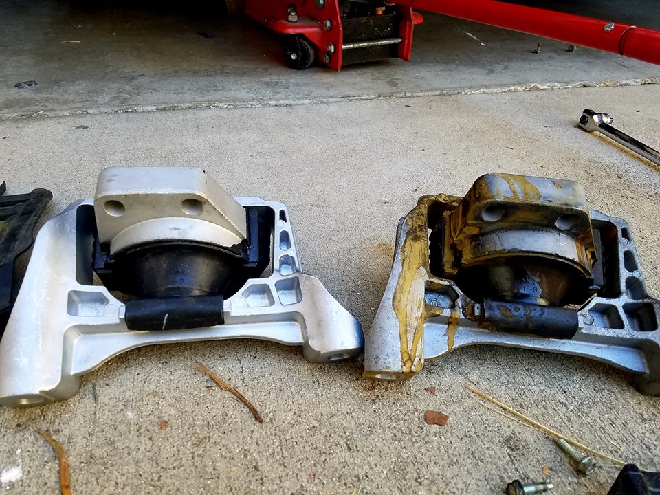

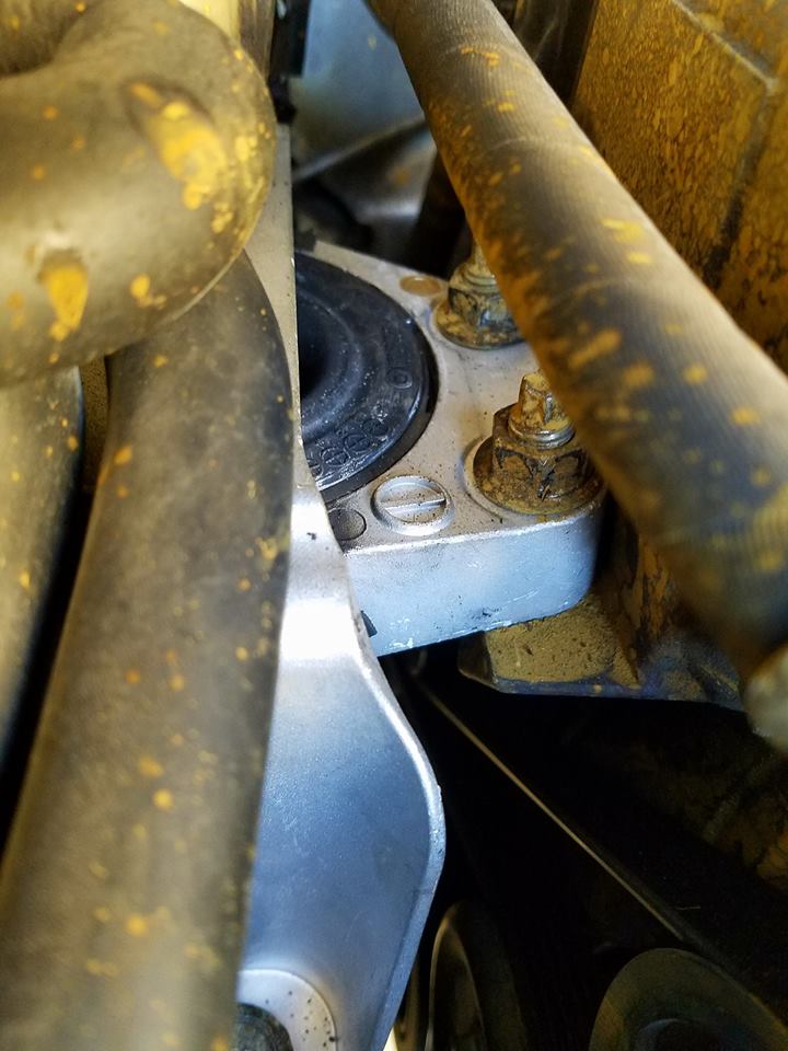

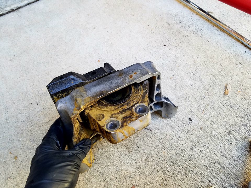

Passenger Motor Mount
Pretty easy to spot a bad motor mount as the Mazda one is fluid filled. Had motor mount fluid all over the passenger engine bay. Most know that Mazda uses very soft mounts to minimize NVH. And the Gen 1 OEM replacement is well over $300. Fortunately, the Gen 2 PMM is under $100 wholesale. It's the exact same part without the black counterweight. I ordered the Gen 2 and swapped the counterweight over. Few photos:

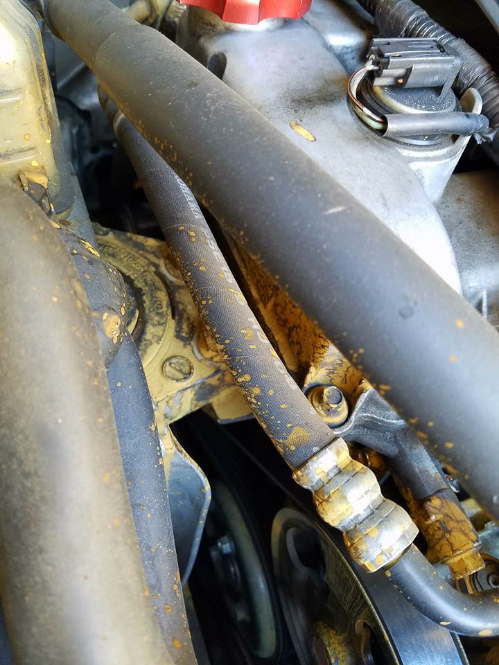

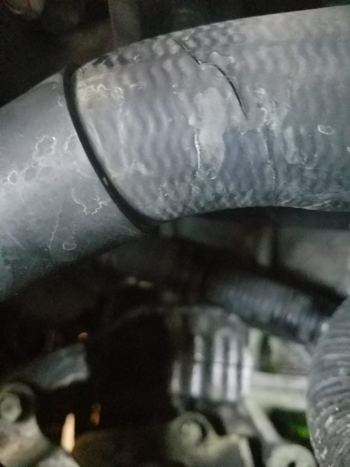

Coolant hose
Around 184K I sprung a 5 mm leak in the coolant hose between the engine block and driver's side radiator. Had a tough time chasing down as it would only leak under load. I also noticed the reservoir hose unclipped over the radiator fan - a common problem on Gen 1s.
Coolant Leak for me
To add insult to injury, no local dealer had the hose in stock. A 4 day downtime waiting for the main hose to come in. I ended up putting zip ties around the reservoir hose to the radiator. So far so good.

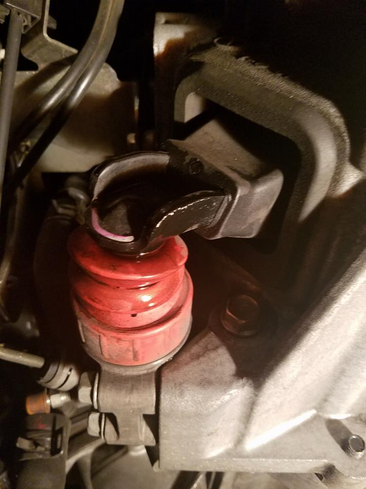

Clutch Master Cylinder and Slave Cylinder
Around 184K I noticed I was losing brake fluid from the reservior. I chased down to a small puddle just below the transmission. Pulled the skid plates and saw this on the slave cylinder:
Fortunately the leak was slow and would allow me to drive the car (albeit carefully) while the new part was being ordered. The part itself is cheap. But it's recommended to replace both the Master Cylinder and Slave at the same time. I was never given the choice; 2 days later the MC failed, with the clutch pedal going straight to floor. Frustrating but gave me the excuse I needed to do both.
The slave is easy to access and requires 3 connectors & 15-30 minutes to do. BUT, be sure to swap the o-ring from the old Salve cylinder to the new one. More here:
Leaky Slave Cylinder
The MC requires removing the intake, battery, tray, ECU harness and clutch pedal assembly to replace. Another 4 day downtime waiting for the right parts to come in. But the clutch feels strong again after replacing both.
