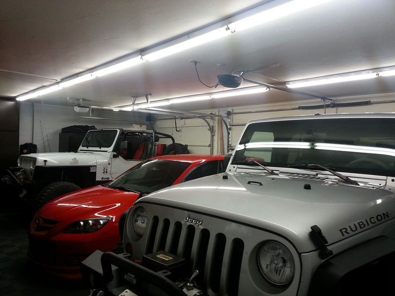

For lighting, home depot sells LED light tubes that look like the fluorescent T5 type. It's just that they are a bit expensive at $110 or so for the fixture and 1 tube. That LED light I posted has pretty good light spread. I installed one in the laundry room and it's not that spot focused. But yes, a combination of different light will probably be the best.

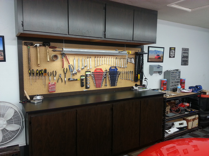

I would def do the stainless steel bench top, I almost bought one from ikea that was slightly damaged for $100, not bad for over 8ft long

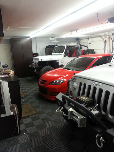

220v great for compressor, most of all WELDER! Don't forget a good floor coating. Makes cleanup a lot easier.

I would highly recommend building your own work bench. Thats what I plan on doing building a base and buying a butcher block top for it

How about just building the work bench with 2x4s and then cladding the top with 20 or 18 gauge stainless steel sheet? That's one thought I was having.

That works to I just prefer wood bench's because not so harsh on a part u are hammering on.

Do you ever plan on having a lift of any sort in there? High rise doors, good concrete, etc are all important. No point finishing the floor if you need to jack it all up to get the min 4" 3000psi or whatever is required for a little lift.

For lighting, I am actually leaning toward T5HO neon tubes at the moment. Those fuckers put out a lot of light.

we made a 2'x8' workbench out of 4x4s and 2x4s. its really sturdy and has a MDF top. i still need to seal it. I need to work on my lighting as well. there is a mount on the wall for my FD wheels. i can still get two cars in there if need be so it works.
i like the idea of the compressor in the attic. i plan to do this soon. scott has his in the attic with everything plumbed down (even the drain).
its not officially done until there is a big sparkly NATOR sticker on the wall.

Regarding the floor I went with garage tile. It would have cost me $4800 if I would have bought it new, instead I picked it up used from a pawn shop here in town. I got about 650sq ft for $500 which was a steal. My garage floor already had epoxy on it which i didnt care for at all. It looked nice when it was brand new but it didnt hold up very well. Within a year it was already chipping and had multiple stains on it that wont come out. I even put the clear coat epoxy on it and that didnt prevent stains. With the garage tile all the liquids just seep through the tile to the floor so your not laying in coolant or oil that may have spilt onto the floor. This is the garage tile I have in my garage, highly recommended! Premium Rib Drain Garage Tile | GarageFlooringLLC.com
Lastly regarding the workbench, maybe check craigslist or those local flyers that get sent out. Check to see if you have any custom garage cabinet builder people in your area. I had them build me a 12ft work bench with peg board and it has cabinets up top and below, was only like $400 with tons of storage.
Here are some photos of my garage. Just completed it late last year and love it.
Here it is with the lighting I just installed.
My workbench
