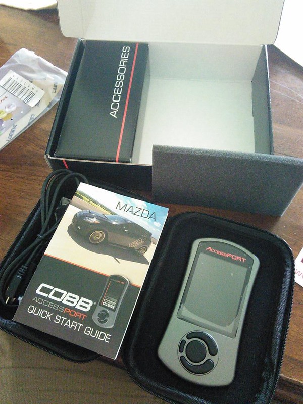

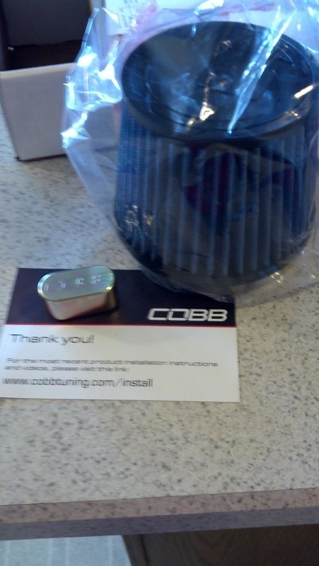

Got some more goodies in the mail today

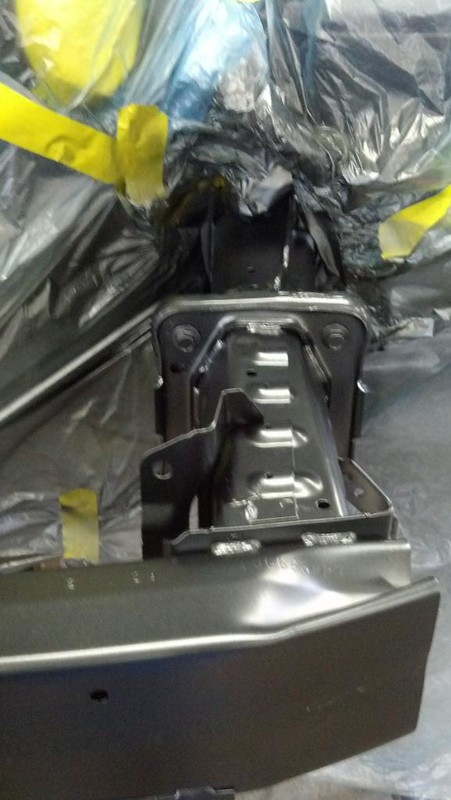

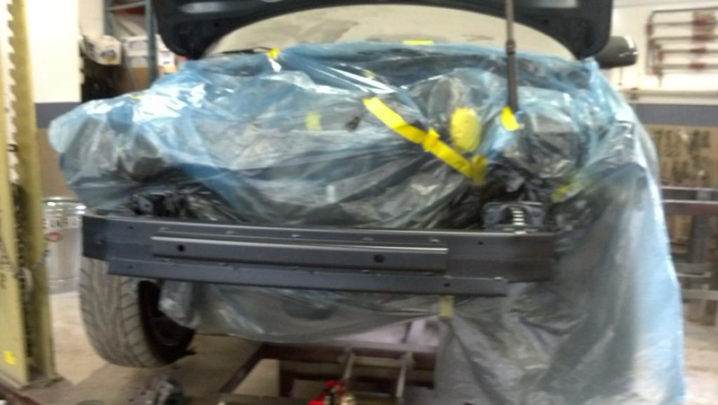

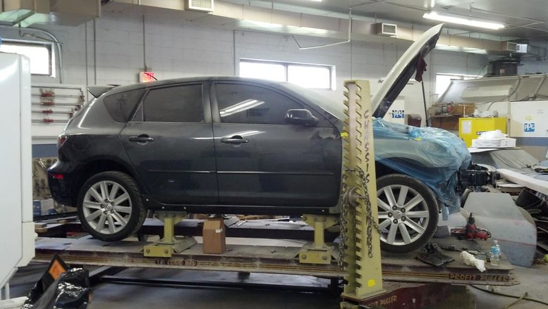

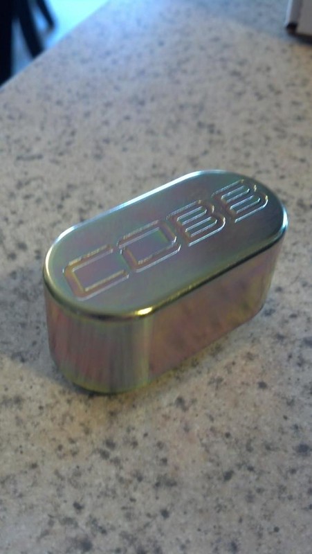

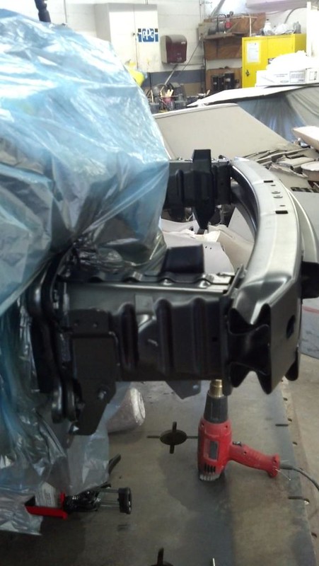

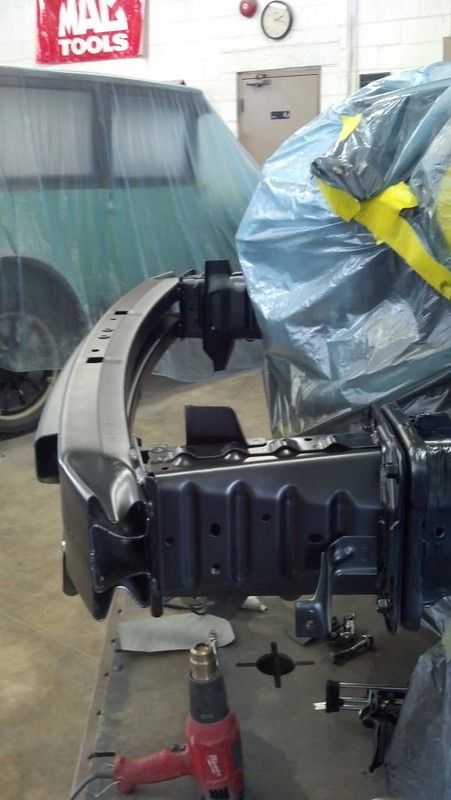

Update on the build, making progress the crash bar bracket was pulled and to spec, and tonight the left rail will be pulled because it is ever so slightly out if spec which is actually why the hood didn't line up perfectly in the pictures on page two. After that it will come off the rack and then the rad support, and bumper get put on!
Also got lamin-x yellow fog covers because I love the way they look on a metro gray ms3, but it only looks like there is one cover in here ? Lol

Front end is all to spec Saturday, im going down to put the Rad support in place, front bumper and pretty much button the car up for paint! since Cobb gave me two Accessport face plates i think im going to take the blue one and paint it metro gray to match my car exactly. should look nice and add a touch of detail, after all sometimes its all the small things that make the big picture.
as always ill keep everyone updated.

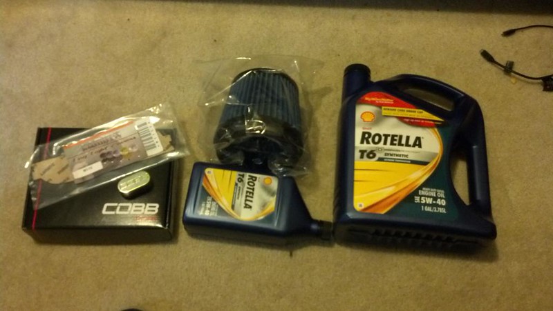

picked up some Shell Rotella T6, couldn't find a wix oil filter for the speed3 so i haven't picked one up yet. they had a motorcraft filter but i haven't heard if they are good filters for the speed 3.
going to be putting all of this on tomorrow

picked up some Shell Rotella T6, couldn't find a wix oil filter for the speed3 so i haven't picked one up yet. they had a motor craft filter but i haven't heard weather or not they are good filters for the speed 3.
I wish they had 1qt bottles of Rotella here
FYI I thought the Genjuan took 6qts like the Genpu? If so -you're missing a qt

shittttt lol for some reason i thought it was a 5qt jug, thanks for pointing that out!

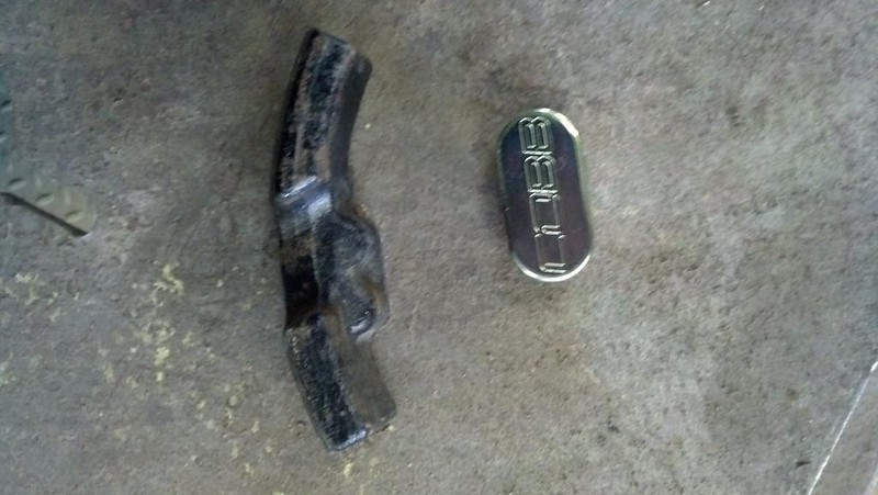

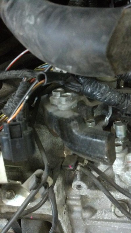

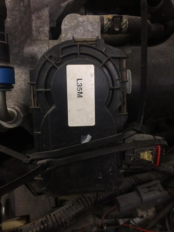

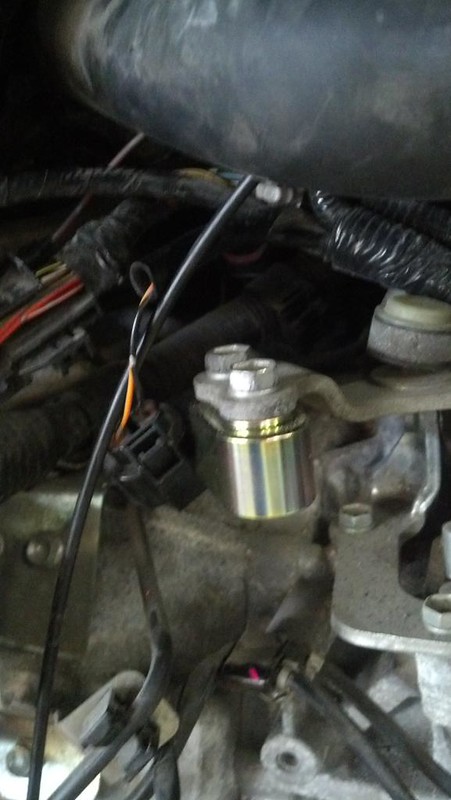

well, i just noticed this is broken? maybe? i don't even know what it is, its right next to the throttle body. throttle positioning sensor? it works as in no check engine light, but the connector wires are all exposed and well its zip tied in place lol. any ideas on what it is and where i can get a new one?
EDIT: im retarded. its the throttle sensor, and from the searching ive done you cant just replace the senor you have to buy a whole new throttle body
If you are not having issues, try to wrap the exposed cables with lectric tape or something doesn't make it look bad

Thanks: 108
I'll have to take a better look at it tomorrow, I'm just worried about it giving me issues down the road ya know
 Old 07-11-2014, 06:55 PM   #106
f15ms6's Avatar
Location: Philadelphia, PA
Posts: 1,546   (View Stats)
f15ms6 is the leader of the worldf15ms6 is the leader of the worldf15ms6 is the leader of the worldf15ms6 is the leader of the worldf15ms6 is the leader of the worldf15ms6 is the leader of the worldf15ms6 is the leader of the worldf15ms6 is the leader of the worldf15ms6 is the leader of the worldf15ms6 is the leader of the worldf15ms6 is the leader of the world
Thanks: 1,298
Thanked 349 Times in 273 Posts
Yeah I know what you mean take a better look at it, because I am sure the throttle body isnt cheap..

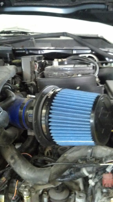

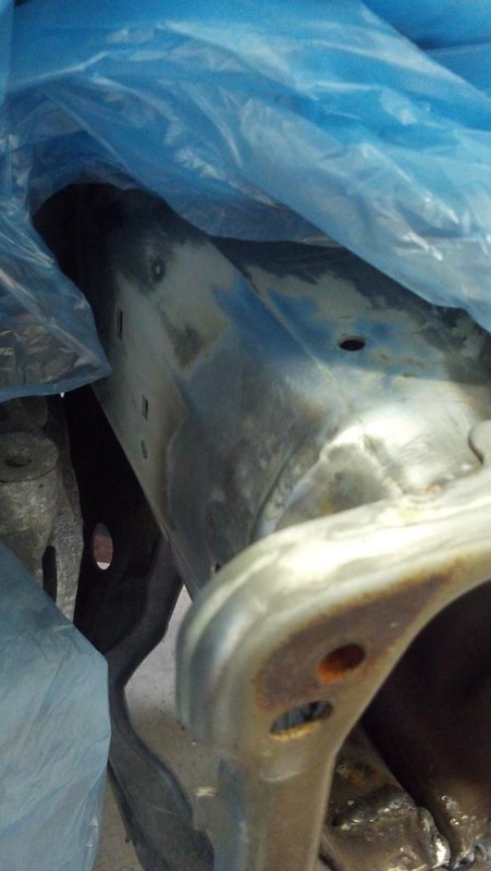

first thing i did the two easiest and quickest things that needed to be done. Swapped out the stock counter shift weight for the Cobb shift weight.
install was a breeze, seriously took me all of about two minutes.
then i changed the air filter, never realized how light of a blue it was suppose to me lol.

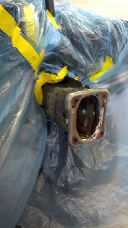

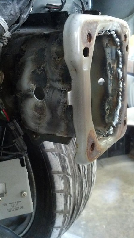

Next up was to grind down the welds so they aren't jagged and i could potentially cut myself as im working on my car in the future. the other reason is so they just simply look better haha. obviously these welds aren't super clean reason being is that i'll never seem them again.
yes, that tire got fucked up lol but surprisingly still hold air!
after i ground them down

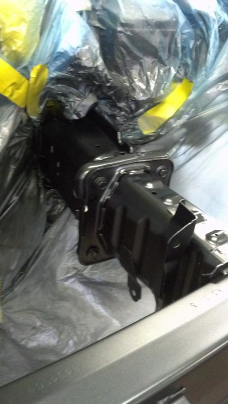

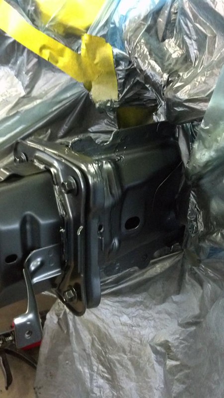

after that i covered up then engine bay and prepped the area for paint. used 80 grit sand paper and sanded down the rail, went over it was 320 grit then a red scuffy.
after the area was prepped, it was paint time!
and how i left her today
