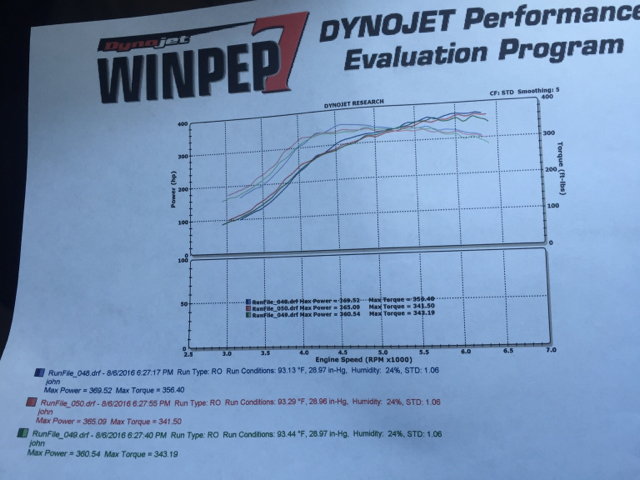

Here's a log from the most recent revision on the e85 mix. Tuning should be done soon as we are running out of fuel.
what kinda power is it making now? seems e85 taps out quick

Wasn't the final revision. I still think there's just a little bit more left in her. It was an outdoor mobile dyno and it was a cluster fuck they forgot to log the pulls. Oh well. 370/356.

Not to bad. I am making a little more then this on meth.

How much boost was that and sorry if I missed it but what kind of mix you on???
4 gal mix and I'm pretty sure 23 psi
Almost identical to what I was making on E85. I was right at 375/385 on a 2 gallon mix at 25 pounds.
