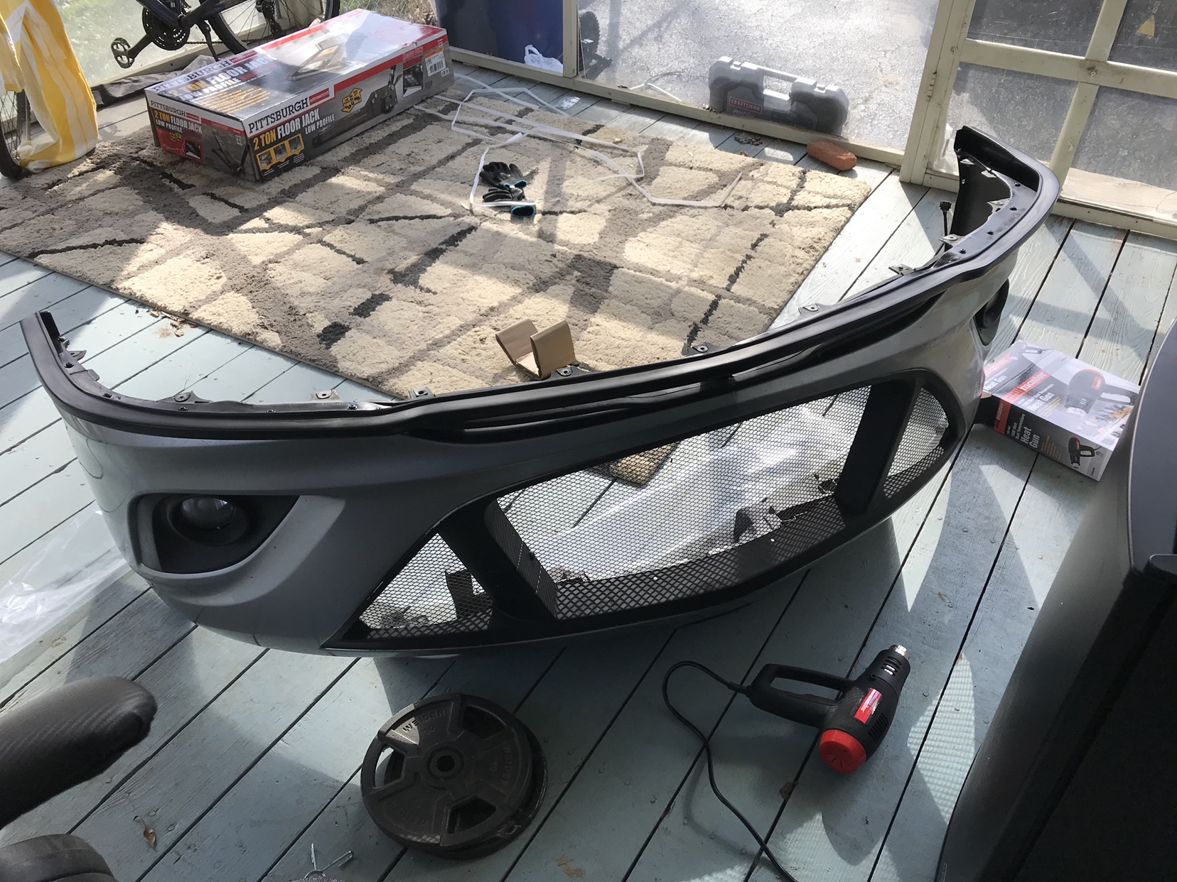

Finally got around to replacing my front lip that was smashed by a dead possum on the highway at 70mph. Still need to plasti-dip it matte black to match the rest of the trim, but my baby’s whole again.

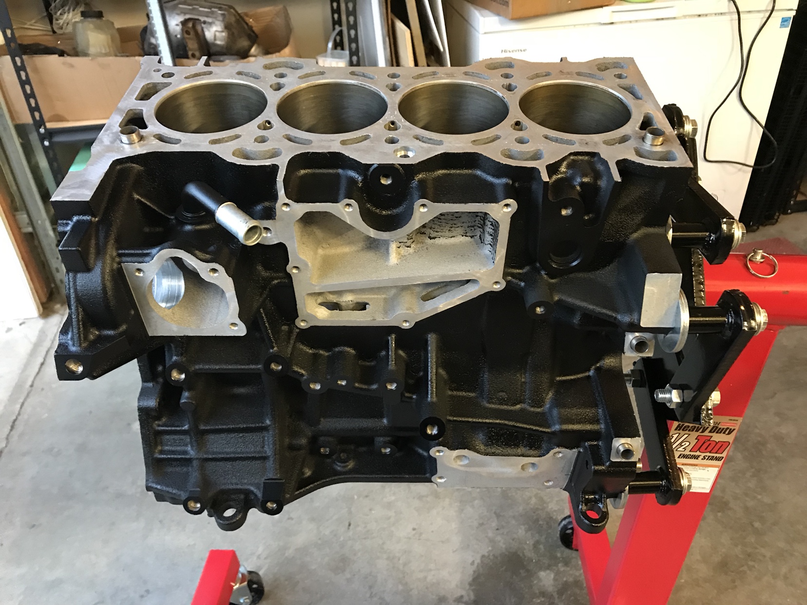

Picked up the donor car today! Everything looks excellent. The bottom end looks exactly like you'd expect with 190,000 miles on the pistons, but the cylinders are silky smooth, no scoring, no issues. The head was also machined recently and the exhaust valves were replaced. We also found some freebies in the car we weren't expecting, including a cam timing tool, new VVT, timing chain, tensioner, and some other surprises. HUGE win today, even though my back is on fire and I think I need a wheelchair. I cannot believe the dude was selling this car so cheaply! Tomorrow we get to rip the block out and prepare it for the machine shop. Stay tuned!

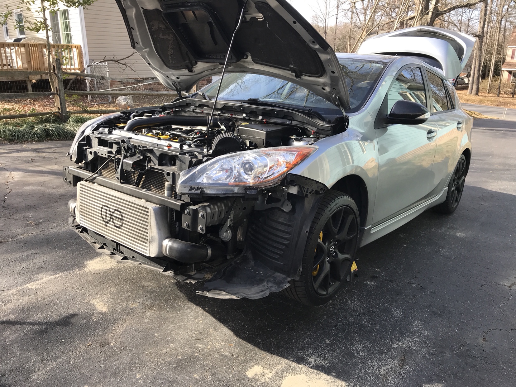

Made some progress today. Whole front end disassembled and she's ready to come out, but we ran into a snag because the 190,000 mile old CV axles just will not come out. We need to get a CV puller to finish. Everything else is unhooked, though. She's only in by the engine mounts.

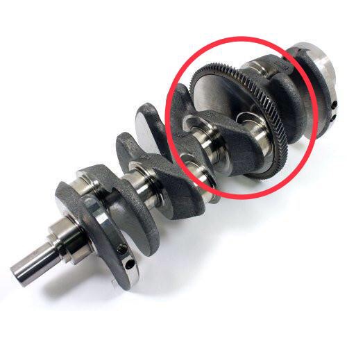

WTF helical gear are you talking about?
JBR Tru-3.5/3-port EBCS/EGR-D
Damond RMM/PMM/OCC/PCV Plate
Other rides:
History:
2008 GSX-R 1000 - Stolen
 Old 07-04-2018, 05:32 PM   #103
Solarsurge's Avatar
Join Date: Apr 2016
Location: Richmond, VA
Posts: 577   (View Stats)
Solarsurge is the leader of the worldSolarsurge is the leader of the worldSolarsurge is the leader of the worldSolarsurge is the leader of the worldSolarsurge is the leader of the worldSolarsurge is the leader of the worldSolarsurge is the leader of the worldSolarsurge is the leader of the worldSolarsurge is the leader of the worldSolarsurge is the leader of the worldSolarsurge is the leader of the world
Thanks: 24
Thanked 120 Times in 95 Posts
The one the balance shaft connects to.

So, I took my block to the machine shop and got amazing news. All 4 cylinders are perfectly round, crank pin and main journals literally have zero wear, everything is .000" from factory spec, main bearings literally look brand new. After 190,000 miles it's still like a brand new engine inside if not for the oil discoloration. I think I found a unicorn!

Decided to go with Manley Platinum Series 87.5 Pistons w/.210" Wall Pins and Manley H-Tuff Plus Rods. Still researching bearings since Clevite H Series mains aren't made anymore for the speeds. Bummer.
