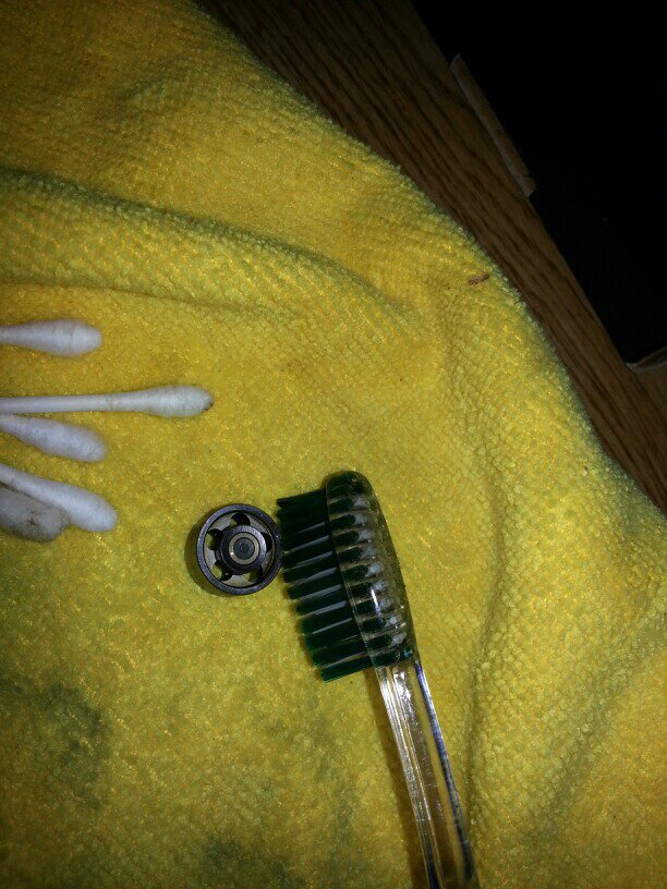

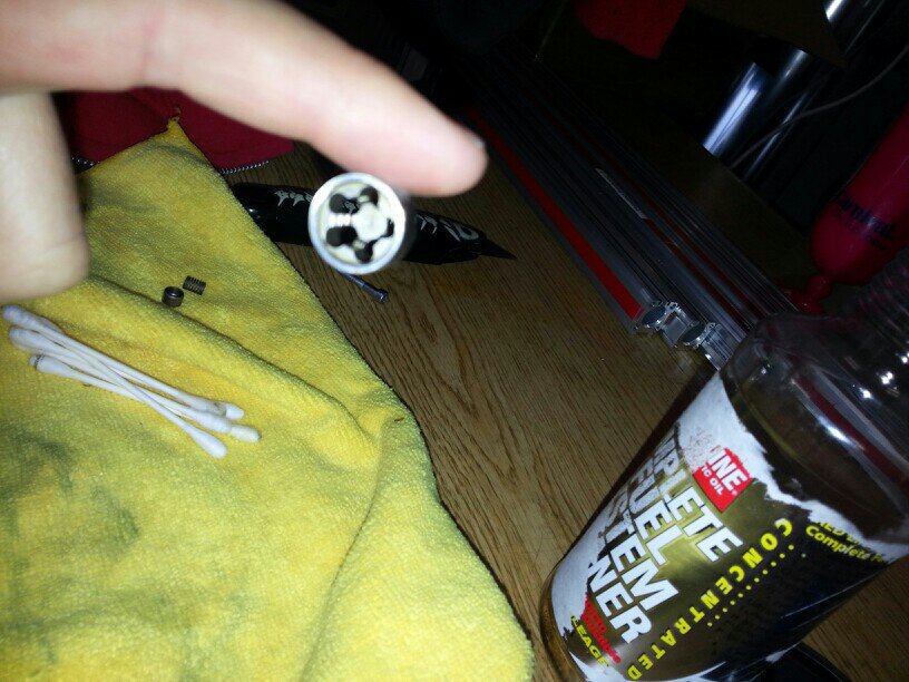

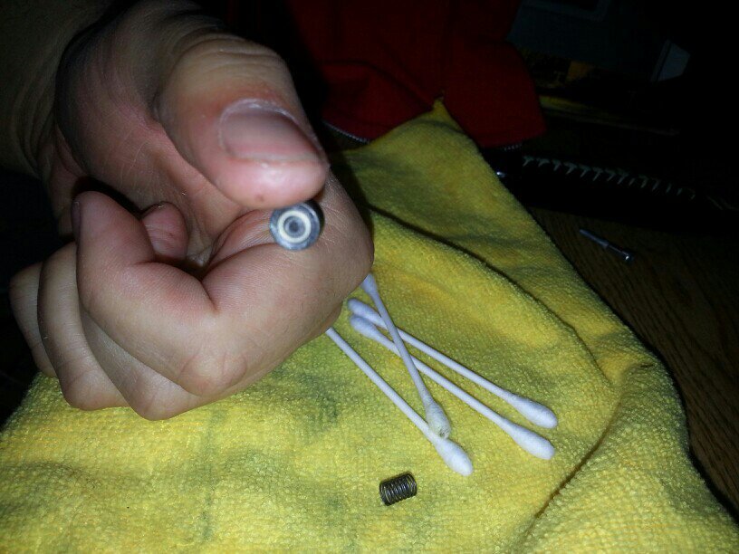

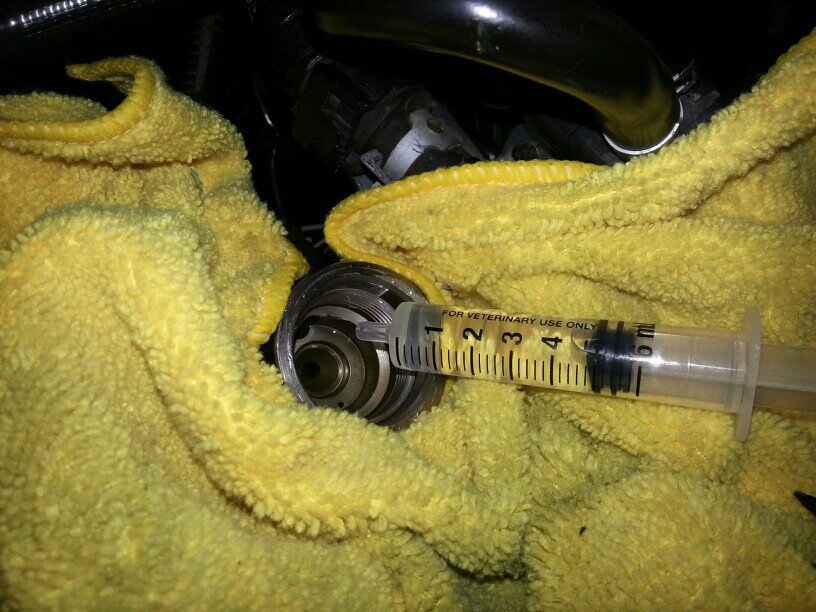

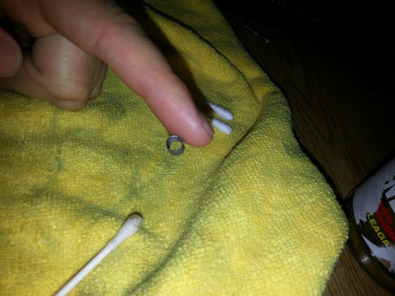

Pulled my SV today. Its not magic, its just sticky goo!
Took some fuel out of my pump and a tooth brush, cleaned the sticky right off.
I inserted Enki's button valve spring mod. Pressure was still dropping every couple cells. I am glad to see that even when the spill valve is caked with sticky shit, it still preforms like it should when soaked in the fuel.
I just played with my tune, changed my pressure targets, Leaned my AFR a bit. Did a MAF CAL. I'll See if anything changes.
