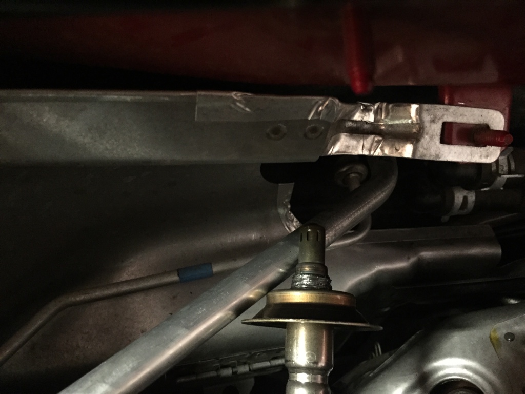

 Old 05-20-2015, 09:09 PM   #52
How the fuck does that even happen?

That's just what mine looked like when I took it out this weekend. I had to re-tap the hole and buy a new o2 sensor. Hope you have better luck!

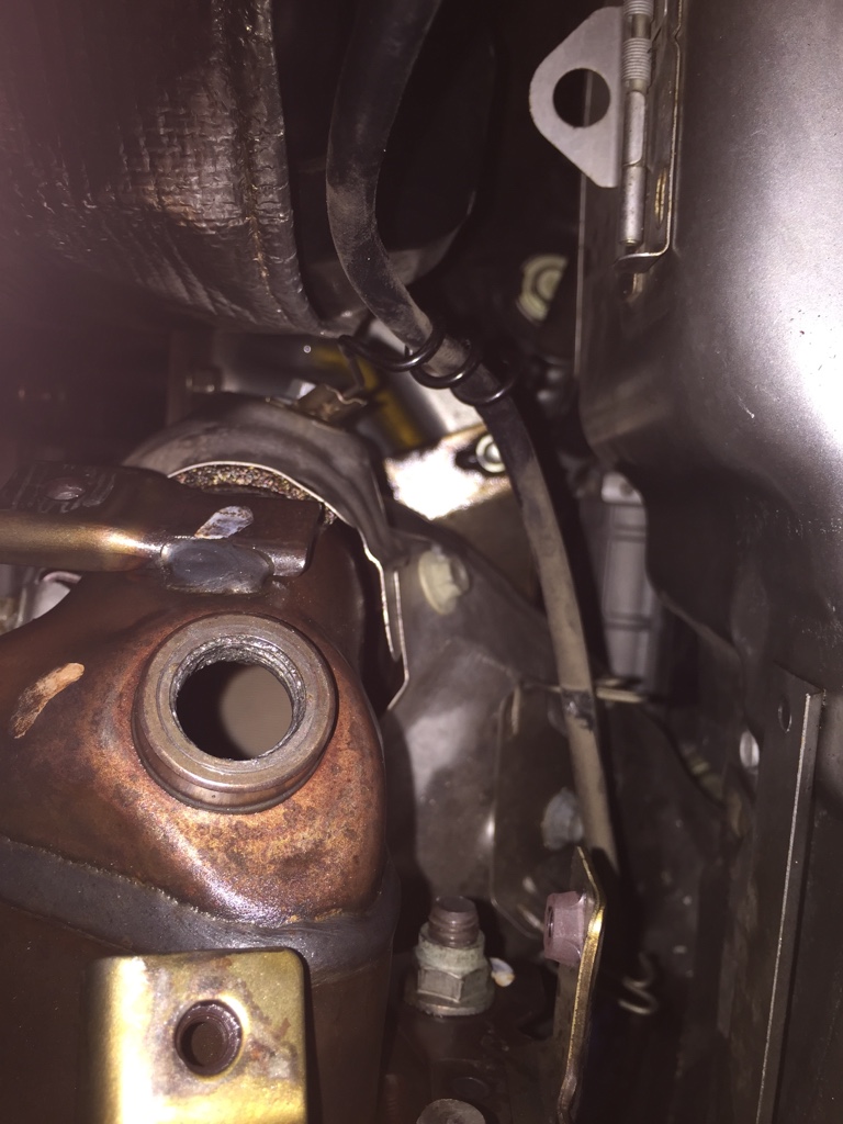

Holy shit... Fuck .
How's it look on the DP?
Edit: That's a really clean looking o2 sensor. lol
I am so fucking pissed. This is some bull shit. I'll just JB weld it back in there. Fuck it.

They have helicoil thread repair kits for oxygen sensors...I don't know how well they work.
Edit: Probably better of buying a cheap DP

Looking at downpipes a now, but I really wanted to keep it stock looking. Funny story, the downpipe came right out...
100% corn on a K04 baby! EGT > 2000.
but really that sucks.
but really that could be due to high EGTs. Might account for the cleanliness of the O2 sensor as well.
Sent from my iPhone 6
unless you can cut/weld (which wouldnt surprise me), bring the o2 bung 30ish degrees counter clockwise. Should give you enough room to play

Dont let that shit spark! Caused issues in @kbz0129;s car for weeks! @Captain KR;
Worst case scenario he can just bring the DP to an exhaust shop and get a new bung welded on for a few bucks. Cheaper than a new DP. Or helicoil it

If I can clean up the threads with my tap then Ill buy a new O2 sensor. If not @Easter Bunny; called it. Lots of JB

I ripped my o2 sensor out the same way. Looked exactly like your picture.
I have the old one with part of the DP threads somewhere at home. If I can get enough of the DP side of it off, I'll measure it to verify the size for you tonight.

I will tap tonight. It looks to me that the O2 sensor lost most of its threads in the downpipe. I will pick up a new O2 sensor on the way home from work. And some anti-seize. Even if I can clean the threads up on the sensor, I did get a lot of PB blaster on the probe itself, so I should get a new one anyway.
Hit a brick wall my friend.
Get a 90* small pick and you should be able to get some of the threads clean with that. Harbor freight has a cheap little set of 4 picks with orange handles for like 2$, work for what you need.

Amazon is only $60??? The local auto parts store tried to rape me $400 for a new one. But right now the 02 sensor is the least of my worries.
I broke a socket trying to get the turbo support plate off and rounded the bolt head. My god they are way over torqued for that size of bolt head. Had to get a 3 foot cheater bar to break the first 2 loose. Then on the 3rd is where I broke a socket and now I am once again stuck. This had got to be the biggest pain in the ass that I have ever faced.
My only move now is to remove my exhaust manifold, so I attempt to do so. Then get stuck on the last bolt that sits In front of the turbo. Its like something is telling my not to install this thing.

You're having trouble with the bolts fastened to the cast iron parts?
Are you using a 12 point socket or it rounded it off because the socket is Fucked off?
Try using a 6 point, if you already aren't and tap it on with a hammer or whatever you can hit it with, be sure to squirt it with some penatrating fluid too.
Btw, what pen fluid are you using?
