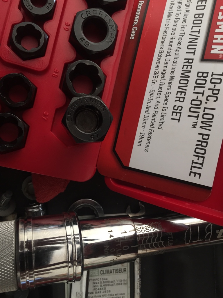

I was using a 6 point. Low profile piece of shit. I took this kit back after it failed.
And got store credit and this as @Easter Bunny; suggested

Even the extractors are slipping. That bolt is fucking stuck a fuck. Thinking about getting this specialty tool:
Seems like my only option. I'll keep working at it, I really don't want to take the EM and the studs out... Even then I doubt I can get it out because of that damn plate.

Did you buy the metric sized extractor kit?
Yes. that kit seems to require some hammering to get the sockets to grab the bolt. There is not a lot of room for hammering. I am off to the store to go buy some more beer and get slowly get drunk as I keep trying to remove this damn Bolt.

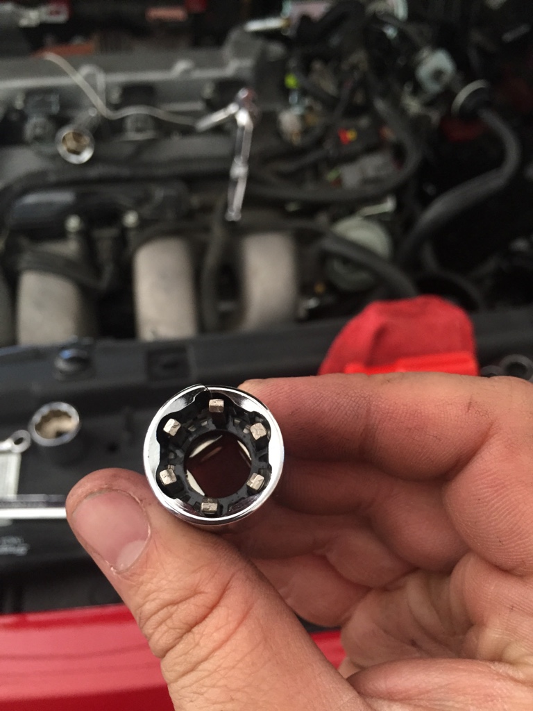

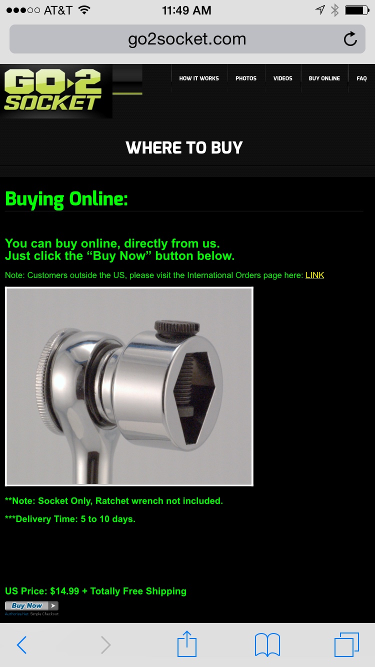

So, while at the store I see these weird sockets. They are advertised as "will work on rounded bolts and nuts" so naturally I buy them and tell myself that if this fails I'm going to bolt my car back together and send CS their turbo back. Sure enough it breaks within 2 mins of opening the package.
I then said to myself, let's try the Bolt outs @Easter Bunny; suggested one more time. I noticed that this time the extractor fit on 80% of the bolt. "Oh Yeah, it's fucking on" I said to myself. "I knew those new sockets would work." I grabbed my 250ft/lbs torque wrench and set it to 120 foot lbs... No dice. 130... Still nothing then finally at 140 ft/lbs I hear a "crack!" I said well fuck there goes my extractor. Holy fuck would you look at that....
I got that SOB. Now the turbo install, can continue...

Most likely a combination of frustration and not thinking. I was surprised how much torque they could take. It's like the more force I gave it, the more it dug into the bolt. I will have fun removing the bolt from the extractor. I'm sure.

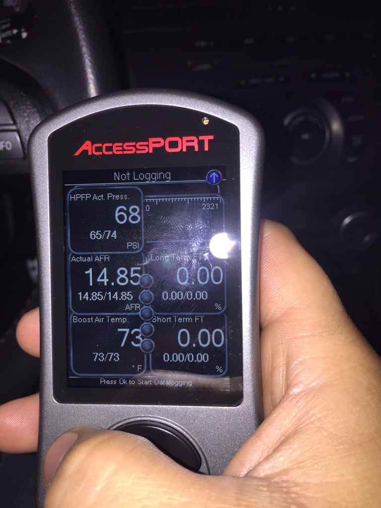

I might have to take you up on that. I got everything together and fired her up. It seemed to run okay for the first 10 seconds or so, but then it would start acting weird. Almost like the engine is chocking on itself. I am getting AFR reading s in the 14 range which seems good. But i did notice that the AFR's did not bounce around like they normally would after a battery pull. Also Shouldn't my AFR's lean out when my engine is off and ignition on?
This is what my AFR is showing with the engine off and key on after 8 hrs of sitting. I don't think that normal, is it?

I'm not certain - I've never checked my AFRs with the car off. I'd imagine it just displays the last recorded AFR value before you shut the car off. PM me your address and I'll get it sent 2 day USPS.

AFR should be lower on startup. Though if you didn't run it long enough to get the sensor hot it could have not been registering a value yet.
Sent from my iPhone 6
It's completely normal to have a KOEO AFR reading of 14.85, if my car is anything to go by. It's been that way for the last 80k miles.
That's great news that the sensor my not be screwed up. But now it's leaning towards worse news that something else maybe wrong. Of course there is not much more that could be wrong. So, Hum...

@littleloogy; that socket set is shit. I broke 2 sets. I'm on my third and now just use it for light work no torquing or breaking stuff loose
