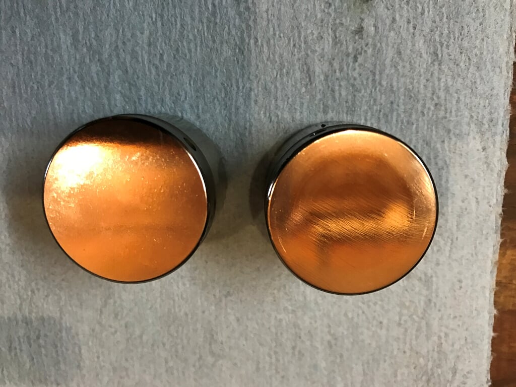

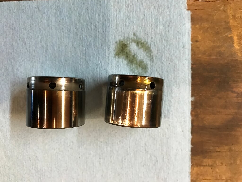

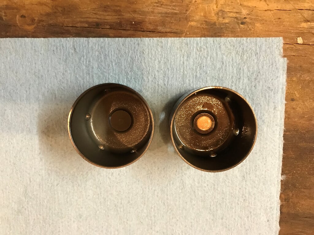

Sorry to resurrect this thread after about a year...
I'm interested in going full E soon and testing out some hardware fixes for the issues.
I just swapped my HPFP internals to IE ones and replaced the cam follower with a brand new one. The old follower looked worn but then again, my car has just over 80k miles on it.
This will let us know definitively whether or not the IE internals are causing this advanced wear of the cam follower or not. I'll pull the cam follower out after a few thousand miles and then post the results on here.
Pics of the old follower (right) compared to the new follower (left):

Nah mine looks like that with only ever having used Autotechs.
Good to know mine looks normal for using AT's. It'll be interested to see if @littleloogy;'s wear results are replicated when I pull the pump in a while.
