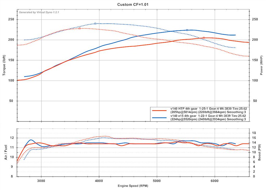

So I did a 4th gear pull and I lost power and torque... Lol. After looking at my map, it looks like the higher calc. load just put me into an area of the timing advance table that had very low timing advance. I'll have to adjust it to match the timing advance I was hitting before installing the intake. I attached the 4th gear pull log and a log from before I installed the intake running the same map. You can see I'm running almost no timing advance for most of the pull.
Here is a virtual dyno comparing the two logs I posted. The red line is with the HTP 3" and the blue line is with a stock intake:
Please note that I did NOT lose power because of HTPs intake. There was almost no timing advance until 5,000RPM in this run.
I picked up about 30G/s of airflow over my last logs, which were actually on colder nights than tonight by about 10°f. I'm still hitting my commanded AFR +/-.2., so I don't think the MAF G/s reading is skewed by a bad calibration. My calc. load is higher by about .2, but that could just be from scaling the MAF.

Boost_addict it's hard to believe you lost power.
Please only show results like that after you have completed your tuning with all things be as equal as possible.

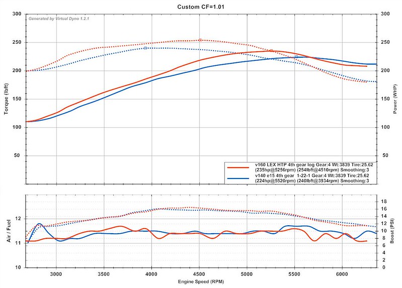

Try the MAF Cal I posted in my thread on the Stratified section. Looking at your MAF scale it seemed over scaled in the top end.
So after the adjustments I made to my MAF cal last night based on the logs I posted, my LTFTs at low load are within +2/-2, so despite the MAF curve looking like there are some slight flat areas, it seems to be working well. I might still make a map with your MAF Cal. just to test it out for you.
I'm going to adjust my timing tables and hopefully post some legit comparison logs tonight.

Here is a Vdyno after getting some timing advance in there.
Pretty decent gains considering I'm still running a little less timing advance than before. I'm using @Lex;'s MAF Cal. and I picked up 24G/s. There's a nice gain through out the whole power band too.
@ms3blackmica; @HTP;
