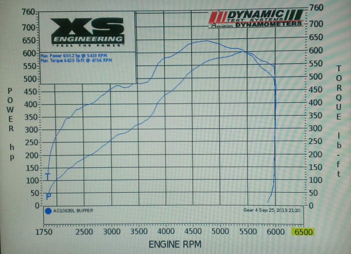

Did some more pulls tonight, we opened the cutout and picked up 37HP and 50TQ at the wheels.
We have some more custom tuning to do but I'm very pleased with the results

Damn, that's well done
Just one thing, I thought torque = HP at 5252 rpm, those lines intersect at 5500rpm :/

I'm sure it's just resolution.

2011 Ford Flex
The motor is STOCK internals.
The car has the following mods:
Dual in tank fuel pumps
6 auxiliary injectors
Split-Sec aux injector controller
Car runs on straight E85 - 23 degrees of timing.
PPE Engineering 2.5" catted downpipes with stock cat-back and sound performance racing cutout.
Custom turbo to intercooler and intercooler to throttle body piping with silicone tubes to replace factory plastic/rubber parts. Replaced factory electric BoV with Tial BoV.
First night
First pull 505HP/515TQ 15PSI - using stock ECU for boost control
Second pull 563HP/598TQ 23PSI - removed connection to factory boost controller, turbos running on wastegate spring
Next night
Third pull 587HP/642TQ 25PSI - same as second pull - allowed the boost activated cutout to open
Fourth pull 592HP/630TQ 25PSI - same as third pull - disconnected piping to filter in the fender
Fifth pull - not on video 600HP/642TQ - Cutout open, car had sat as we were uploading files to ECU - car was running cold air intake
We haven't tuned the car yet, this is a tune from Torrie at Unleashed from months ago on my old compressor wheel upgraded turbos with E85. We're just adding fuel via aux contr

Wow, that probably has something to do with the torque beginning to fall off after 6K rpm. Those are fucking tiny.
Yes it does and yes they are, lol. The head ports are also small. Its how they manage to make such a broad torque curve. Certainly a lot of velocity but not much flow.
