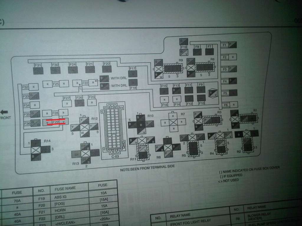

Install guide guide looks great! Which fuse would be good to tap into with add-a-fuse? Wasnt sure if the pic was the actual or a "sample".

That is the MS3 location I used for my methanol and and guardian angel connections. The name is F29 - and it is a 15A circuit that powers the P. Outlet in the car.
I marked this on the MS3 wiring diagram below. The reason the instructions aren't MS3 specific is because the product is meant to be more generic. I am hoping a couple of the guys here that get these will do a nice writeup.

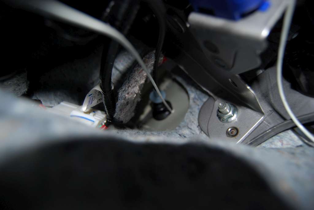

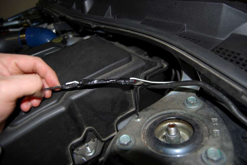

I ran the LED through the hood latch hole and the grommet fit back on there. I used a bent coat hanger to pull the LED through after I taped it to the coat hanger and it worked very well. Some images below
