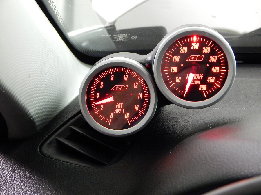

Having said that, my newly installed kit isn't working. Meth is spraying fine but flow guage isn't reporting anything.
I double and triple checked all connections and fittings, flow sensor direction, 0 install issues.

UPDATE: THE AEM flow gauge is a total piece of shit. It isn't rated for temps over 100F and I have already broken 2 of the flow sensors due to heat. AEM recommends that the flow sensor be in the passenger compartment or trunk (LOL) or basically completely away from any heat.
I don't know where on a car you can guarantee ambient below 100F. For the reason, I cannot recommend AEM flow or failsafe gauges because their flow sensor is garbage.

Ok guys here is the AEM flow sensor. It's the thing in the lower left hand sensor.
It only took me a little while searching to find their flow sensor supplier, it's gemsensors.com and the part number is FT-210.
Website: FT-210 Series TurboFlow; Turbine Electronic Flow Sensors
Now, what first comes to mind is they have an 'Instruction Bulletin' it's here. Of note is the following: "The system needs to be filtered to 50 microns prior to the sensor, and pulses/water hammer effects should be minimized to prevent unit damage."
http://www.gemssensors.com/~/media/G...ns/FT-210.ashx
Well shit, of course AEM doesn't include a filter (which isn't a bad idea anyways), but the part that gets me is the 'pulses/hammer effect'. My DVC-30 pulses the pump. The higher duty cycle (more pulses), the higher the flow and vice versa. If you've ever had a meth pump pumping into a water bucket, you can see the pulsing/hammer effect on full display. I assume that all controllers pulse the pump. So, I suspect the pulsing meth pump is what is damaging the flow sensors instead of temperature.
So, AEM is basically is selling a kit with a piece of shit flow sensor.
BTW, my AEM EGT sensor is also bouncing around when temps go over 1400F unless I accelerate very slow. Sometimes it doesn't do this but 90% of time it does. I have been over things 10 times, and if you know my work I am pretty careful with things.
I am in full AEM hate mode right now.
EDIT: Keywords for anyone ever searching MSF or even google for this POS kit so they find this: AEM Water/Methanol Failsafe Gauge, 30-3020

The filter and solenoid might help mitigate and smoothen pump pulses. My flow sensor is the first thing after the pump.
The other thing I noticed is that the sensor input voltage is 5-24vdc. When I checked, I am reading just under 5v at the sensor. I reckon the aem gauge is outputting 5v and there is voltage drop over the 24 - 28awg 6' cable length.
It could be the 5v is also putting the flow sensor in a borderline state. From my experience, devices do not like operating at the lower end of their voltage input range. It's usually the least efficient there.

I ran a hose with a nozzle through the two AEM flow sensors I have. One flow sensor's turbine seemed to work; I could hear it whirring and changing frequency as I passed water through it. The other didn't. So, I put the good one back in.
On the way to work, one time randomly on the highway it briefly registered flow when I accelerated and then of course the gauge hasn't moved since even though I can see meth spraying by watching BATs.
