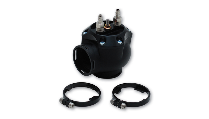

I mentioned the importance of the BPV earlier this year and finally got to do some testing with one of the fastest valves on the market.
The results were great. SWAS and stability control no longer got in the way. No more bucking, loss of boost, jerkiness when taking a hard corner in a lower gear.
So if you want SWAS and the stability control to work with you and not against you, get a BPV that is as fast as possible. A fast valve also helps response and spool.
It's nice to see someone as respected as Lex recognize the Synapse DV. I was probably one of, if not The First person to run the DV after switching over from their regular BOV.
Got some shit from Haltech and others about it, but I think they've more than proven themselves as legit: Synapse Engineering's new Synchronic Diverter Valve
Edit: Now I need to make sure I'm running in Push mode and not Pull...
Edit 2: Yup, running in Pull mode... Maybe this explains the issues I have been having with the stuttering/cutting, especially around corners lol. Cld12pk2go told me to disconnect the SWAS so I'll be doing that too Saturday...

@Lex; how would you say the synapse DV compares to the cobb bpv? I understand the configuration on the synapse can change from push to pull, but I mean in a apples to apples set up, how is the response and stability between the two?
Just curious as I was sold on the cobb unit for my future upgrade list.
I had a Cobb before my HKS.
1.It was quick when clean other wise the change over from OEM was seamless.
2. Required moly lube at oil change intervals (4000 miles of 70/30 highway driving).
3. Insides contained a push type aluminum cap with one O-ring. One spring and washer attachment for adjustment screw.
4. Adjustable via Allen key and 10 mm wrench. To much spring pressure can lead to mild surge when releasing throttle at mild boost.
5. Typical Cobb quality. Overbuilt, works fabulous in recirc, didn't want to mess with it much in VTA.
I liked it but I decided to go a different route. That being said I have been SWAS delete for 2 years.

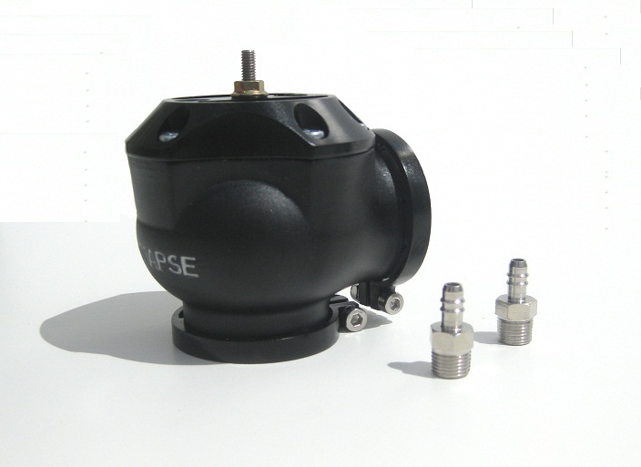

The DV should have as little preload as possible and it should be lubricated at some point although they don't mention an interval.
Also make sure the cuts are not spark related. The car commands very rich mixtures under SWAS conditions and those alone can cause blowout.
With the OEM turbo, 2 port, and OEM valve SWAS does not interfere much with the driving experience. As you change these parts the calibration of the DSC system is off from the hardware installed and it becomes more of a problem. The 3 parts I mentioned above play a big role.
I checked and I've got 0 preload. I ran into a problem taking the DV apart last night though. Looks like last time I took the thing apart to clean and lube it (probably 1.5 years ago), I tightened the little hex bolts too much and 2 of them stripped their heads. So now I can't take it apart. I dripped some of the lube on the piston and made sure that it moved freely and even after 1.5 years, the piston was clean and moved freely even before the additional lube.
I reinstalled the valve in push mode and left the SWAS connected so I can see if there's any change. Spark blow out is probably not an issue with me - I'm running a 0.026" gap along with the HKS twin fire. Plugs have around 12k miles on them so i will probably change them next weekend.
I did raise the starting threshold on my DO wmi controller though a while back, to start at around 7 psi and go full blast at 10 psi. I was thinking that blowout might be happening because I was starting to airway around 5 psi... didn't help though.
Edit: as for the lube interval, synapse says they put the DV through a 1 million cycle test with no issues... I doubt I did 1/4 of that in the last 1.5 years lol https://www.youtube.com/watch?v=Q2dw...e_gdata_player
