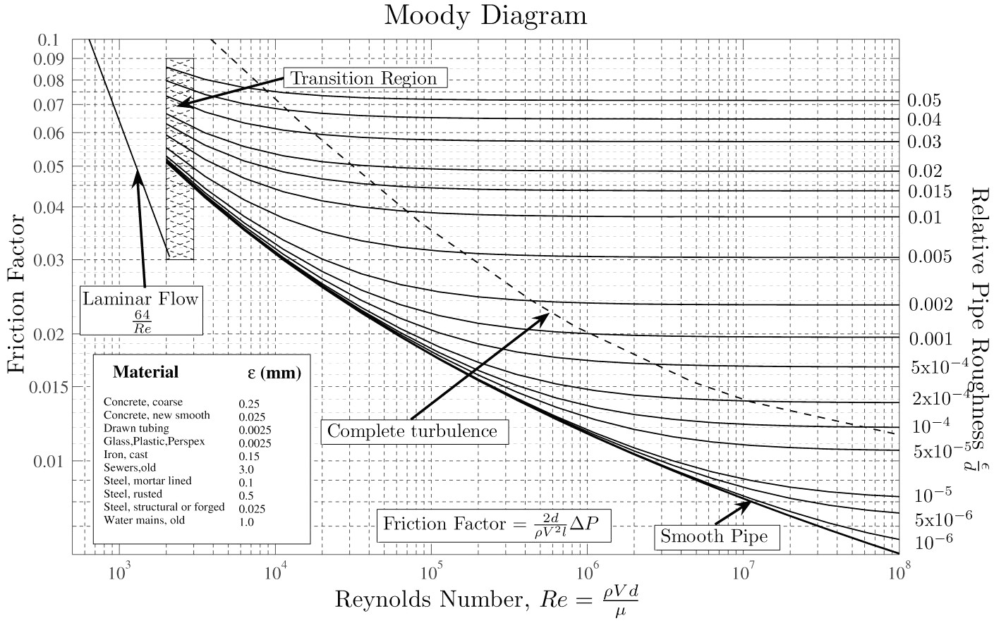

Some good reading on pressure drop for different sized piping with charts.
How to measure airflow in PVC piping requires careful measuring of airflow with a pitot tube or calibrtated anenometer to determine CFM
I am looking at difference in piping material and having a hard time locating equations for different materials. I think an interesting question is - does material make a difference in terms of flow (resistance to flow).
EDIT: Found it - the roughness coefficient. So pressure drops is calculated as the following:
Where f is the friction coefficient and it is directly proportional to pressure drop just like diameter (d) is.
However with laminar flow roughness has no effect.
With turbulent flow it does have an effect and here are some examples (no they don't have the materials that we generally use) of the friction factor. Our intakes do have turbulent flow, at 300 g/s we have a Reynolds number around 200 000.
