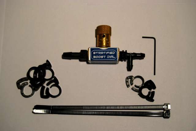

The Stratified Boost Dial
The Stratified Boost Dial allows you to tune ANY turbocharger in 2 port mode (bleed) and do all this with full load (or boost) based tuning. It allows you to keep the OEM 2 port (or get an aftermarket one if it's broken) while tuning your big turbo. Best of all, the load and boost dynamics tables can be left mostly untouched from factory settings!
Driveability and boost control are vastly improved, load by gear is back, and you maintain a constant load (torque) curve in all seasons making this type of control much more flexible than 3 port (interrupt) style. The Stratified Boost Dial was used to increase boost on the K04 as well as tune several large turbos including BNRs and GT series with both internal and external wastegates.
This closes the loop on boost control for the MazdaSpeed. You can now choose your tuning weapon and method. Whether it's 3 port, 2 port, boost targeting, or load targeting, we give you the capability to do all this at Stratified.
Setting this up is easy with a full set of clear instructions on our website and the full support and engineering behind Stratified products that you've come to know and expect.

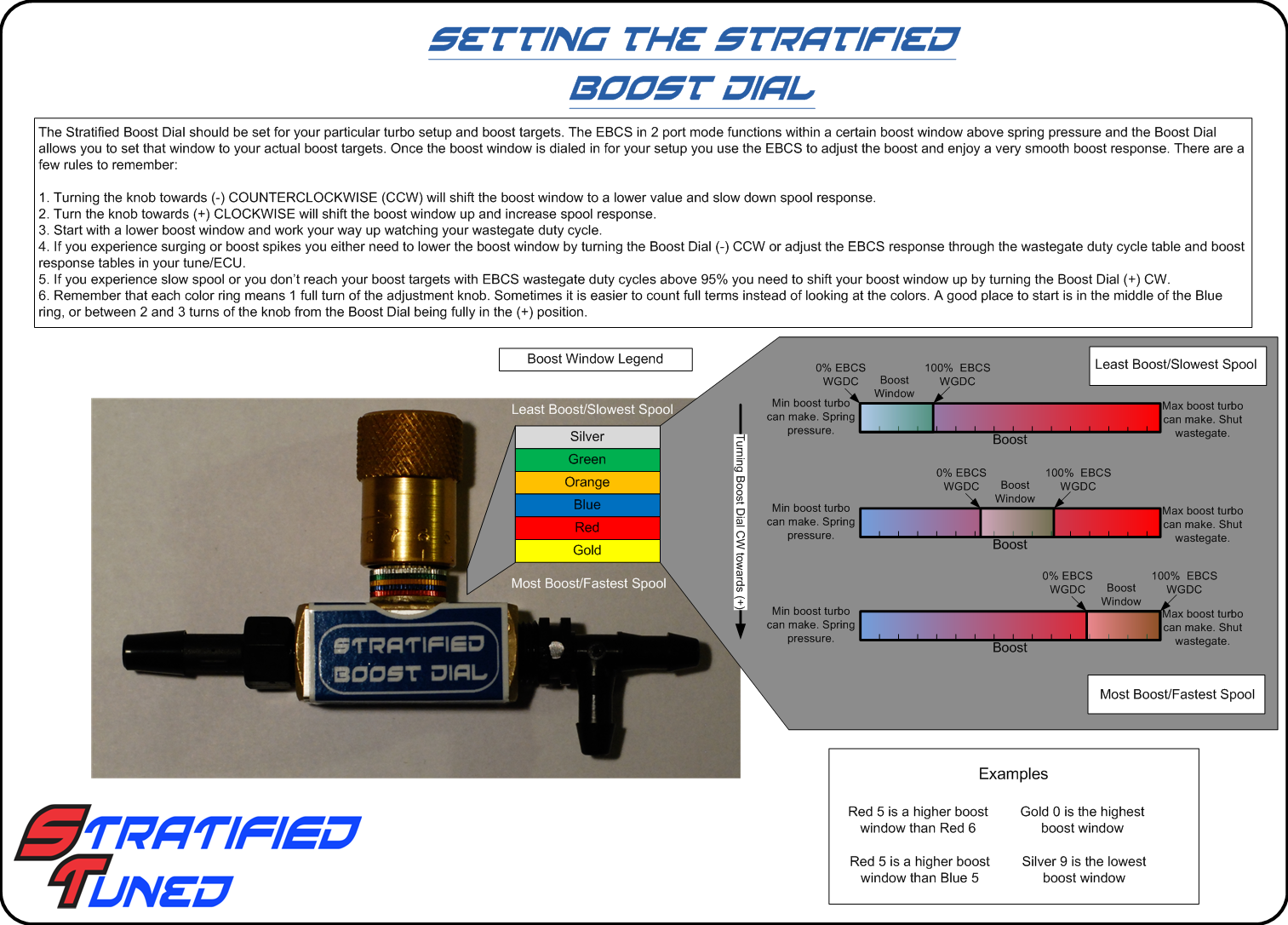

3. Do some driving and set your Boost Dial.
4. Set your load or boost targets and do some logging.
You know you have set your boost dial correctly if the logged wastegate duty cycle and boost curves look like this. Notice the quick ramp in boost and little to no oscillations of the boost or WGDC. The oscillations that are less than 1psi are not felt by the driver. Also notice that the WGDC is in the 80-95% range when reaching the maximum desired boost near redline.
If you've' turned the boost dial too far in the + direction then you will see oscillations like shown below. If you see this you need to turn the dial in the - direction.
If you have a slow boost rise and get to 100% WGDC without reaching your load or boost targets then the boost dial needs to be turned in the + direction more or the turbo is not able to reach those load/boost targets.
5. WIN! It's that easy. Have excellent boost control, great driveability, and no boost spikes with great spool and a tapering curve (as defined by your load targets)!

It is enabling the use of a bleed style boost control method (like OEM) by allowing you to adjust the flow from the boost source.
The solenoid in bleed mode can only bleed so much. It has to bleed enough to drop the pressure at the WG actuator in order to increase boost.
So the Boost Dial is a device you can tune to restrict flow into the WG actuator line so that the solenoid can keep up and effectively drop pressure at the wastegate line which then gives you control over boost.

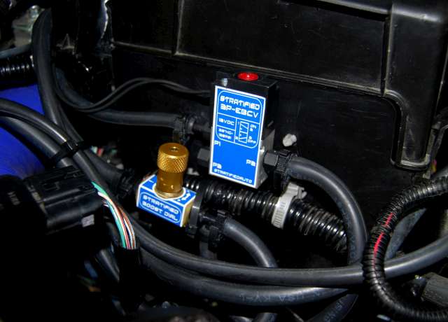

I got my BNR S3 turbo 7 months ago, and since I was very satisfied with Stratified tune on stock turbo my choice for BNR was of course again Stratified.
Everything was ready to go, I got 3BAR MAP sensor and Grimmspeed EBCS.
Car felt great on first two tune iterations when we were at low boost (~17PSI), but as soon as Lex started to raise load targets, we ran into some issues.
Car was hitting ~21-22PSI at whole RPM range as intended, but boost was oscillating badly.
It was something like 22-19-22-18-22-20PSI-etc and believe me it was no fun to drive car like that.
Lex was trying to tune out that issue, but it seems that my speed didn't like any solution.
Next step was to try only with Grimmspeed MBC. Oscillations were gone, but my boost curve was like on K04, at ~3k RPM we got 22PSI boost, and at redline it was ~18PSI.
So again, we didn't get what we were asking.
We were out of options, either I have boost or exhaust leak, or my speed just likes to be stubborn.
I did leak test, and nothing, everything was just fine.
Lex told me that he is developing some kind of valve(boost dial), which should solve this issues.
After few weeks of waiting, boost dial finally arrived. I installed it right away with new tune iteration which Lex sent me, and WOW what a difference.
Car felt as completely different car, so smooth acceleration, way better throttle response, load targets were spot on and no more oscillations!
I just can't believe what that little valve did to my car. I don't know how many guys have this issue, but I can tell you from my personal experience that this is working great.
Valve itself is very sturdy and bullet proof.
Installed pic:
