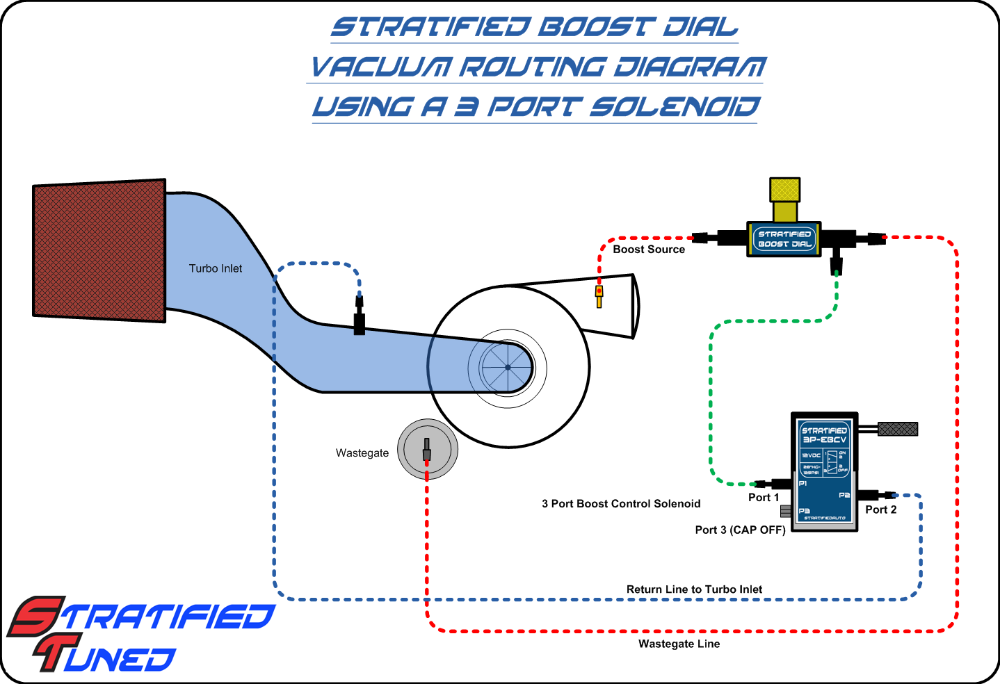

After a few weeks of waiting (especially for the German customs) I finally got my boost dial and now I have an installation question:
The 3rd ("middle") port of my GS is not connected to the wastegate, but to the boost source.
So, shall I "deactivate" the port which is now connected to the wastegate or the port "3" in your diagram, which (in my case) goes to the boost source? Actually I would plug the boost dial in the current connection line from the GS to the boost source and connect the tool to the wastegate, leaving the intake line as it is.
I'm a little bit confused...
So, shall I "deactivate" the port which is now connected to the wastegate or the port "3" in your diagram, which (in my case) goes to the boost source? Actually I would plug the boost dial in between the current connection line from the GS to the boost source and connect the tool to the wastegate, leaving the intake line as it is.
Check out our 3 port setup diagram:
http://www.stratifiedauto.com/images...203%20Port.png
 Old 07-23-2013, 02:02 PM   #149

I already studied this diagram - there is also a Grimmspeed example in this thread where the installation seems to be different from mine, too.
The basic question is: should I change/adjust my connections so that they are equal to the ones in your diagram or shall I leave everything as it is (because it works and cannot be totally wrong) and just put the boost dial in the boost source connection line and connect it to the wastegate afterwards, deactivating my current wg port? In principle this is what your diagram shows, although you are using other ebcs ports/port numbers.

This evening I wanted to test the boost dial, and...this was the "funniest" test drive ever!
Although I adjusted the boost dial to the red setting (at least for my last run), commanding up to 22 psi at wot (wgdc 60-80), I just reached ~14 psi maximum boost pressure!
Since there are no boost leaks, I was obviously wrong and have to correct my port settings...
But, can anyone explain why (in my case) in 3 port mode the port connections were ok and everything worked fine, but when switching to 2 port mode, I have to change them - probably to the ones on the boost dial diagram?!?

The connections should be as per the diagram whether it's a GS solenoid or a Stratified one. The port numbers are the same. Basically the 3 port is setup in "2 port mode" and it bleeds boost pressure away from the WG actuator line.

Finally I've found the reason for my confusion:
If you have a look at the "official" GS installation guide: https://www.grimmspeed.com/install_g...MazdaSpeed.pdf
you can see that the connections for the GS running in 2 port mode are totally different from those for the 3 port mode!
In any case, the boost dial diagram shows the correct settings, which I will test tomorrow ;-)
BTW: The diagram from SarcasticOne on page 3 of this thread shows the correct settings for a GS using the boost dial.

This is why I made those diagrams, to remove any confusion. The port numbers for our solenoid, COBB, GS, are all the same so just follow our diagram and the same port numbers if you have a different solenoid.
