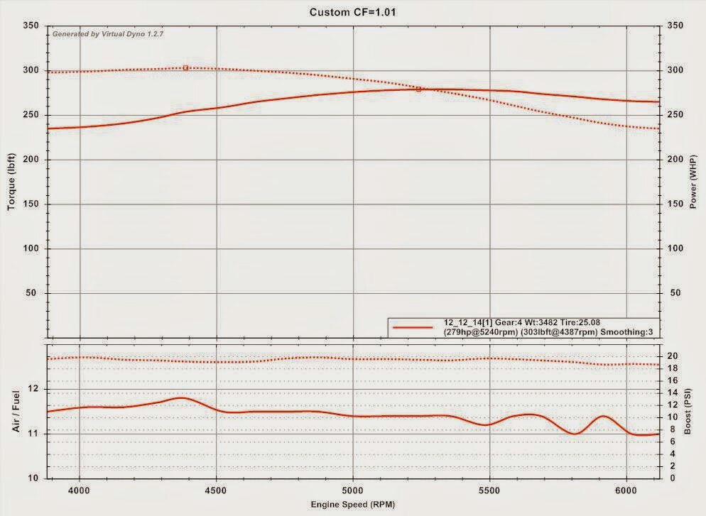

Figured I would post mine up.
Mods are in sig.
2013 Mazdaspeed 3 VRM

Thanks for sharing. Try starting the pull a little earlier - right at 3000 RPM. You will get a better curve and more torque.

I think I just fail at virtual dyno because the log for it starts at 2800 rpm.
BTW is boost supposed to taper? I'm seeing 18 pushing close to 19 at over 6k.

This depends on your car. The tune is targeting load (airflow) rather than boost. Up top it will try and hold as much boost as it can to get to the load targets.
Some cars are able to hold boost better than others.
