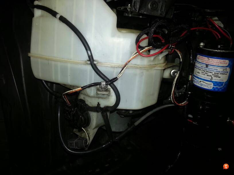

Default Stratified Meth kit install using stock washer reservoir
I've just done an install on our ST and applied another method for tapping the tank.
I made a 1/4 hole at the very top and fed in a WMI hose all the way to the bottom of the tank. I used rubber over top of the hard WMI tubing as a stopper to make sure it stays in place but with a 1/4" hole it should fit WMI tubing very snugly.
This can help out the gen2 guys that have the more complicated setup.ImageUploadedByTapatalk1414127294.903331.jpg

So I've had my DO MAF kit installed now for about two weeks, and I've got a canadian washer tank coming in so I can have more capacity and wire up the low level light to my controller. I have a question though, could I just unplug the fluid line supplying the rear window sprayer, cap it off, then hook up the front windshield washer supply line to the pump that was originally supplying the rear window? That would leave the pump at the bottom (the one that originally supplied the windshield) open to use as my supply to my pump?

@Lex; any input on my last post?
09 MGM MS3
 Old 11-12-2014, 08:19 AM   #189
Thought I replied - weird. Yes this should be fine.
