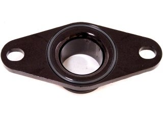

I don't think these are the ones.. i need the one which goes between the flange and the TMIC, eg this one: https://frsport.com/images/product_i...FS01-02@2x.jpg

Is that really the size? I'm talking about the one BETWEEN the tmic and the flange, which sits in the groove as per my picture?

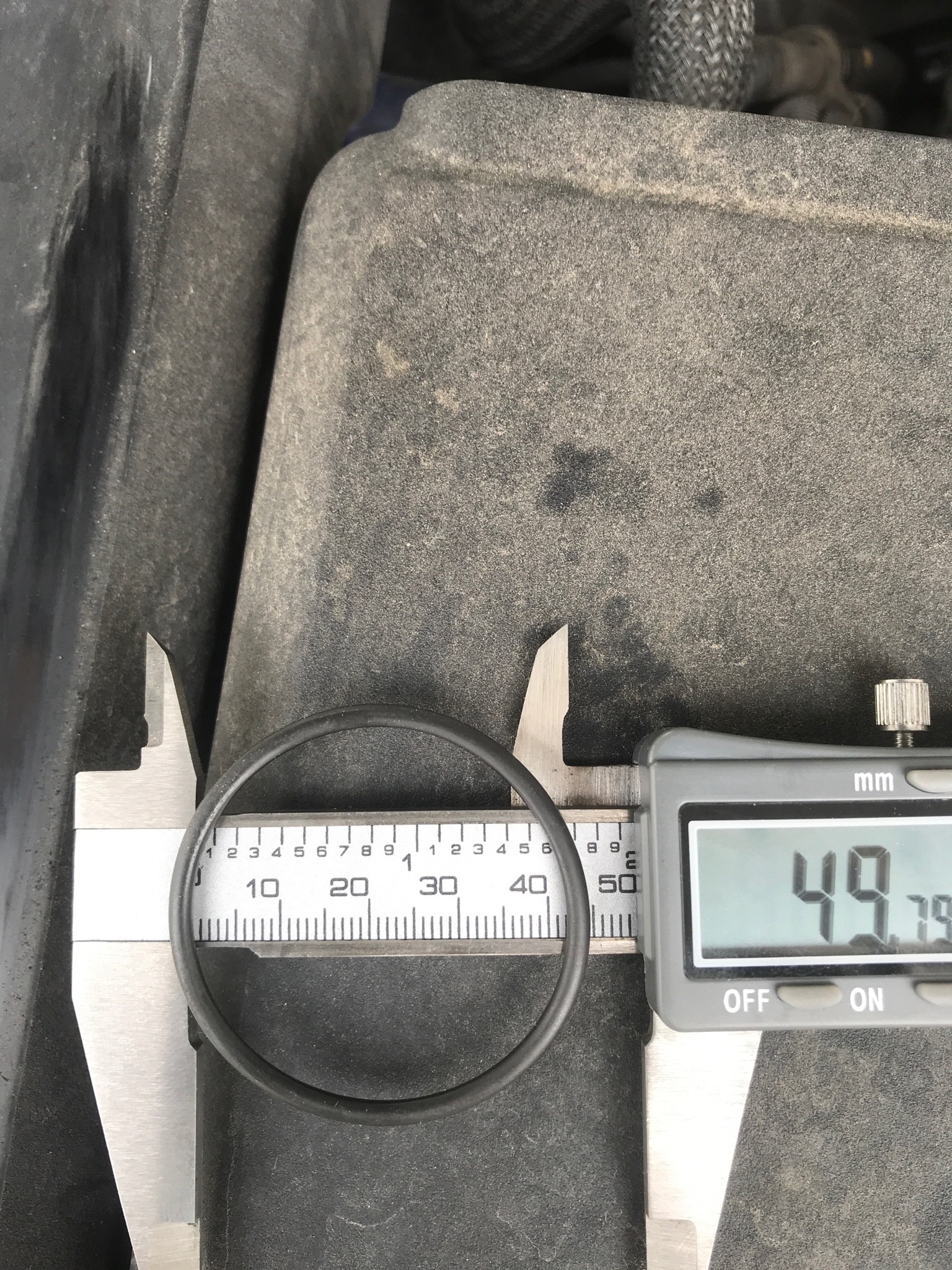

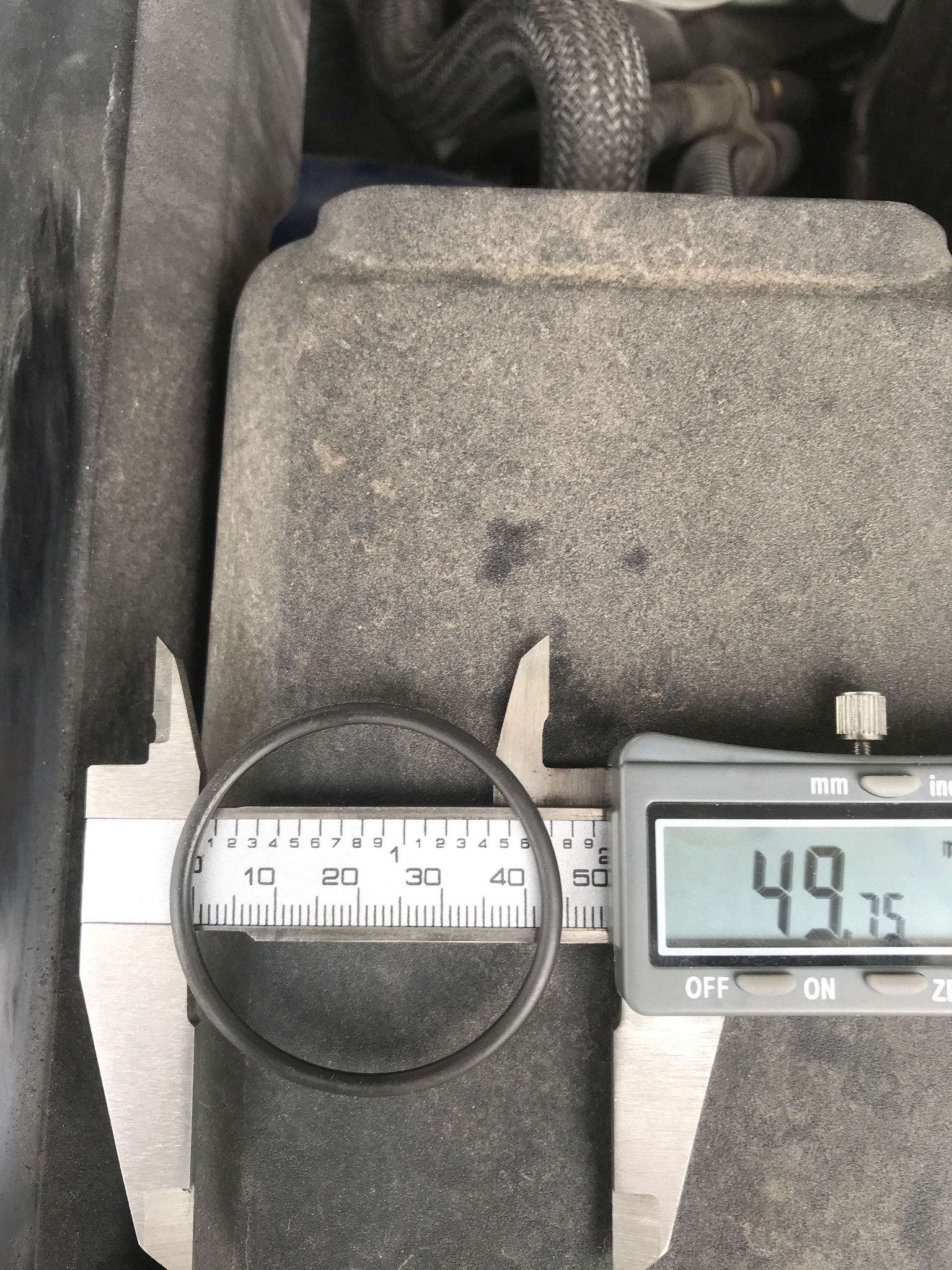

Awesome! can you please measure internal diameter for me? As it seems that the ID is being used when sizing o-rings. Also, 2mm seems kinda slim, the groove in the flange is kinda deep, i'm not sure if 2mm is gonna seal it..

Best I could do, sorry
so... here is the thing... after taking it off (the engine was warm) the o-ring expanded and I was not able to get it back into the flange.. it is in the freezer now but I think my initial 40mm is correct (it was cold and went back in just fine).

after sitting in the freezer.. it was back down to 40mm and it fit (is installed once more)...
