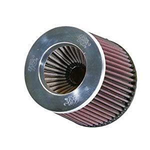

The only thing I would change about it would be:
1.) Open filter - looks like this:
On the k&n kit I got, the top is closed, so it can only draw in air around the outside.
2.) Air straightener
I'm actually going to pick up an air straightener from haltech once he sends me the measurement for it, so I can let you know how that goes.
If there were the same price, I would be tempted by the heat shield, but would probably go with one of the other options in the end. But, like I said - If I was doing it all over again, I would just go ahead and get a 3" I.D. MAF housing and a k&n conical filter, along with a 45 degree coupler/reducer so I could use the stock TIP.
The corksport kit is great, but I like an oiled filter because oil carries with it a slight positive charge, so it can trap more particulate matter with the same porosity as a dry flow filter. If you don't overdo it with the oil, it really shouldn't get onto the MAF. Most people like dry-flow just to be safe though.
