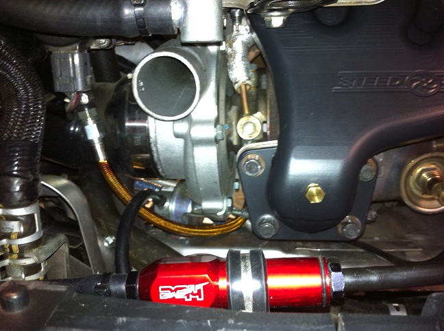

ok next on the list is boost control..... from what i have seen no one with a BT can control boost with oem bc... so I went ahead and bought a hallman pro rx mbc... it comes with a soft fine tuning spring up to 5lbs fine tuning over wg spring pressure.... and a stiffer less fine tuning spring to crank it up to the sky...
heres the hardware... in cobb blue (sort of)
ok... so here is a shot of the wga... and its adjustable rod... (i believe this turbo comes with a 12-14lbs wg spring.) i set it to the lower end... because if i adjust too much preload the flapper will bind if it ever needs to be extended to 90 degrees from being shut.\
here is also a shot of the rear coolant line provided by ATP....
and this is how it will be routed once in car....the rear one goes over the turbo

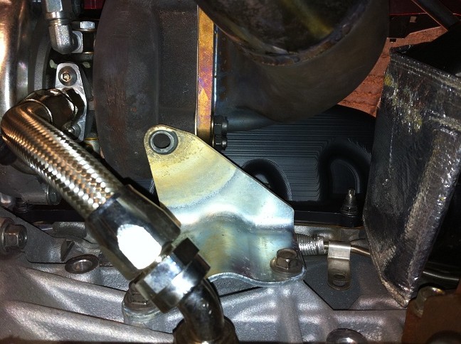

now one thing we discussed in length is supporting the turbo from underneath. stock the turbo has only 2 solid support anchors... the ex manifold....(top) and the turbo bracket (bottom) .... the dp doesnt really support it since it is only helt to the body by the hangers holding the exhaust pipes.
so....

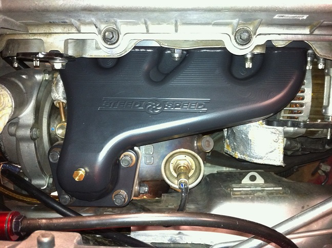

i ordered some thermo tech header wrap....
i also bought from siliconeintakes.com a 90 degree reducer from 2.50 to 2.0 and also a metal insert and finally a straight coupler....
all this will be used because the snout of the turbo (3071r) is actually shorter than the ko4...and the regular coupler i use with my cobb fmic kit simply wont reach.
heres the hardware i bought.....
put together to show u how much longer it can reach
so back to the bracket....
i bought a second bracket to fuck with......
so first thing ill do is notch that section i used a marker on.... this will give me a way to wrap the header wrap around the edge where the bracket will contact the turbo... and provide both support and NOT transmit vibrations....
ill wrap it around here once or two times around....
i also bought some high heat ties....to be able to secure the wrap nicely so it doesnt walk around on me

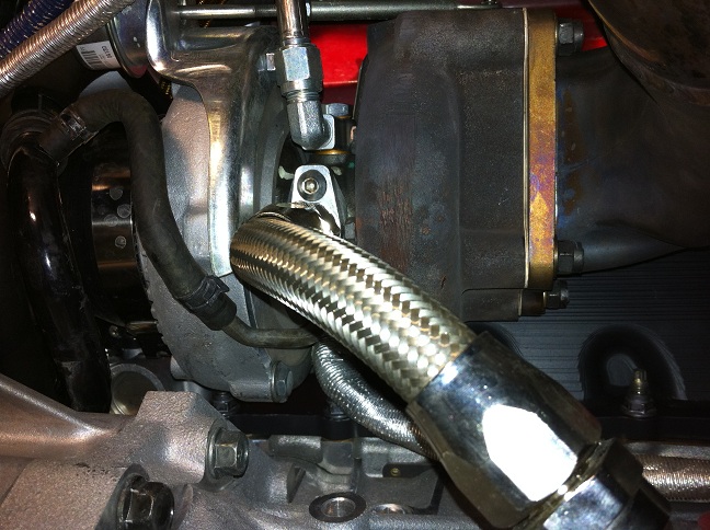

so now for the front coolant line that requires u to bend the oem one to clear the larger compressor.... i had bought a banjo and high temp hose to use instead....
wasnt very happy to see how close the hose comes to the turbine housing....
so we ll get back to solving this in a bit.
now back to the other thing we have to modify on the turbo bracket....
the 3071r has a much larger turbine housing than the ko4.... so the bracket will interfere with the fit unless it sits lower.....
one way i was considering was to bend it to accommodate.... but instead it was suggested to me i slot drill the holes that go towards the block on the bracket so i can adjust the height of it at will.
and heres a pic of the proposed slotting... marked with a marker.
now that we r done with that...lets finish up that front coolant line....
bought a banjo with 6 -an fitting.... 2ft steel braided hose with one end 90 degree -6an fitting and one with a straight -6am fitting..female both.
also as a last touch i bought a -6an fitting to add to the line...and the other end with a barbed ending to attach to oem hose.
heres all 3 lines now attached to the turbo...(only one being re used is the oem oil feed line from the top)
anyways.... feel free to ask questions and discuss.... i know we have been talking about this for a while.....but im doing this really for the guys that one day might be encouraged by these pics and words.
this was easier than i thought lol

FWIW I just remembered this from my install.
you will likely need to cut the oil return line. Mine was like 2" too long and there was no way to route it to connect back to the block. If you have ever tried to cut steel braided line without the proper tool...well it sucks!
I duct taped the fuck out of mine where I was going to make the cut, and hacked away with a brand new hack saw blade and it actually turned out good. The hard part is getting the SS line back into the fitting and screwed back down.

well I do over look simple things sometimes but i don't think so.
you have to come off the turbo with the straight connector and use the 45* or whatever it is to get you to the block. if I tied mine up like a pretzel maybe. Go try to flex that hose...it doesn't move much.
Like this:
(oh and notice my "modified" OEM water outlet
oh and my ghetto bracket:
Like this:
oh shit dano..i see steedpseed???

you have a keen eye there lenny..
I told you i'd snap some pics when I did the swap and those are just a couple.
I'll put a thread together soon with all the pics.
teasers
Hallman Pro EVO in the foreground
teasers
That is all.
