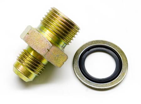

On the turbo side, you will now need a fitting with a male end that will thread into the turbo, and a male end that will connect to the other end of this 4an braided line. Very Important: If you're using a BALL BEARING TURBO (just as the stock turbo is) you need a restrictor in your oil feed line! You will drown the turbo with oil which will cause it to fail. The stock oil feed line provides a restrictor in the second banjo fitting/bolt that bolts to the stock turbo, the curvy end, so be sure to keep the two bolts straight after uninstall.
***IF using a Garrett Ball Bearing Turbo (gt28, gt30, gt35, gt40, etc) the oil restrictor is actually built into the cartridge, so no need to worry about this.
Most commonly, the stock turbo side will be m12x1.5pitch female thread, so you will need to adapt male-male. This is what Garret/Precision uses for their turbos for the most part.
Ball Bearing Turbos : Must have 0.035" hole size (~1/32")
Journal Bearing Turbos: NO oil restrictor
ATP Part Number: ATP-OIL-021]

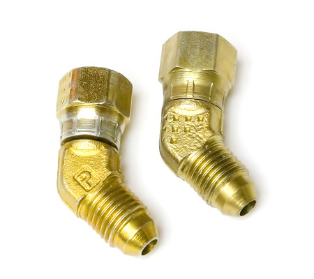

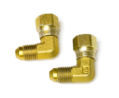

If you cannot achieve a good angle on the oil feed line on the turbo side without damaging the SS line, 4an female-male fittings can be found in 45* and 90*. If using a ball bearing turbo though, remember to retain the fitting posted above so that you have the restrictor in place. The 4an female-male fitting will be used BEFORE the restrictor, between the hose and restrictor fitting.
[ATP Part Number: ATP-FTG-017]
[ATP Part Number: ATP-FTG-016]

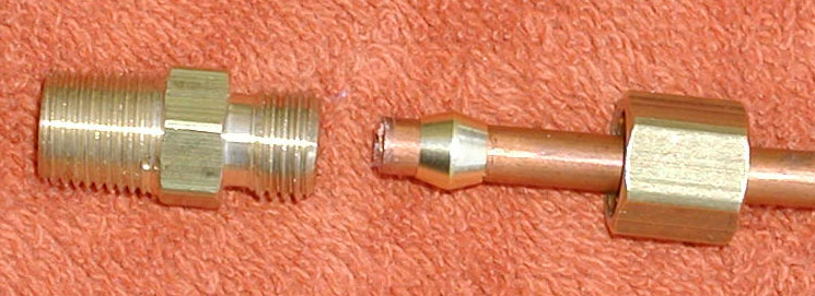

the oil feed line can be done much easier, simply cut off the banjo bolt from the stock feed line and use a compression fitting. Here's an example of what it should look like except the male piece should be an elbow.
http://www.scary-terry.com/ggshooter/comp_fitting.jpg
