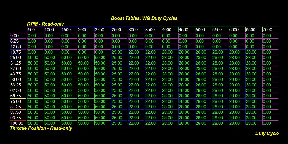

So I have been load tuning for a year or so now and can tell you from experience it would take me about 20 map revisions after a major hardware change [Turbo, IC, EM, etc] to get my map dialed back in. About two days ago I thought I’d try my hand at Boost Tuning and I have to say the experience has been pleasant. It took me 5, yes 5 map revisions to get my boost dialed in to exactly where I wanted it. Some of those revisions were to increase boost after I got the base map laid down so really just 2 or 3 revs to get WGDC and Boot Targets dialed in. Wow!!! Me likes!
So all I did was take my existing Load Tuning based map, set my WGDC values to 20, set my Boost Targets to a conservative 18PSI and flip the toggle in ATR. Oh and for good measure I copied in Christian’s WGDC IAT comp table he created for this to help combat possible load fluxuations caused by temp changes throughout the year. Time will tell how this table reacts.
So in the very first log I hit my early lower RPM boost targets but couldn’t quite reach target in the upper RPMs. Well all this was expected so I looked at my logged WGDC values and made map changes to match what was being logged. Some say the table value = 2x + 20 but in my experience it is more like 2x +10. Then you get the Boost Dynamics/Load Dynamics values multiplied in and the final result is reached. I am not 100% sure about this logic but it seems to work and I spent hours and hours on my Load Dynamics tables dialing in my GT28 and that is my conclusion.
Anyway the results came very easy and very fast and I have attached my current map and logs as examples of how to get started. My goal over the next few weeks will be to see if I can get the Boost Comp xGear tables to limit boost per gear. After looking at them I don’t quite understand how they would work but I’ll give it a go.
If anyone knows what the A & B are for I would love to know. I could assume A would be normal operation and B would be DSC active but who knows.
Stay tuned for updates!
for the MS6 guys. below are my BT and WGDC table values to match up with the logs. Again, the reason I started this thread was to try and illistrate how easy the new Boost Targeting logic is vs. the Load Targeting logic. Did I say 5 maps to completion?
