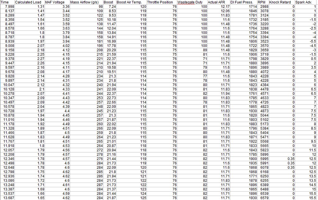

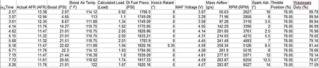

I made some changes to my current map this week and have made a couple pulls. I was running 11.6AFR and I just moved it to 11.8AFR. Besides that, I also made some slight timing adjustments, however these arn't a knock problem at all right now so I know I have some room to play with still.
Anyway - my logs from the other day were taken right after I flashed the map and driving a few minutes. The AFR was around 11.6:1 with a few points where it dropped below one point lower than normal (more than 0.12 away from target)...
Here is a log from this morning (cooler air than when MAF was cal'd). My AFR tapers down at 6k but until then should be 11.8. I see some little fluctuations that I've never had before. It's not bad, however the car was running much more consistant when it was still 11.6.... I am having trouble hitting and holding this AFR.
Any suggestions? Should I do yet another MAF calibration? Or does my slightly advanced timing have an effect on AFR-out?
EDIT: I'm also adding a log from yesterday which was right after I flashed the map - here is is clear that then AFR is not meeting its 11.8:1 target.

I also meant to ask. How do you increase your mass air flow by increasing your ignition timing (or leaning your mixture, etc)? I know this quote mentions meth but I heard it mentioned also when talking only about advanced ignition timing.
MAF = mass AIR flow in gram/sec .... the cam timing is not changing so starting the ignition sooner can increase air flow how? The ignition is only effective around the compression/combustion stroke where the valves are closed....

Tuning timing based on MAF flow is certainly not ideal, but you can see subtle changes because earlier spark reduces the pressure/temperature in the exhaust manifold resulting in slightly better VE since you won't get as much blowback in the valve overlap.

Gents,
Attached is a datalog showing the effect of the TRL X Gear tables on my boost tuned Gen1. I am using the most up-to-date firmware, ATR and maps.
I am commanding a maximum of 2.2 calculated load. When calculated load goes above 2.25 (2.2 + .05 error the ECU allows), the throttle plate does indeed close off to limit boost and bring caculated load back in line.
EDIT: I haven't zeroed out the reductive portion of the load error table as I want the TRL X Gear tables to manage torque in the low to mid range.
EDIT x2: Essentially I am using the load tables to set a maximum load the engine will achieve. If calculated load undershoots the TRL X gear values, the ECU will do nothing. I guess you can say I'm running a hybrid load/boost tune.

Rob, I'm thinking a .5 drop in AFR is really tough to maintain unless you're spraying a whole lot of meth (close to 100% mixture and a large nozzle). I have yet to achieve that, at least. Here's some empirical evidence:
Pull 1
Meth Mix: 75% Meth/25% Distilled Water
Flow: 12GPH (D12 nozzle equivalent) - Direct Port
Note: BATs do not change due to direct port setup.
Controller: MAP Based. Start spray at 5PSI - Full spray at 20PSI.
Targeted AFRs: 11.8
If you look at AFRs, the measurable effects disappear by ~5500RPM (ignore the richer blip just after 5500RPM, that was due to the .35 KR -> I didn't upgrade my AP at his point for faster logging). By redline, there is no difference in AFR.
Pull 2
Meth Mix: Blue WWF. 30-40% meth.
Targeted AFRs: 11.8
With this setup (less meth concentration), the effects on AFRs disappears by ~3800RPMs.
This does prove that higher meth concentrations make a more pronounced and prolonged effect on AFRs. With 100% meth, I'm sure the effects will be even greater. Still though, .5 richer to redline will be tough IMO.
