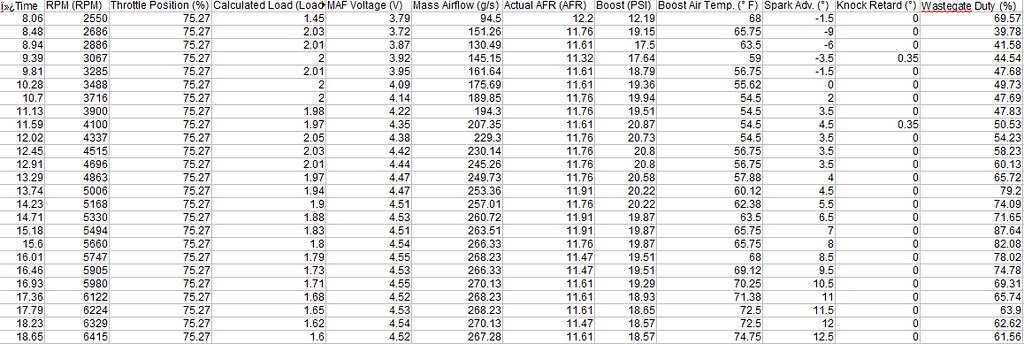

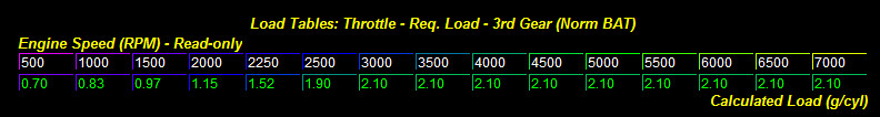

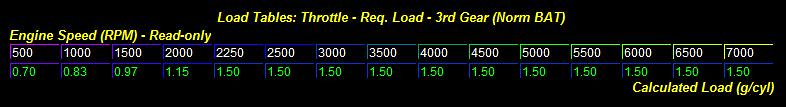

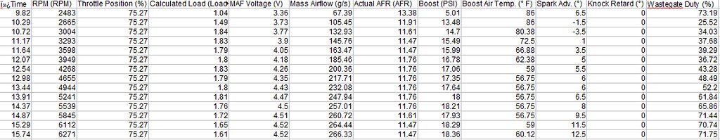

There was some discussion around the TRL X Gear Tables being active when using boost based tuning. By the looks of it, the TRL X Gear Tables are active in some MS3s and not in others. It is not yet known as to why this inconsistency exists.
At any rate, I did some sensitivity testing on my '07 and found that the TRL X Gear Tables do affect the behaviour of the (my) engine. My findings are quoted below from another thread.
It stopped raining tonight so I took the car out for a datalog run.
Test Conditions
- 3 degress celcius
- Meth on
- 3rd gear
Low Load Targets
Corresponding Datalog
High Load Targets
Looks like in some instances, the TRL X Gear Tables do in fact materially affect Calculated Load by primarily modulating boost.
EDIT: I believe the low load datalog was completed faster than the high load datalog because the low load datalog was done on a downhill on-ramp merging onto the highway (10 degree downward slope or so).
Cheers,
Dave

well ive been sitting here all day being bored as shit so i decided to tweak my WGDC/Boost dynamics/Boost Targets and i did a little timing tweak.
And what can i say, I think it worked extremely well.
I only lowered my Boost targets by .25 from 5500rpm and up
I lowered my WGDC tables by 5* from 6000rpm up.
I also made my boost dynamics table look the same as finkles.
attached are screen shots of my tables and a 4th gear log.
How u like me now?
Ambient temp according to my car was 74 degrees.
Edit: After looking at my log again im maxing out my WGDC @ 94.01, I actually think i might be able to put my boost targets back up .25 from 5500rpm and up and still be under that 99% WGDC, thoughts?
