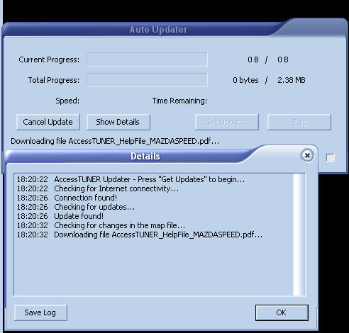

What version is the new version?
I ran the update last night around 12am and I'm now on 1.8.6.0 build 854
I don't see any Ignition tables called Max anything...? I see 9 Ignition tables.. am I looking in the wrong spot?
Edit - Just tried the updater again and it says no updates...

you updater = Fail
current version: 1.8.6.0-867
Dano is offline

you updater = Fail
WTF! FML!
Christian, another bug to fix please!
EDIT - I unchecked the "Beta Software" check box and now it's updating.... Not sure if that's the intended behavior...

try closeing ATR and try again?

WTF! FML!
That is the intended behavior. ATR software is different than AP firmware. The firmware is still in Beta. The ATR software automatically updates or you can roll it back...no Beta option there.

you updater = Fail
No, things are working as expected. ATR software and AP firmware are two different things that are updated separately.
You are welcome to review our release notes here.

Christian FWIW,
as far as your updater programming. If you select to allow for beta updates the program should check for general + beta and not exclude general when you have beta checked.
ya know a cumulative result not an either or.

Christian FWIW,
Understood, but we don't want it to work that way so we can toggle between the two and help users in a bind.

very well...I see this causing confusion though...leave beta checked and users will not recieve general auto updates...Hnda is a perfect example.
perhaps have the software, after checking for a beta update, auto toggle back so it doesn't check for beta until the user selects it again?
Beta AP firmware updates usually contain the general updates + Beta stuff.
Some of the ATR tables are in Beta, but the software has been stable for some time. Although, we may still call it Beta just to absolve us of any unknown mistake that we may make. This is a pretty common practice now. I would make sure that the Beta Software box is unchecked unless you are instructed by one of our technical support team members to check this box. This function is only to be used for advanced technical support needs. We do not use this box for anything that is to be released to the general public. I believe the default installation has this box unchecked and it should be left that way unless instructed by a technical support member otherwise.

I've tried half a dozen times in the last several hours and always the same result. Am I missing a step? It's now 19:00.
I've reported this to our engineering team...I've never seen this before. I doubt that we will be able to look into this tonight. Until then, I've hosted the latest MS Tuning Guide and Tuning Guide Worksheets here.

That thread is showing last update on 12/02, and the help file I have I downloaded 12/03 and it includes the new stuff, so I'm assuming that's up to date? I dropped it in the ATR folder so I could access it from ATR - i.e. I don't know how it checks for updates to the help file, but it seems it may be wrong in this case.
I did the same and also received the update. The new version I got matched the 1.10 I had tossed in, but didnt confirm file sizes or anything. It's likely just a simple date check though and the downloaded one had the date of your download..
Edit: It actually appears to simply look for new unseen items from the server.. it ignores the local files completely in my tests.
That makes sense, it would be the easiest for them.
I got it to work - it was my AV (Avira.) Wasted time trying to find the problem, but the newest bad file I found was from 12/04. If it matters to anyone, disabling the web guard didn't help, had to disable all of it, then the update zipped right in.
