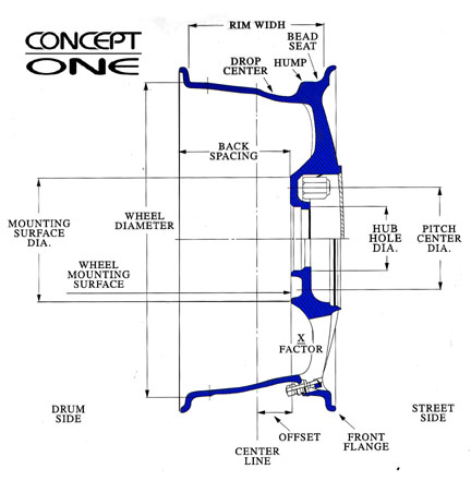

Wheel/Fitment Terminology
Offset - "The offset of a wheel is the distance from its hub mounting surface to the centerline of the wheel." - TireRack.com
Camber - "Camber is the tilting of the wheels from the vertical when viewed from the front of the vehicle." - Wheel Camber Explained
How to Read Tire Sizes
Calculating tire Dimensions
http://www.conceptonewheels.com/images/anatomy.jpg
